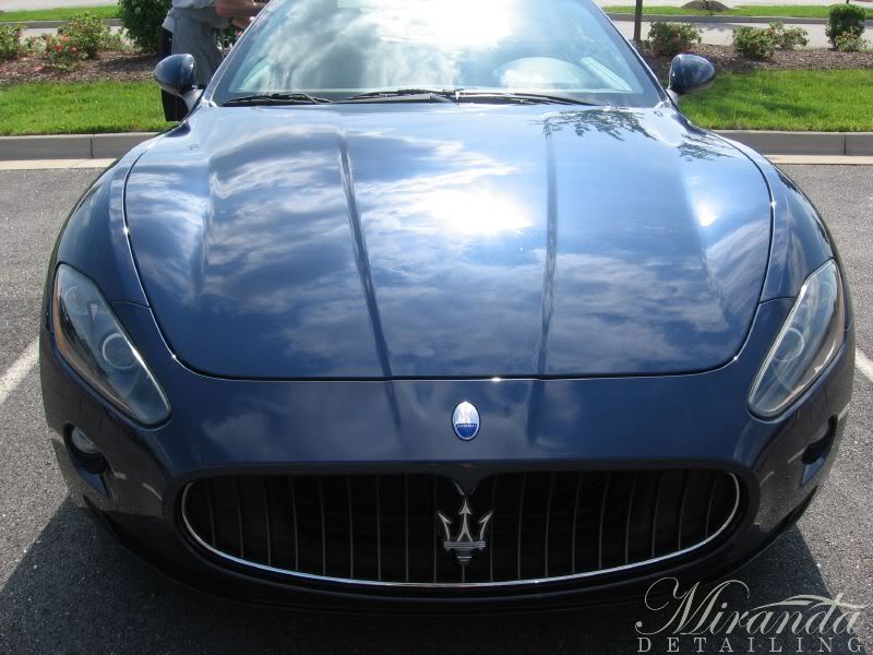

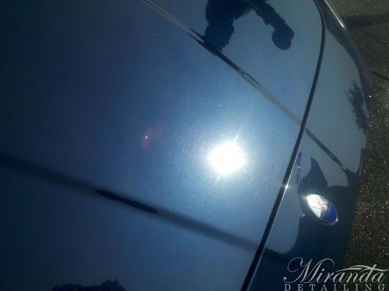

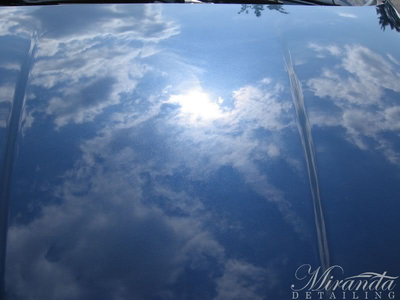

This is basically our first Paint Correction job.
This client owns a 2009 Maserati Granturismo Dark Metallic Blue. He called us about a month ago, searching for someone who knows how to care for his car.
Paint had some minor swirls from regular washing. He wanted it polished to remove the swirls and maintained every two weeks. Needless to say, it came out "fantastic", his words.
Wash:Foam bath using AM Wash/Wax+Lambs wool mitt
Clay: Meguiar's Mild Clay/Last Touch
Compound: Meguiar's D300/MF Compounding Pads
Polish/Wax: Meguiar's D301/MF Finishing Pads
Used our PCXP with the 5in Megs backing plate.
We removed about 90% of the swirls, I was amazed how well the MF/DA works. After emailing Nick from Nick's Custom Detailing about how to handle the Maserati's paint, we put took his advice and the D300 worked wonders. The paint was very easy to correct.
Before
Before
After
After
After
After
I was happy with the results. Now we are going to maintain the finish every two weeks, Crazy Excited!!
