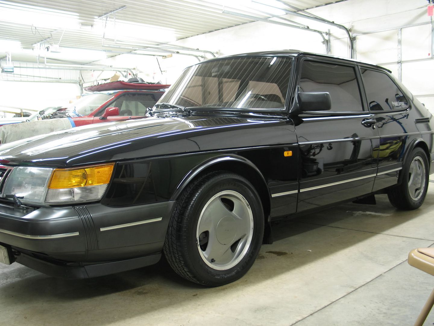

1993 Saab 900 Turbo CE #86 or 325
Pre-wash
(lens cap in the way)
Process
Wheels cleaned with Eagle One Wheel Cleaner and Schmitt
Liners cleaned with brushes and Megs APC cut 4:1
Wash car using Meguiars Gold Class Shampoo and conditioner, Chenille MF Mit
Dry using forced air and The Absorber
Clayed using Meguiars Professional Mirror Glaze Mild (the blue stuff) using Megs QD as a lub3
Pulled out for pictures/inspection
Time for some halogens

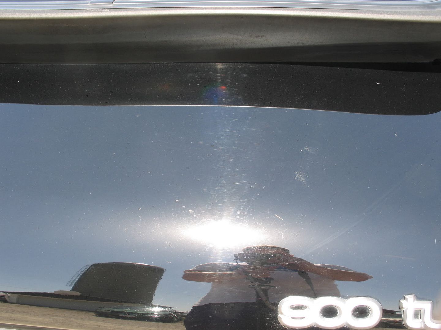

Tape off for 50/50

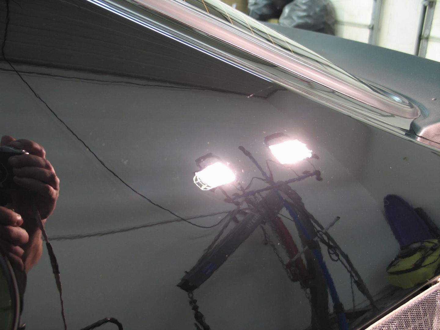

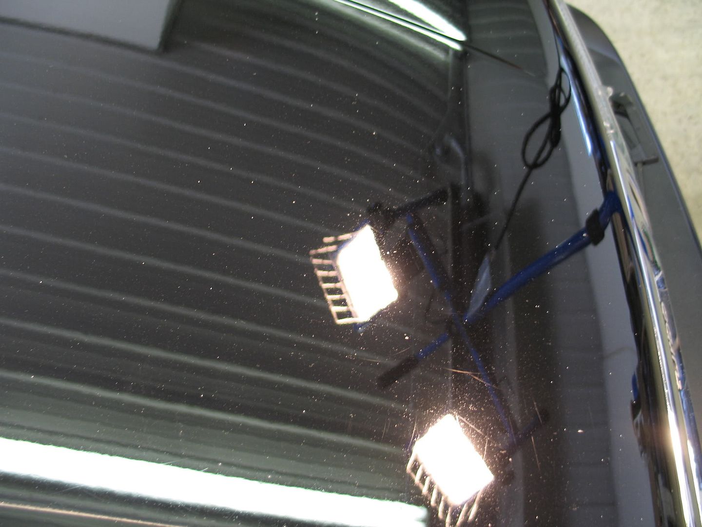

Again... this is just after wool. No polish
Both sides done. Car has a lot of chips

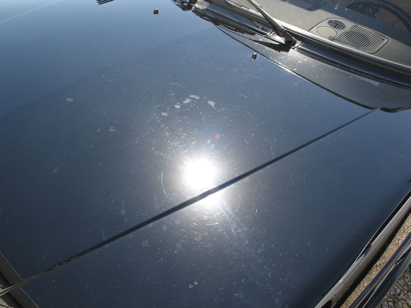

There were a few areas that needed wetsanding (because of bird-dropping etching). However, since i didn't have any paper those will have to wait for another day
Ew.

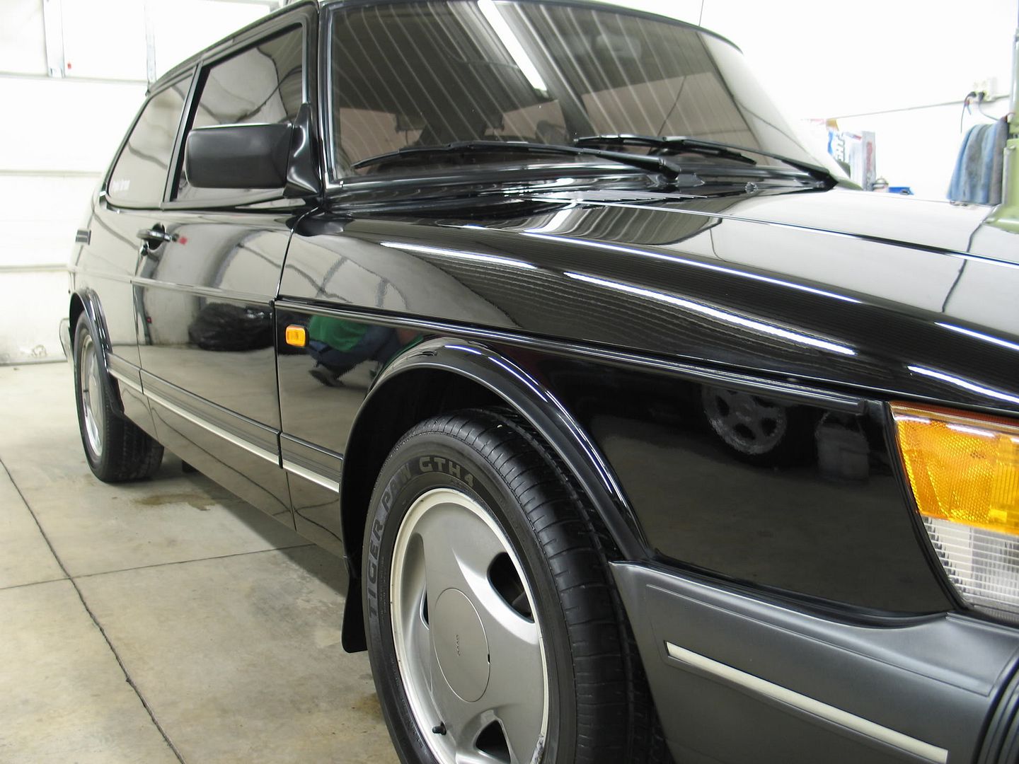

Now, that's better

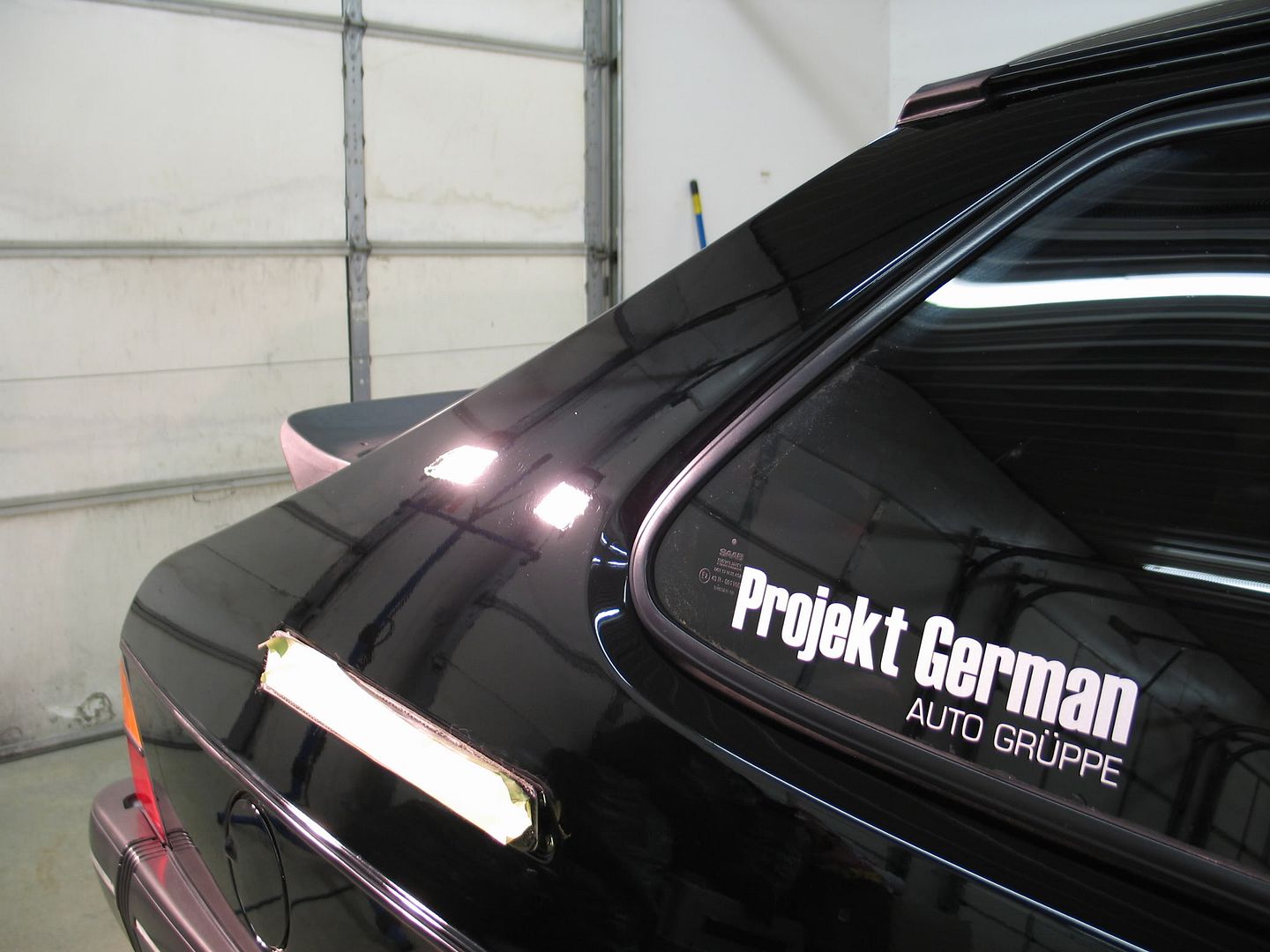

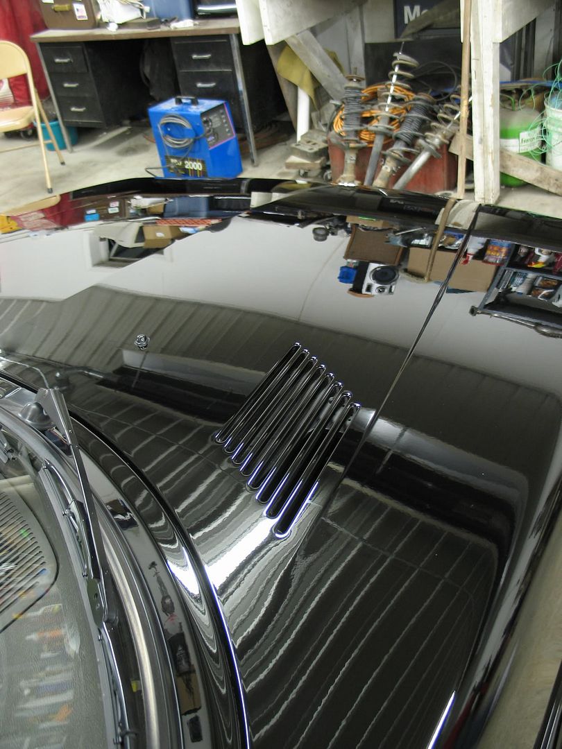

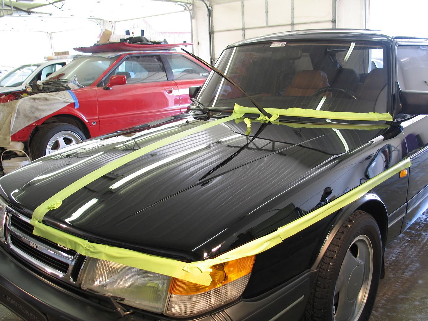

This car happens to have single stage paint. It also happens to have a lot of trim work all over the car which prohibited me from using a rotary on most of it (because I don't have small enough pads for the 9227)
Hood, Roof, Trunk, A-Pillars
Tape-off with 3M green
W-4000 Meguiars Woolie, Meguiars #85 Diamond Cut Compound 2.0 1500-2100 RPM
Lake Country CCS White Pad, Menzerna Intensive Polish 1500-2100 RPM
3M Ultrafina Blue Pad, 3m Ultrafina Polish, 1200-1800 RPM
Pinnacle Souveran Paste Wax

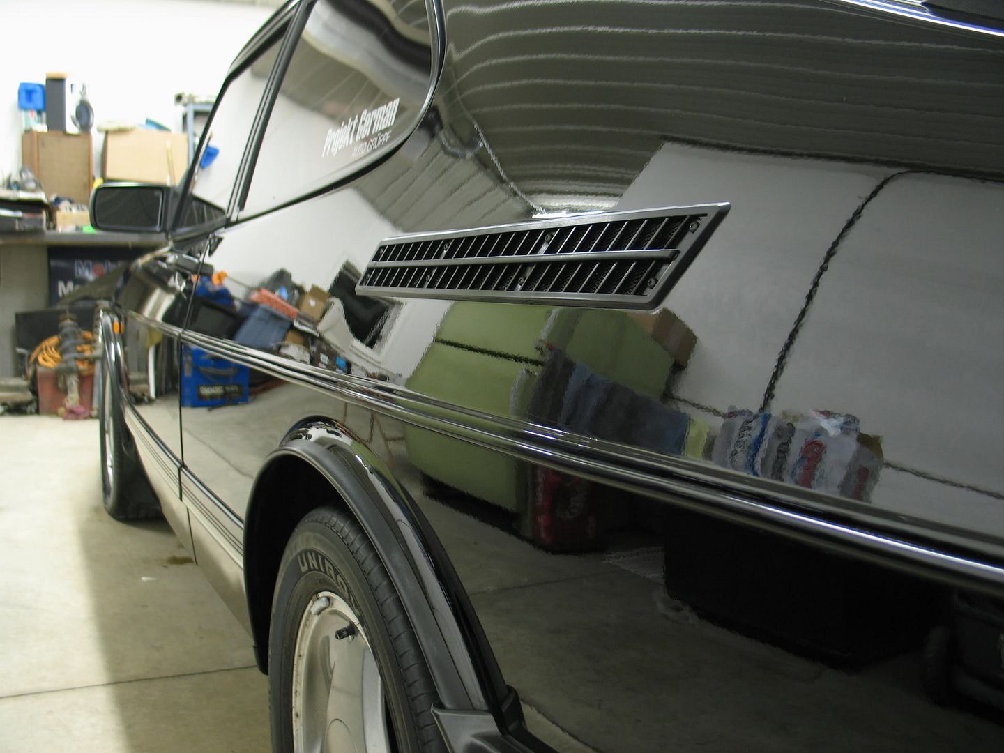

Rest of the vehicle
Pinnacle XMT#3 with PC7424 (lots of pressure) on Lake Country CCS Orange pad at speed 6 (6,000 OPM)
Menzerna Final Polish on Grey Lake Country CCS pad at speed 5
Tires dressed with Meguiars Endurance Tire Shine
Liners and Trim with Meguiars Trim Detailer Cleaner and Protectant
Windows with Stoner Invisible Glass
Wizards Black Renew on rear spoiler
Enjoy....I get some pictures in the sun tomorrow

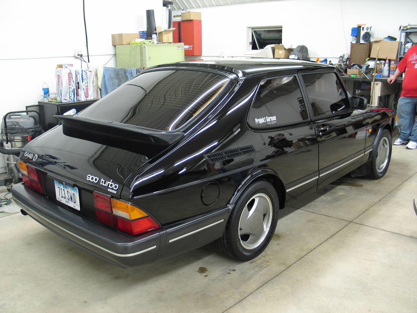

Exterior shots from today. It's really kinda crappy weather here
Interior coming soon. This car is sqeaky clean for a 1993... only has 61k on the clock as well
