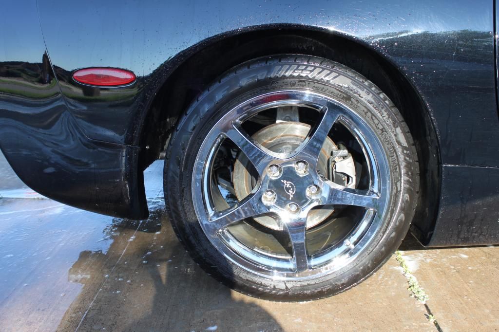

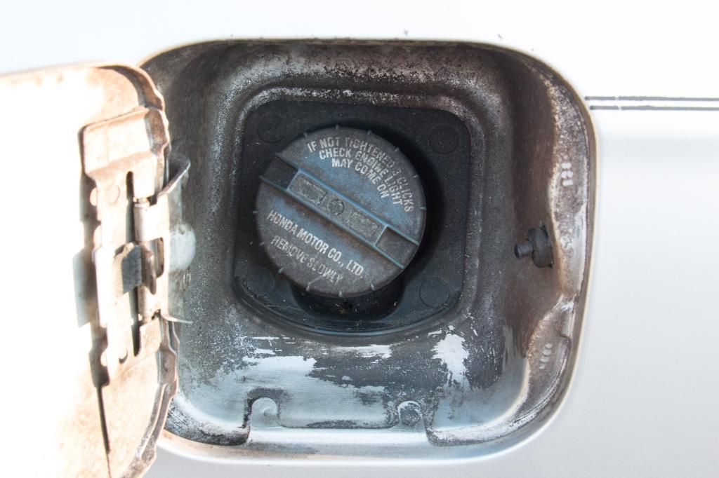

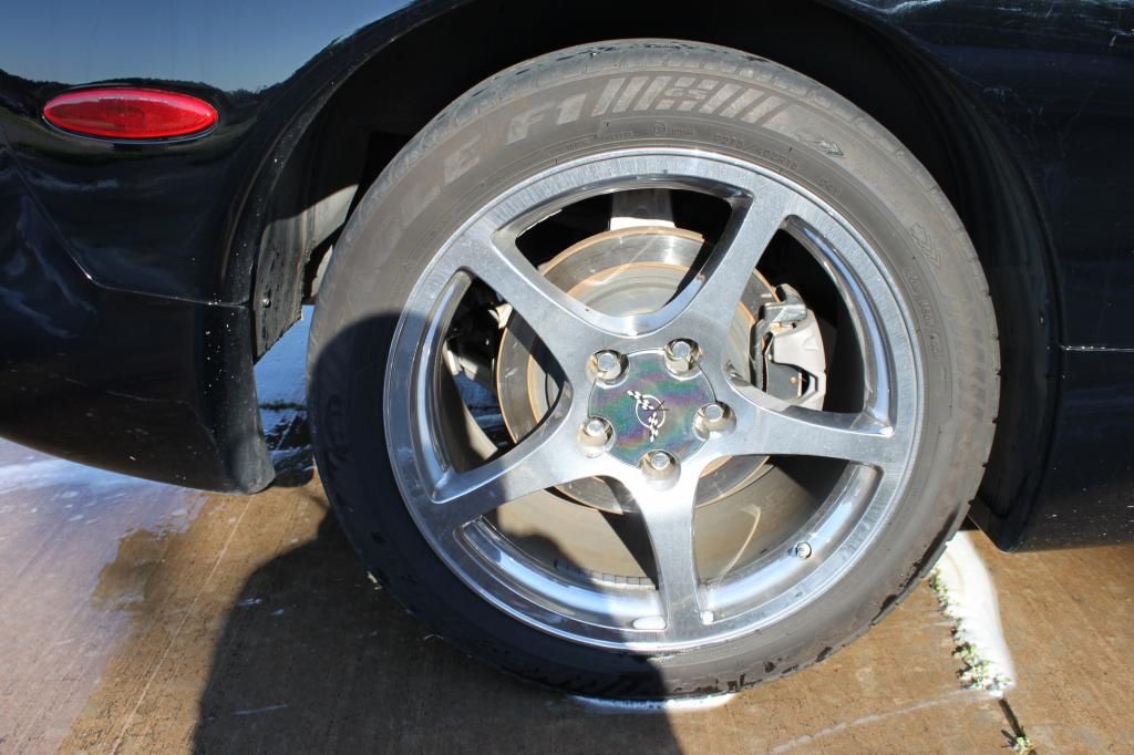

First off, the wheels. Tried a few new products with this one, CG Signature Series Wheel Cleaner. I feel it did well, had to get some APC on the barrels. They still didn't come clean, but the prior owner certainly did not take care of them. They definitely needed a wheel removal detail, but Randy requested I did not take them off.

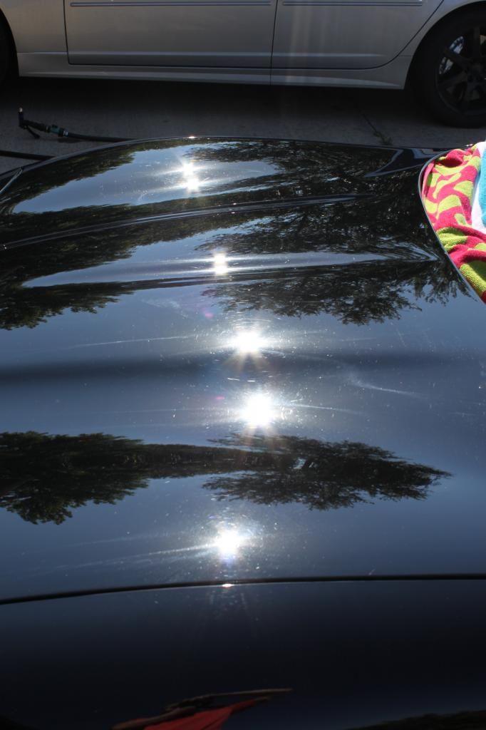

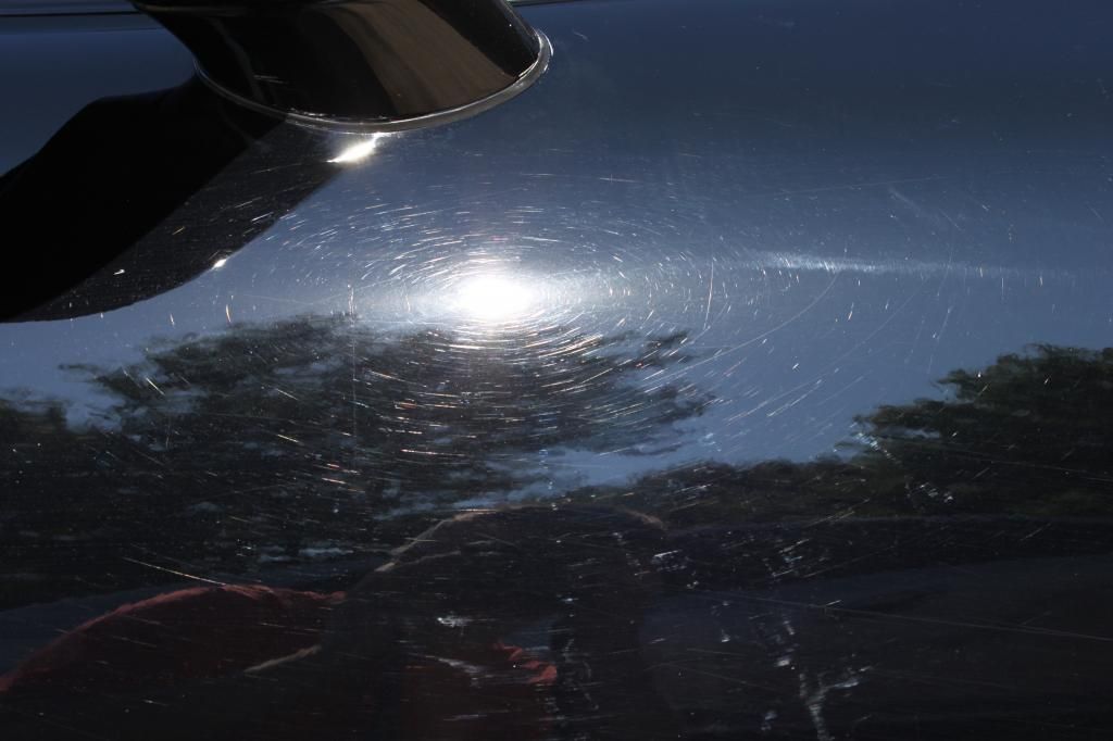

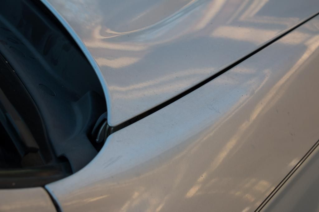

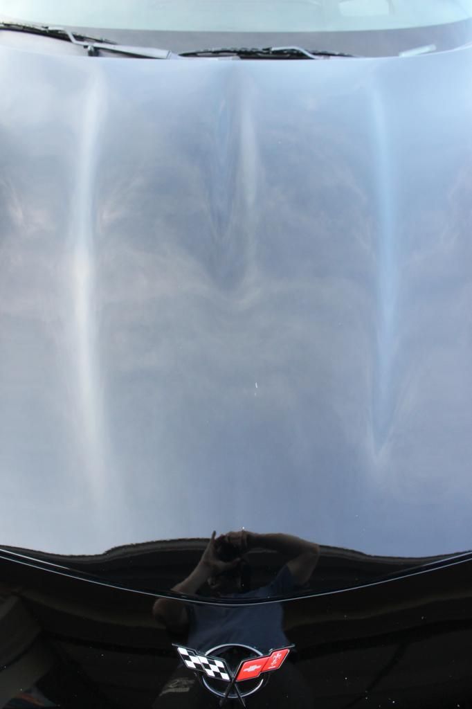

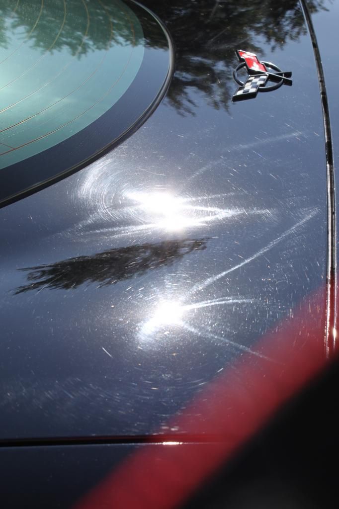

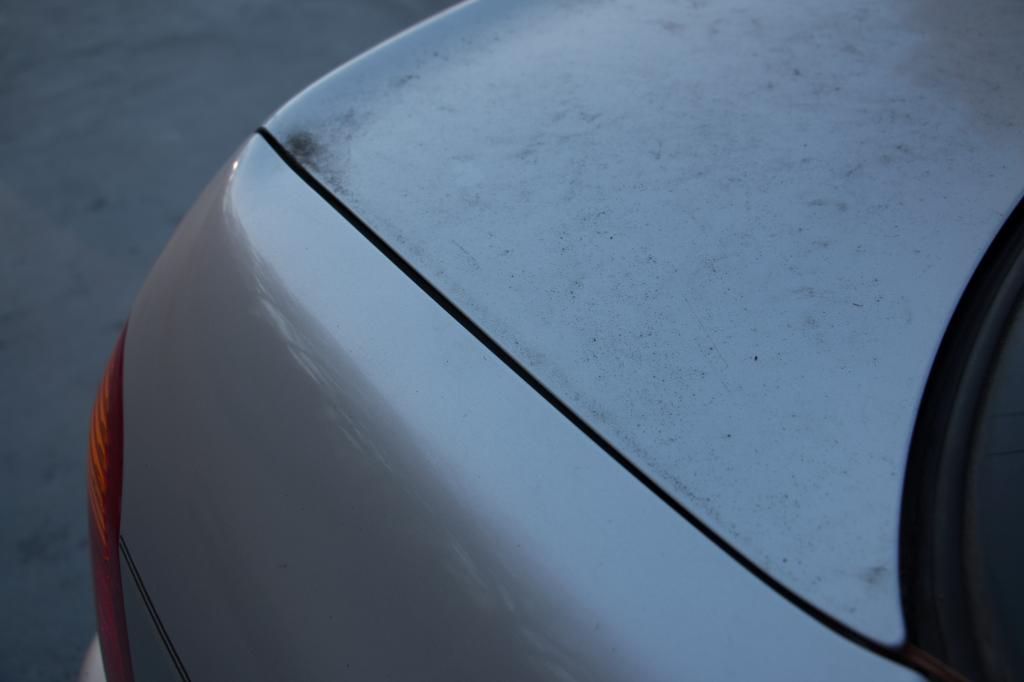

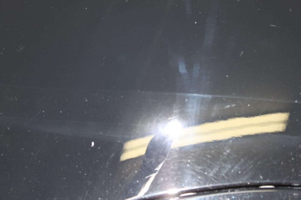

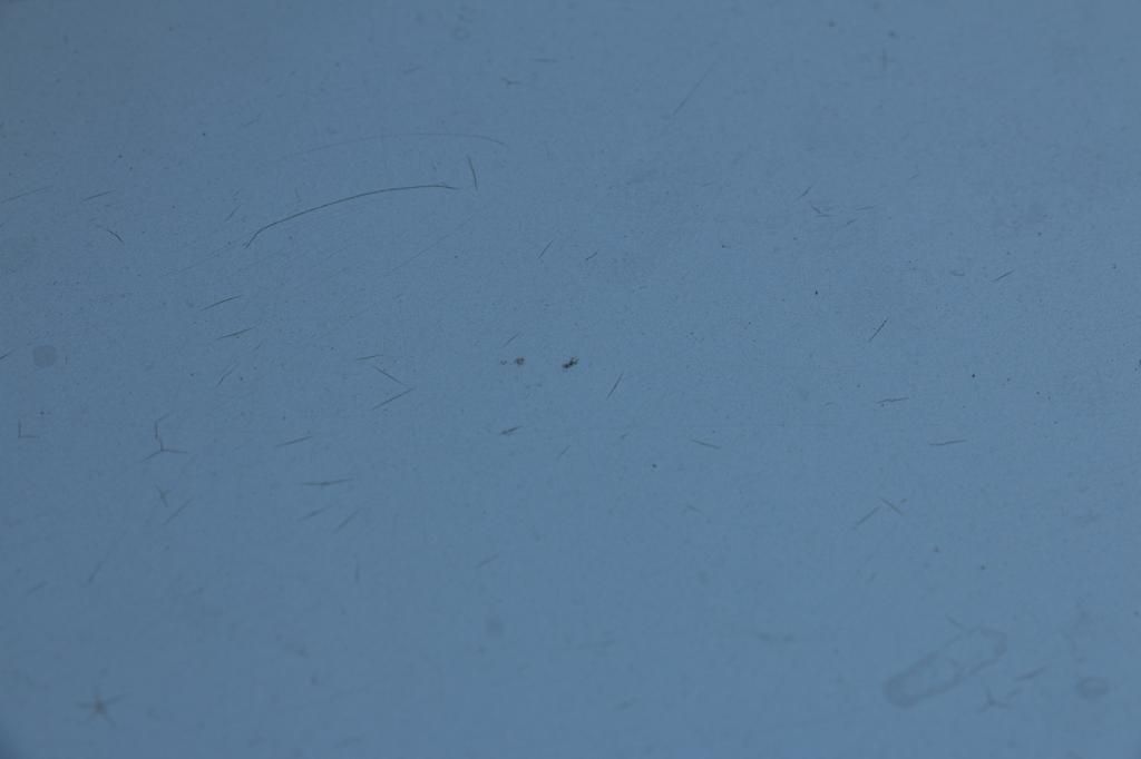

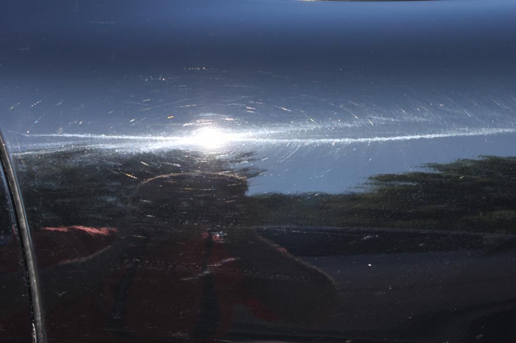

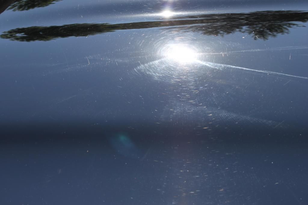

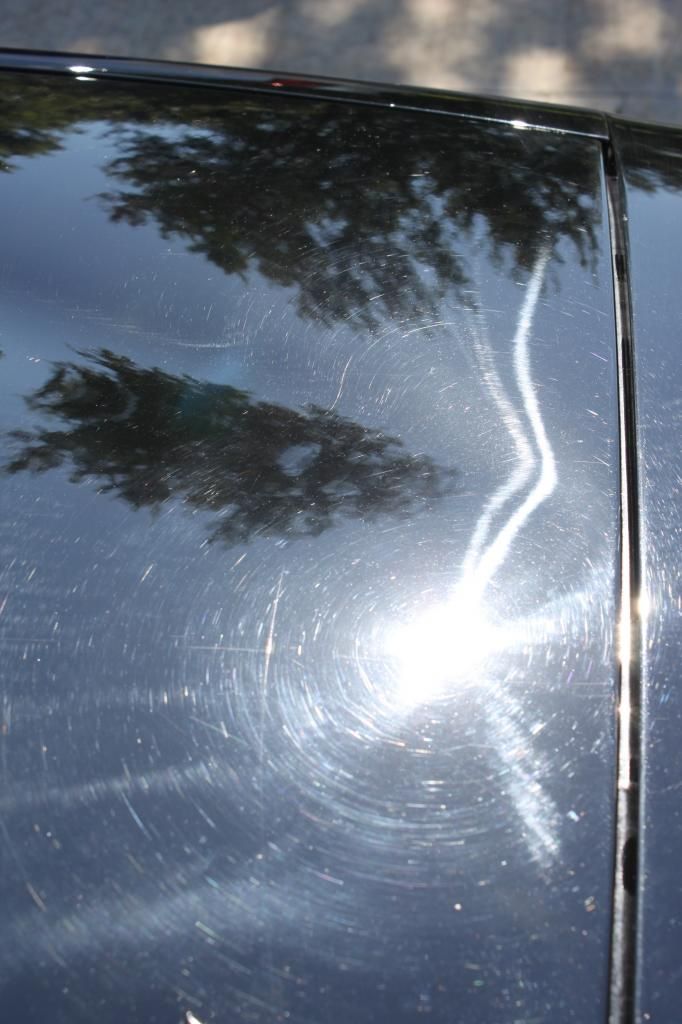

A few showing the condition of the paint. The entire vehicle was like this, with the hood/deck lid being the worst for holograms.

MF D300 didn't quite cut the holograms like I wanted.

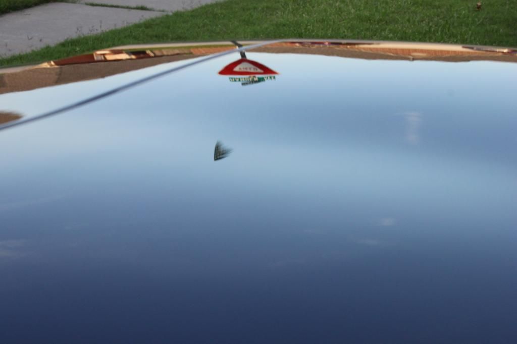

But D300 + a drop of M105 sure did.
Now that I had an action plan, my head was down and I was sweating. The D300+M105 finished down A LOT better than I had ever imagined. Only 1/2 of the car was polished with CG Pro Polish. Why only 1/2 you ask? Because I was extremely disappointed in it. Dusted a lot, a ridiculous amount for a finishing polish in my opinion, and when pushed out into the sun I noticed a few marring sections. This made me very unhappy with the product, good thing it was free I guess. When I get an afternoon with the car I'll be going over it all again with M205.

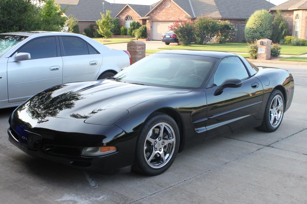

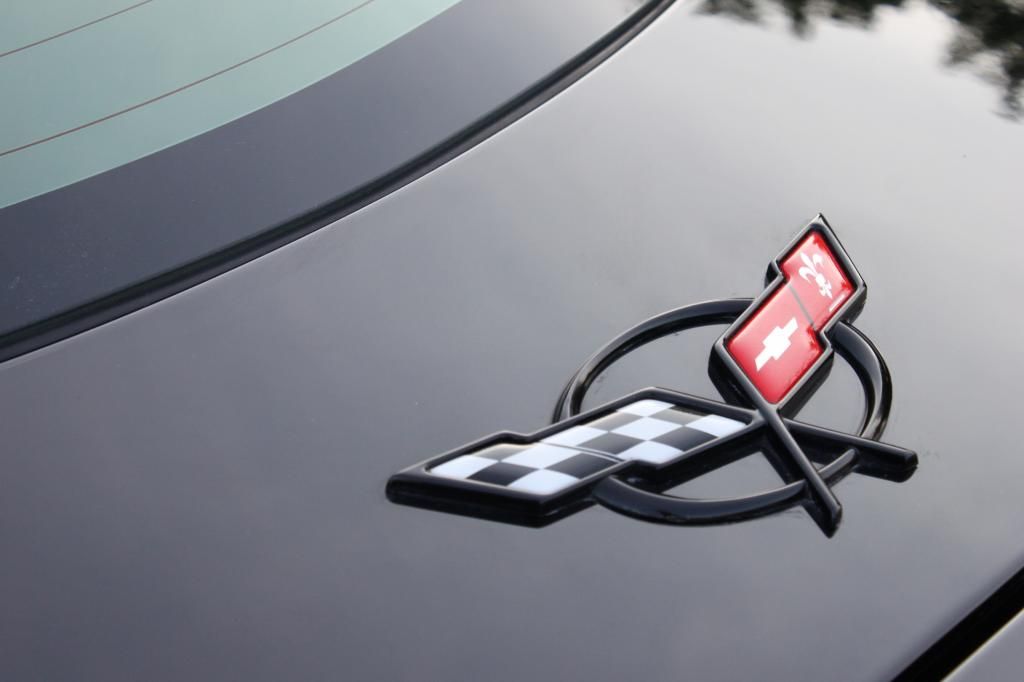

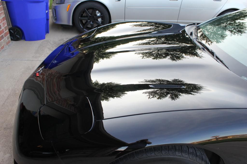

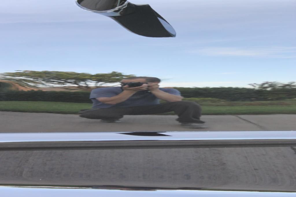

Here are the final results after LSP was applied. No high noon or sun shots, I was about to get in it and deliver it to the customer. After the M205 is done, I will be taking some good photos of it.
