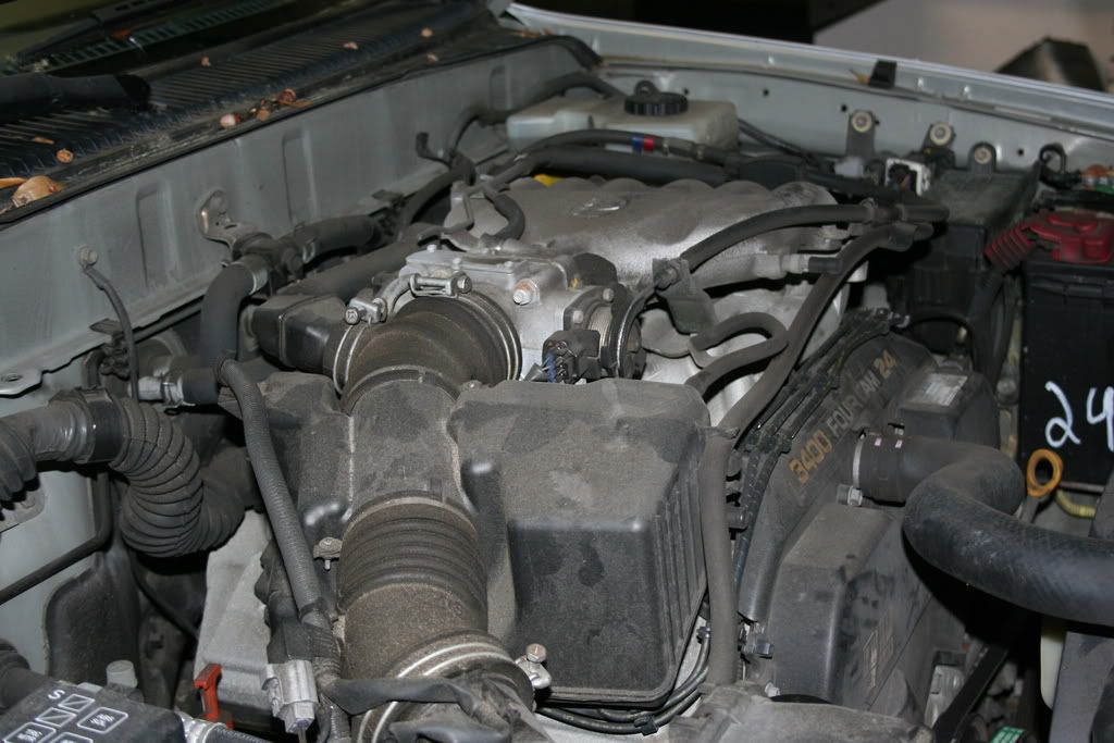

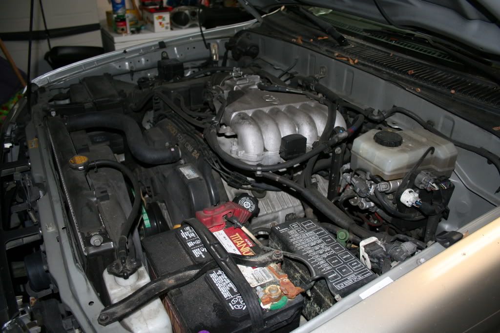

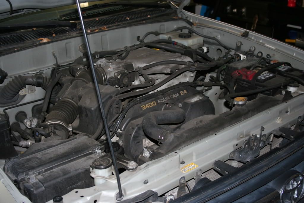

before:

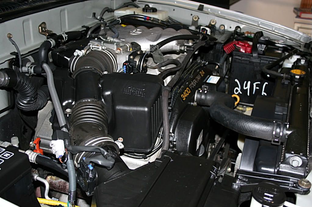

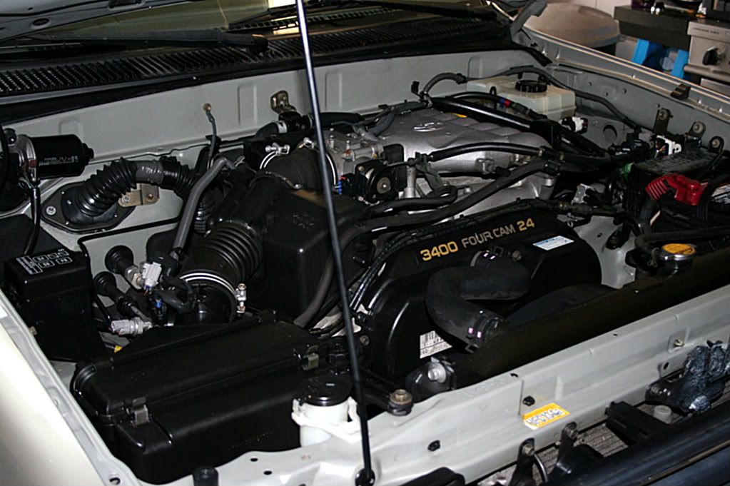

after-yeah I missed part of the upper radiator hose, sorry : )
Good work on that engine. I love that stuff. I'm getting worried though. Not long ago I had six cans and now down to 1 1/2 cans. Hope that it's easy to find.
What an improvement! very nice!

That looks real nice. It sure made a big difference. Did you also do the cowl area around the windshield wiper area with the CD2?
thanks for the comments everyone. It was a learn as i go because other than my car which is an 07 and not very dirty, I had never done this before.
I didn't take any in pics with the areas protected. Every car is different but you don't want to spray water in a couple areas like alternator, ram air or CAI, or distributor caps (those seem more rare these days). I also sprayed WD40 on all areas that had wire harnesses or budles or wire connections. This will form a seal and prevent the harsh cleaners from damaging the wires. The belts can get wet so I just covered them for the dressing part.
