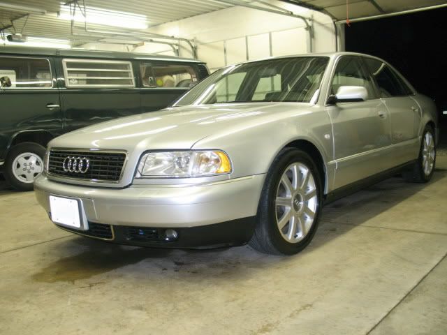

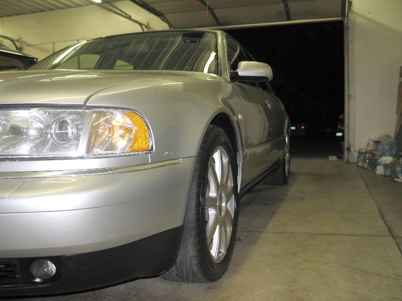

2000 Audi A6
lensch09
May 1, 2007
141

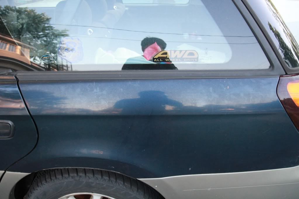

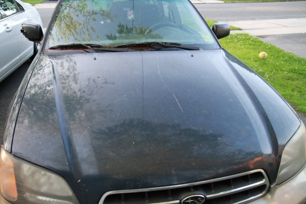

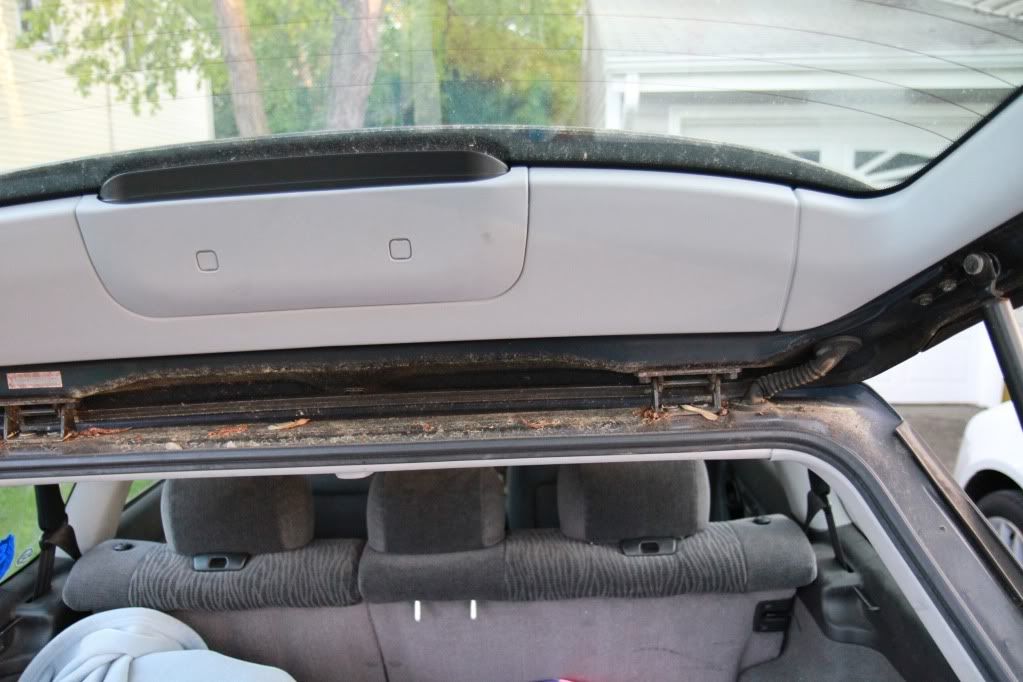

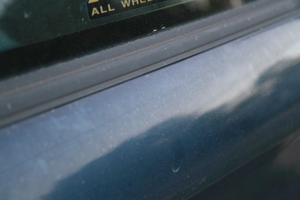

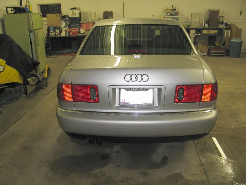

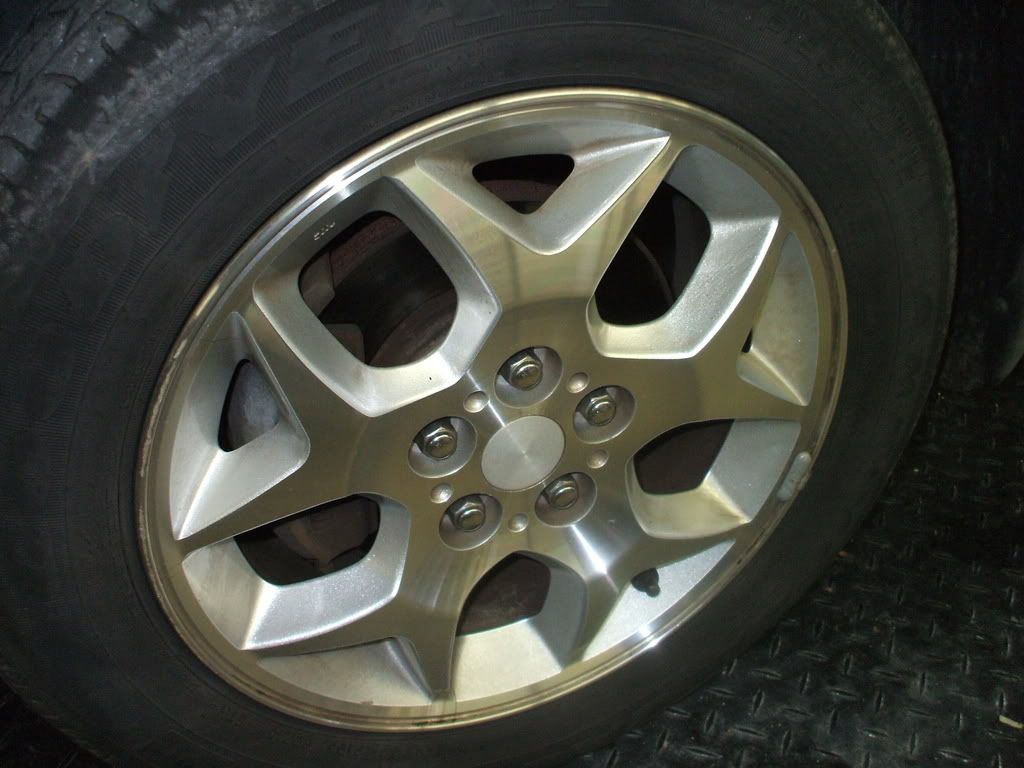

Befores:
Process:
Wheel liners with brush and Meg's APC cut 4:1
Wheels with schmitt mitt, Eagle One Wheel Cleaner, Tire Brush
Wash and dry vehicle using Chenille MF Mitt, Megs Gold Class, Absorber, Forced Air
Clay using Meguiars Professional Mirror Glaze Mild Clay with Megs QD as lube
Menzerna IP at 1500-3000 RPM whith White CCS Pad
Menzerna FP at speed 5-6 on PC7424 with Grey CCS Pad
Pinnacle Souveran Paste applied by hand
Window with Stoner's Invisible Glass
Tires dressed with Meguiars Endurance Tire Shine
Liners and trim dressed with Megs Trim Detailer
a crap load of MF's were used

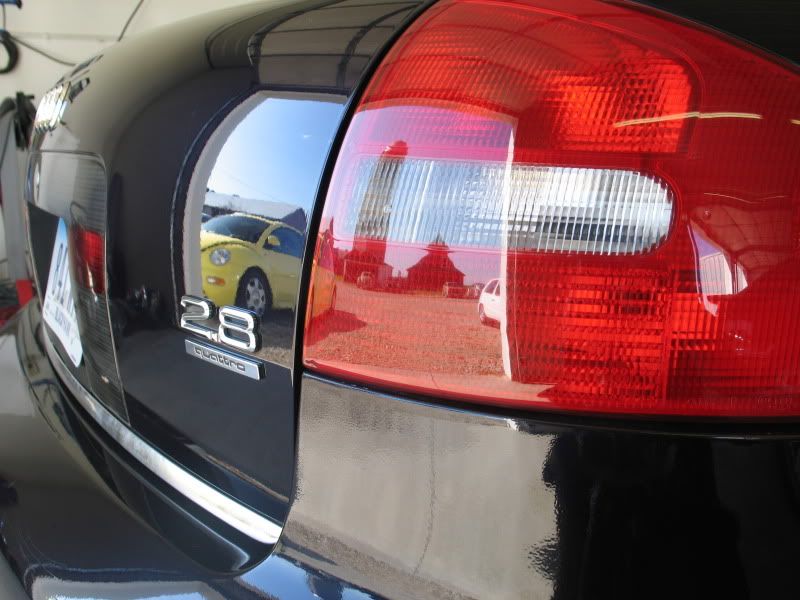

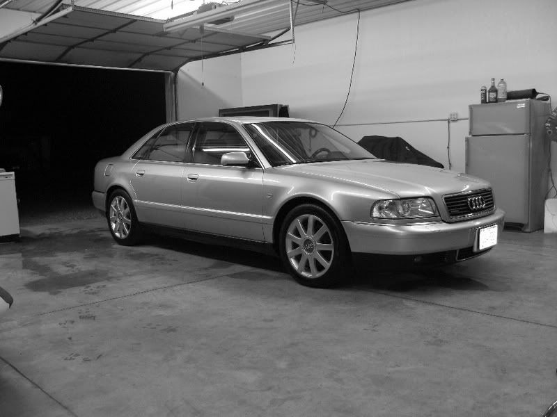

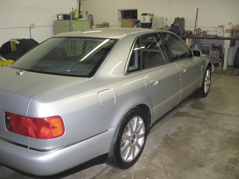

Afters
Cheers folks. Comments Welcome!
-Dan
Wow what a turn around. The rear bumper looked like cc failure. Did it buff out or did you wetsand?
Very impressive, that car was hurting! Good job on that paint.
