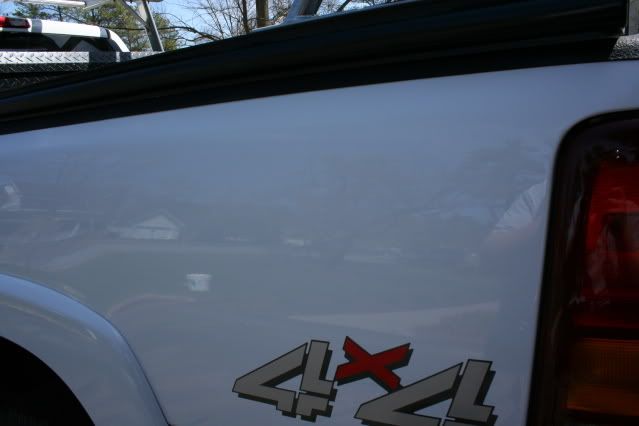

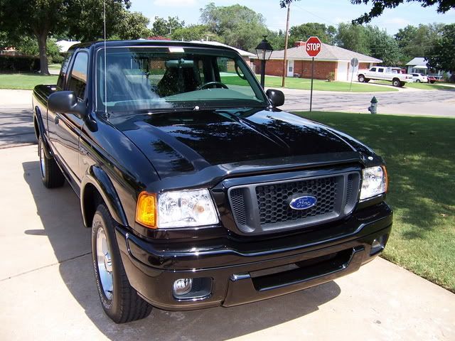

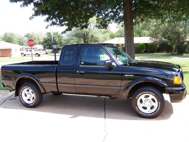

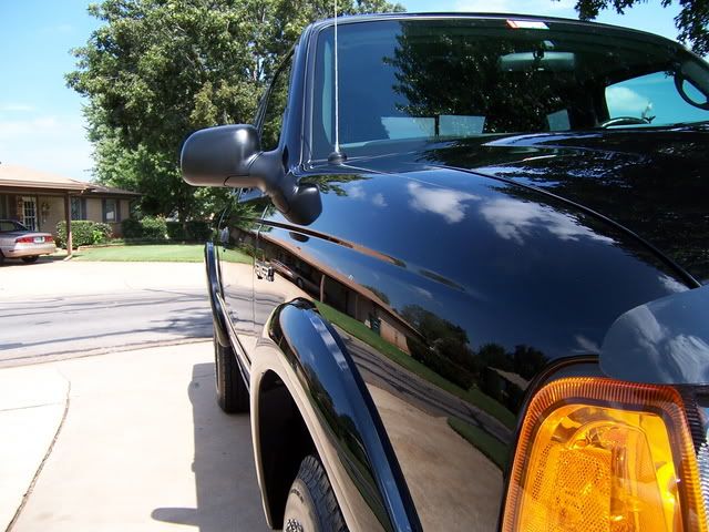

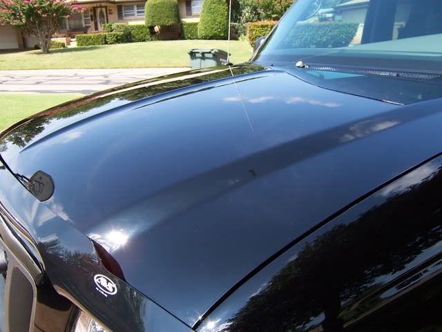

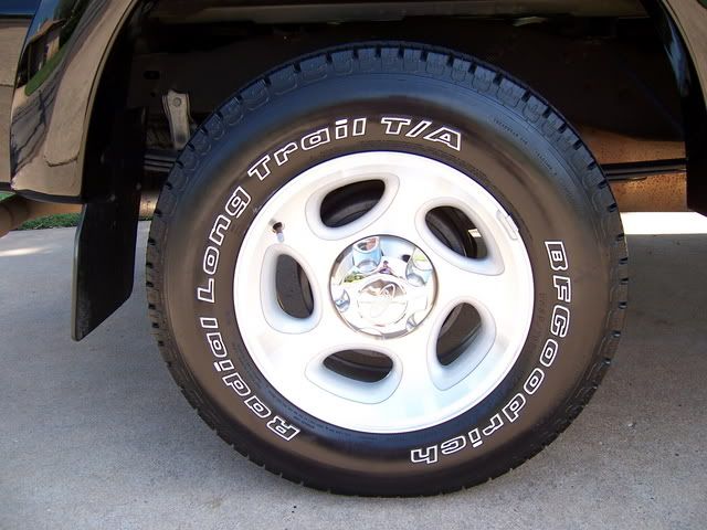

Well it has been a long time since I have posted anything. Life has been crazy for me and well a college dorm parking lot is not a place for car detailing! This is just a quick clean up and shine up of a work truck! I was not trying to remove all the swirls and scratches, just make the truck look better.
The process:
Wash with the shmitt and gold class ( I love the shmitt its a life saver to get all the dirt off!)
Clayed the whole truck This took some time the paint was bad! It had what looked like rush all over the lower panels but it was road paint.
I tried some OC and a LC orange pad and it barely put a dent in the swirls. A push broom is used to get snow off in the winter
Then I switched to a LC polishing bad and Poorboys polish with carnauba. I love this stuff as a one stepper.
LSP: Collinite
Sorry there is not a lot of pictures I was in a rush

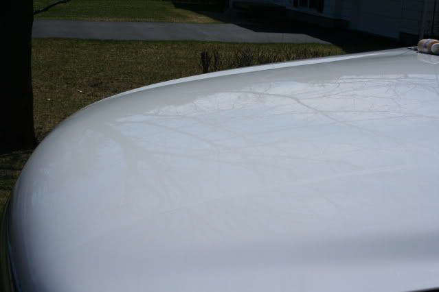

Afters
