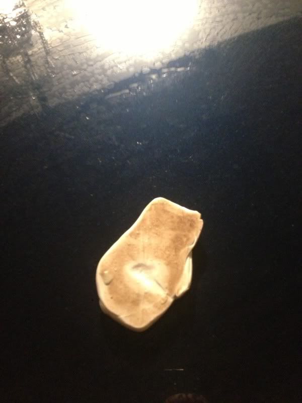

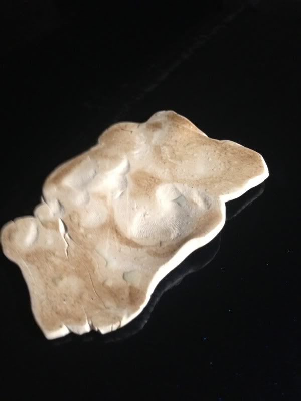

Half hood clay shows the true story of the paint. This car is outside 100% of the time. It is usually parked under trees that sap heavily all summer. It is unfortunate, but there isn't an alternative. Gigantic old growth trees surround their home and business.

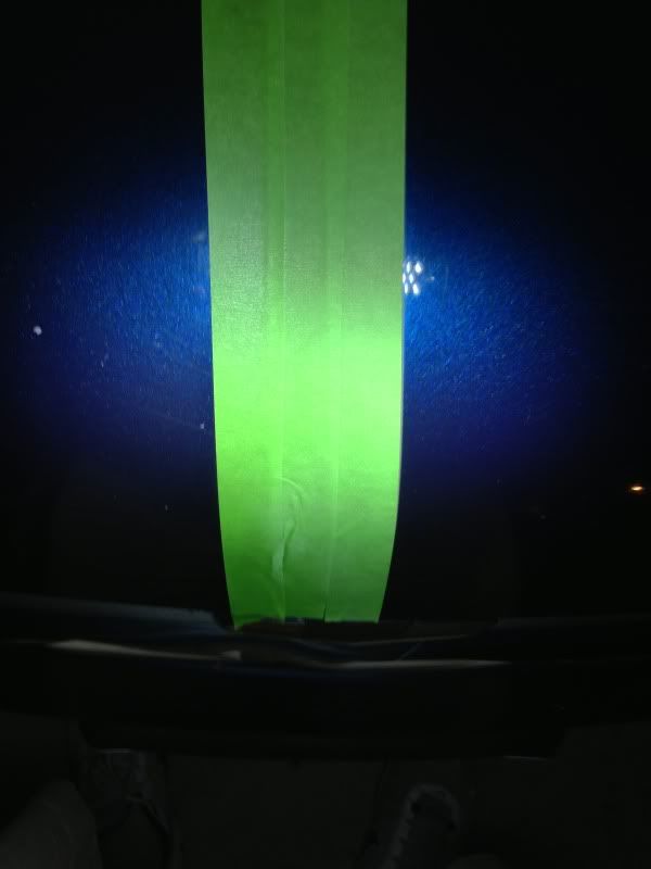

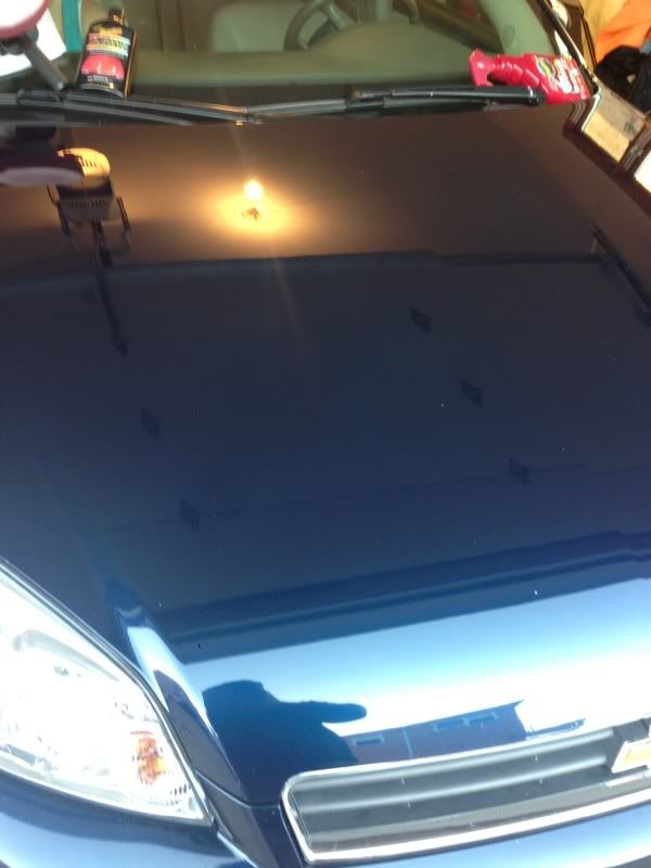

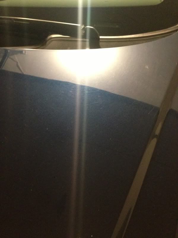

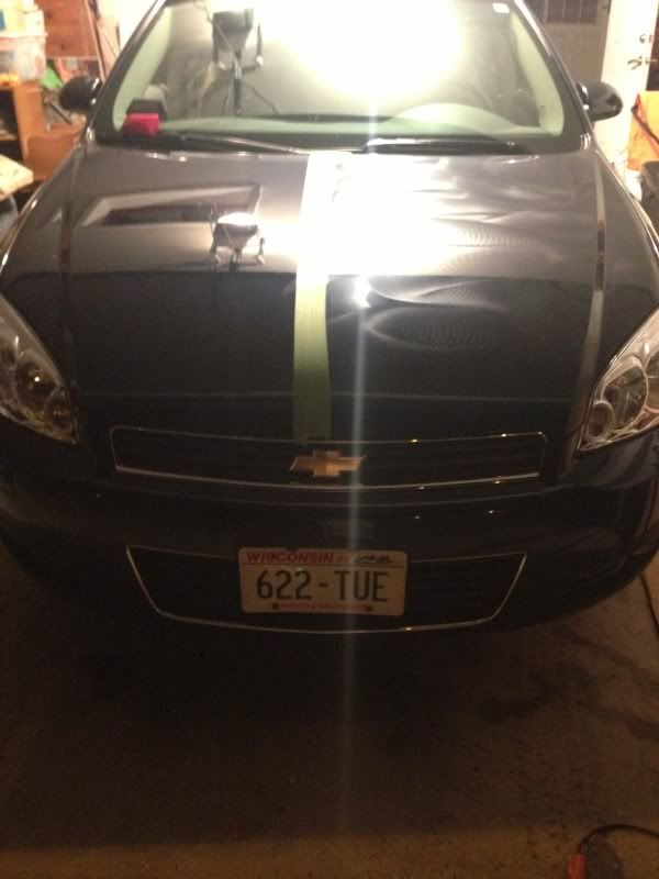

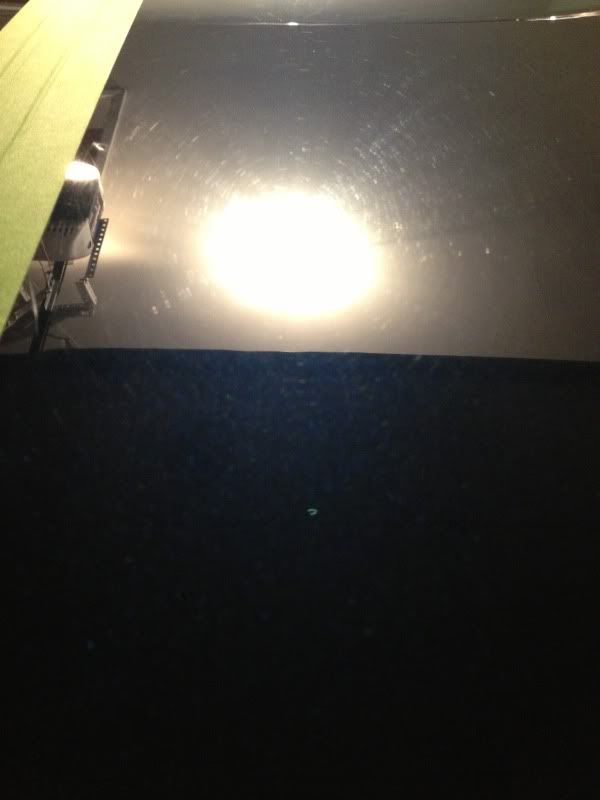

Once I clayed the whole car, I started attacking the hood. I knew I would need a 50/50 for this one. Laid down tape, and snapped a pic. Lighting is provided by a 300w incandescent bulb. Holy swirls! It might be the worst I've come across.
Pics suck because I just grabbed my iphone on this one. But it tells the story. Zero gloss.

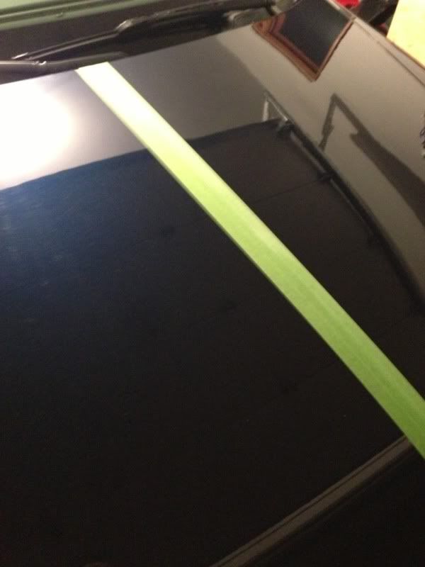

Applied Meguiar's Ultimate Compound on a 7 inch maroon Soft Buff 2.0 pad (Speed 5).
Here you can see that some depth and gloss had returned! Maybe it could be saved after all!
Finished the whole hood, and my my, what a shine. This is just after compound, no polish yet! What swirls?!!?

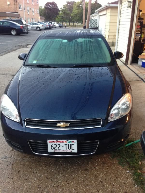

Actual water beading had returned. I haven't ever seen water bead on this car. It usually runs off flat.
