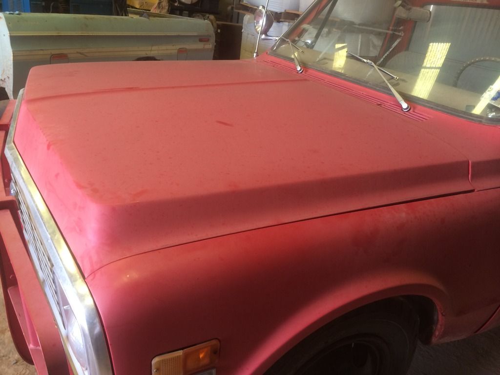

Picked up this 1972 C30 that was used as a small town firetruck. As you can see, the paint has seen better days. It must have been repainted immediately for the fire dept.
I would like to bring some life back into the paint, but would like to use stuff I already have.
I read Mike's single stage thread and have picked up a bottle of Meguiar's #7. But I am unsure what to use after that point.
There are some "FIRE TRUCK" decals on the doors that I will pull off and probably need to polish out some to make the lines less noticeable.
So after the application of #7, what compound/polish should I go with? I have a HF DA polisher and Chemical Guys Orange and White pads.

Actually, the products you have are a decent assortment for your intended purpose. You won't know for sure what to use until you finish an overnight soak or two with the M07. They very application of M07 with terrycloth does a fair amount of polishing on its own. At that time take a good look at the paint and decide what your next step will be. Depending on how much correction is desired, either UC, White Wax or UP would be your next step, in descending order of aggressiveness. If you go the UC route, further polishing with either UIP, WW or BW will likely be needed.
As far as the compatibility with Ultimate Wax, you're gonna have to test it yourself. Most of the SS paint restos I've done have been with a traditional wax, but I've used sealants also with success. Some darker color paints gave me some streaking issues with sealants, most did not, so I did a sealant, often layered with a wax on top for a bit more pop.

First, like mentioned, just the act of rubbing the paint down with the #7 and some cotton terry cloth, like you're average bath wash cloth, the terry cloth will abrade off the old dead paint and together with the lubrication and beautifying oils in the #7 you'll already be restoring gloss and richness of color.
I think you'll be surprised out just how great the paint will look after a energetic rub-down by hand using the #7.
After that, TEST polishing first with the Ultimate Polish and a soft foam polishing pad and your DA Polisher.
See how the results from your test spot look compared to a section of paint next to the test spot. Make sure machine polishing is actually making the paint look richer in color, more clear and more glossy. If it is then you can repeat this over the rest of the truck.
If this first test looks good then if you feel like it, you can also test using the Ultimate Compound also using a either a soft foam polishing pad or a foam cutting pad.
Be sure to inspect the results and compare to the results you created by hand. IF the compounding test looks great then re-polish this same section with the Ultimate Polish and a polishing pad. Now it should look even better.
The point is, dial-in a process that gets you the best results. I've always found machine polishing after restoring the life to the paint with the #7 to work miracles.
My buddy Chip used my #7 technique to restore the original paint on his 1958 Cadillac but they found machine polishing didn't improve what they were able to do by hand with just #7 so be sure to TEST.

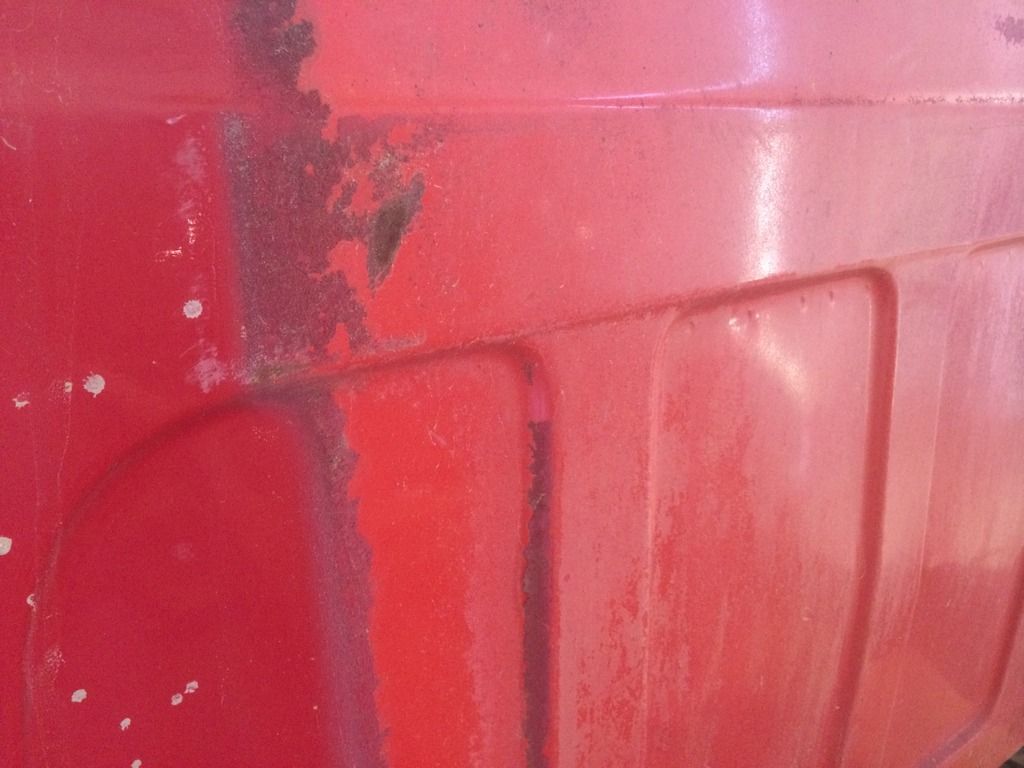

Be very careful around raised body lines and edges as single stage paints tend to be softer than basecoat/clearcoats paints and it's real easy to create a thin spot on raised body lines and edges.
Also on that note, if you decide to compound you also want to be very careful. If you remove too much paint on any panel the underlying primer coat tend to be black with this old paint technology and you'll start out seeing a tiny black looking cloud in the paint and if you keep on buffing the black cloud will get bigger and bigger!

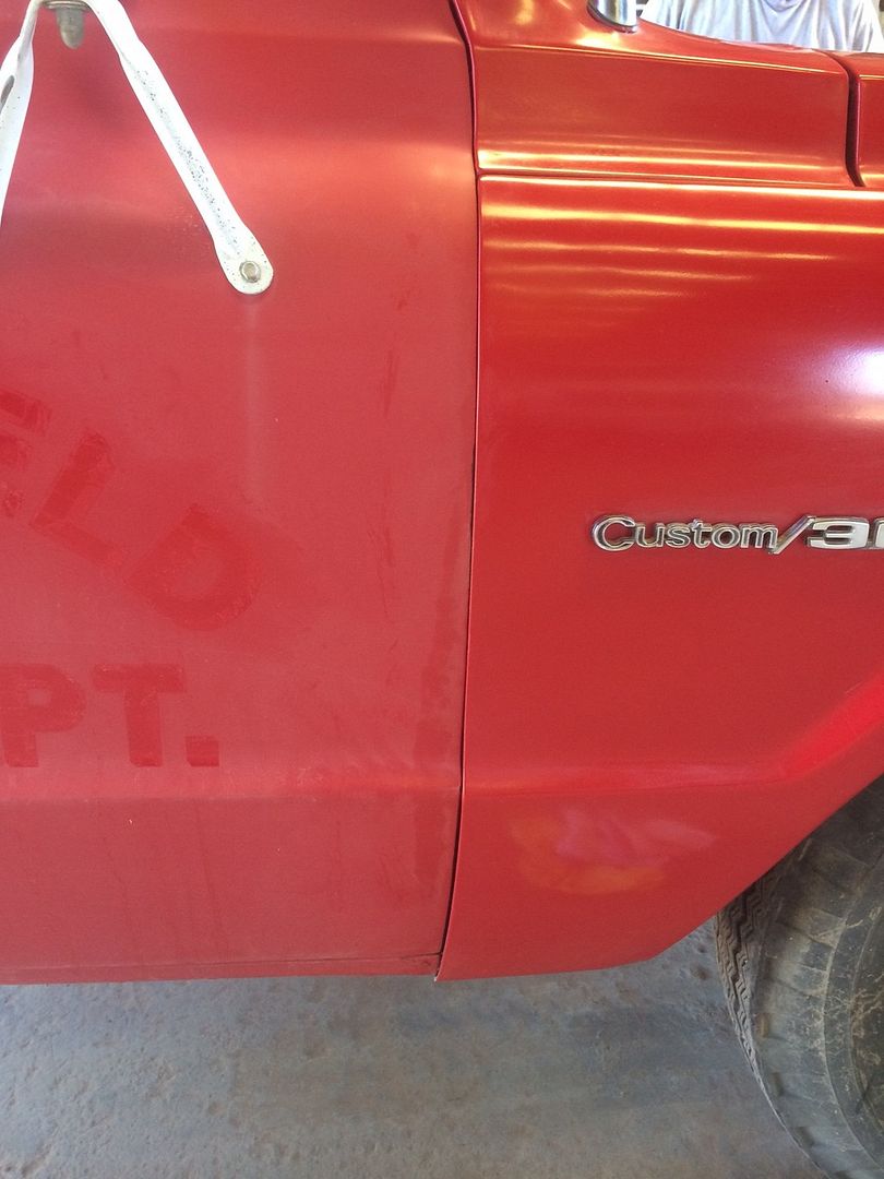

Thought I would give an update. Finally got around to hitting this truck with some #7 over the weekend. While I am having some trouble with blotchy-ness, the paint looks way better. I think I need a couple more applications and it will look more even.
Here is a shot of the difference between the first coat on the fender and original on the door panel. HUGE difference.
Any ideas on safely removing the old adhesive from the stickers? Will goo-gone take paint with it?

My technique, time permitting, is to repeat the process as many times as it provides benefit. I've done as many as 4 apps. It's hard to describe, but you'll eventually feel that the paint is saturated and no longer absorbing product. That's your signal to go to a polish or wax step. I've been doing the process yearly on my El Camino for six years and a single M07 app now does the job. In the earlier years each subsequent app showed improvement. Maybe it was the rubbing action or maybe it was the oil content still being absorbed. All I know was that it worked.

I ordered a can of 3m adhesive remover and an eraser wheel. From what I have read, it is safe for single stage. The stickers took a couple chucks of paint of the doors, so I'm not too worried. Someday I will get a sign made for the door that will cover it up, but in the meantime I'll get it to 90%.

Remember, if you're rubbing the paint down by hand - you get tired. So don't tackle to large a section at one time and try to rub each square inch equally and this will help to create a uniform appearance.
The oily #7 might actually do the trick. I'd test rubbing the adhesive with the #7 and your terrycloth wash cloth. Can't hurt anything.
Looking great, thanks for updating this thread.
