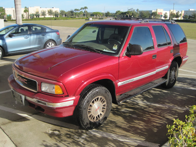

I love working on old beat up daily drivers, and this weekend I got to work on a 1997 GMC Jimmy that hasn't seen a wash in a looooooooooooooooooooooong time. I was limited in time for this detail so I didn't have a chance to take too many pics, but I was excited to use a few new products.
The owner loves this vehicle, but thought the finish was too far gone to spend any time making it look better. I knew with a little time and the right products that it could look much better.

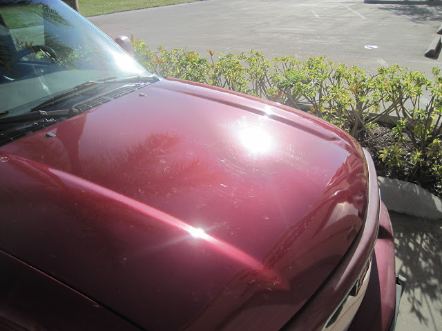

Swirls galore.

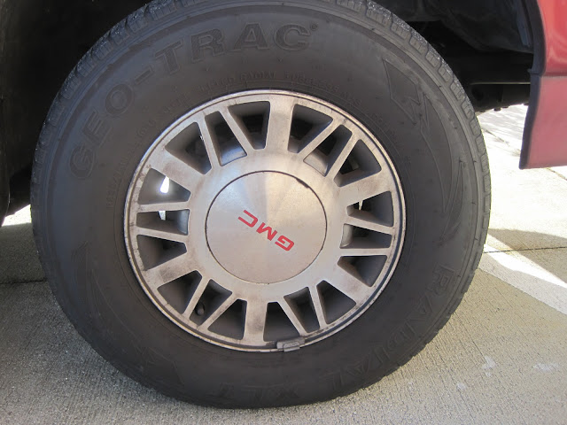

Neglected wheels and tires.
The entire truck looked like it was washed with a Brillo pad.

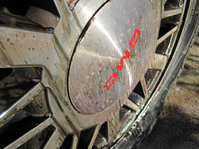

While the brown sludge was melting off the tires, I applied Wolfgang Über Wheel Cleaner to the wheels.
With a little agitation...
The wheels were so bad they required a couple applications and extra agitation.

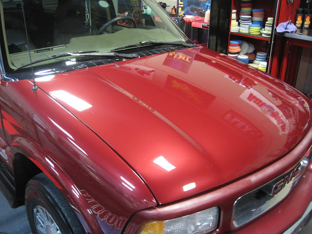

After decontaminating, I pulled Jimmy into the AG Show Car Garage for inspection...
I started with a test spot and the least aggressive method first. I wanted to use Menzerna Polishes this time with a Cyclo Polisher. I quickly learned this paint was HARD. Menzerna Super Finish (SF-4000) had no effect on the paint. I tried Menzerna SIP - Super Intensive Polish (IS 1500) and I started to see progress...but I knew I could get better results. So I used Menzerna Power Gloss Compound (PG 1000) and got great results.
50/50 Hood Shot
Before I got started on the rest of the vehicle, Nick suggested I try out Menzerna Fast Gloss Compound (FG-400); and I'm glad he did! FG-400 was thicker than PG1000 and worked faster. Surprisingly, Fast Gloss Compound got the paint glossier, faster :) .
