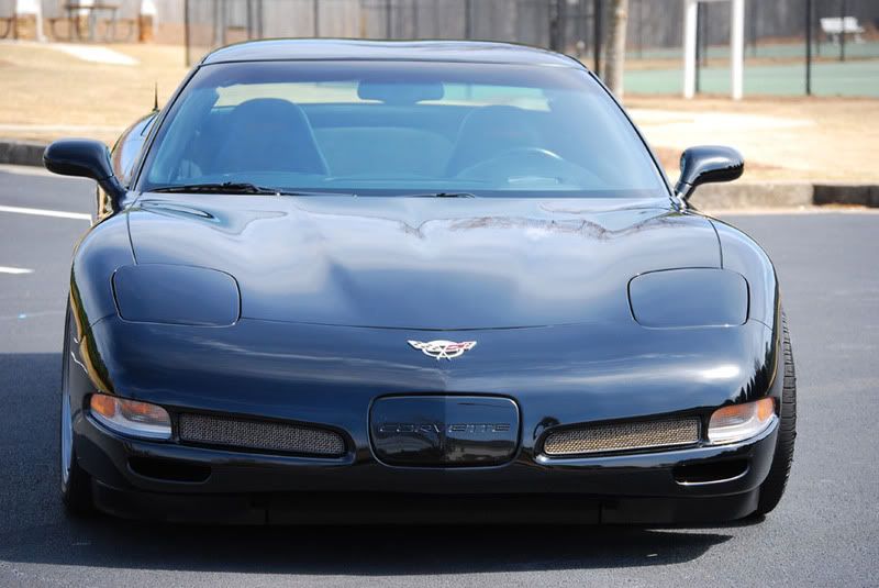

When you see the first few before pics, you will see why I was contacted.

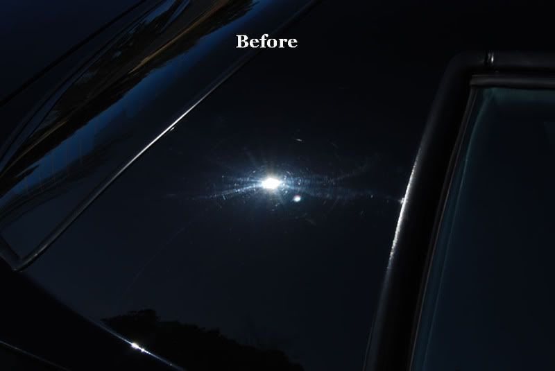

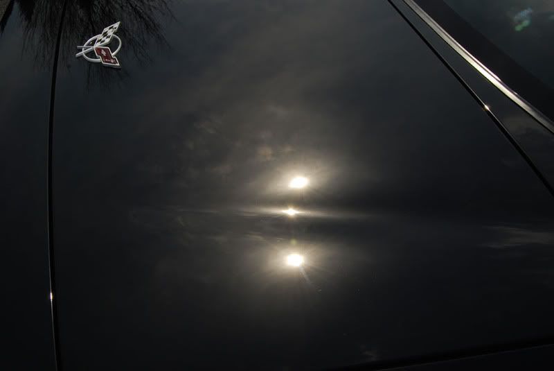

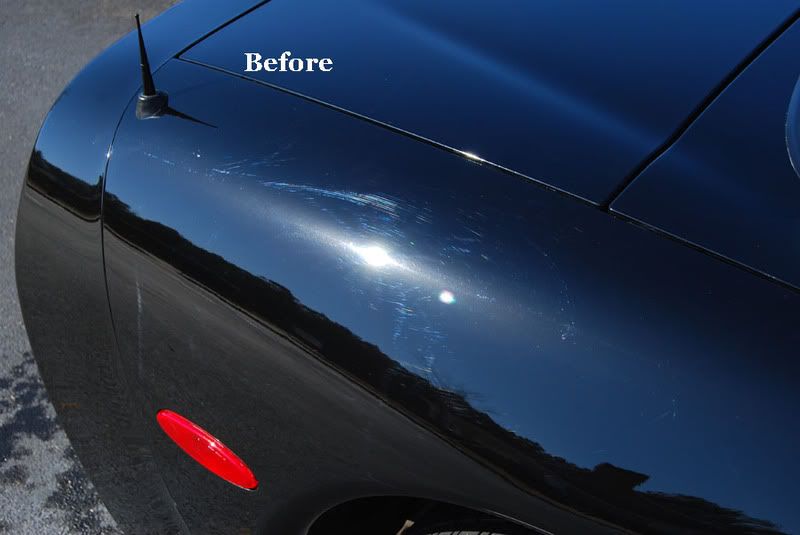

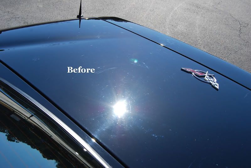

The befores

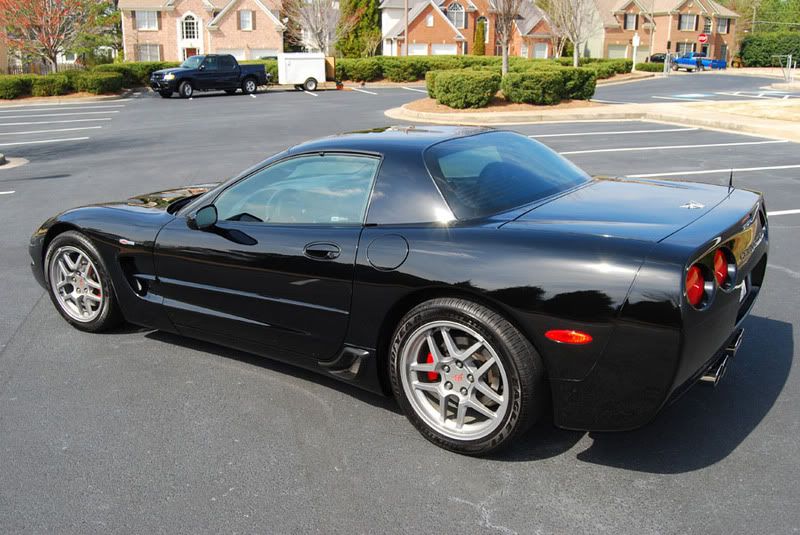

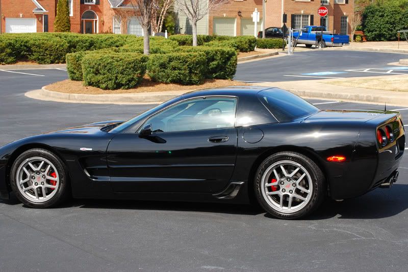

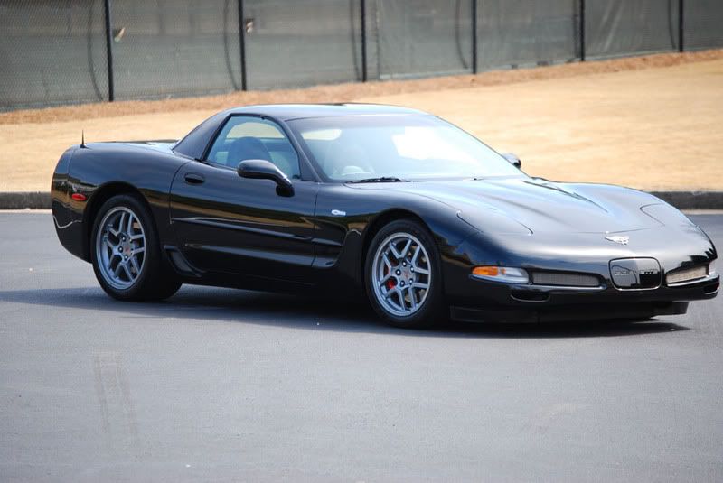

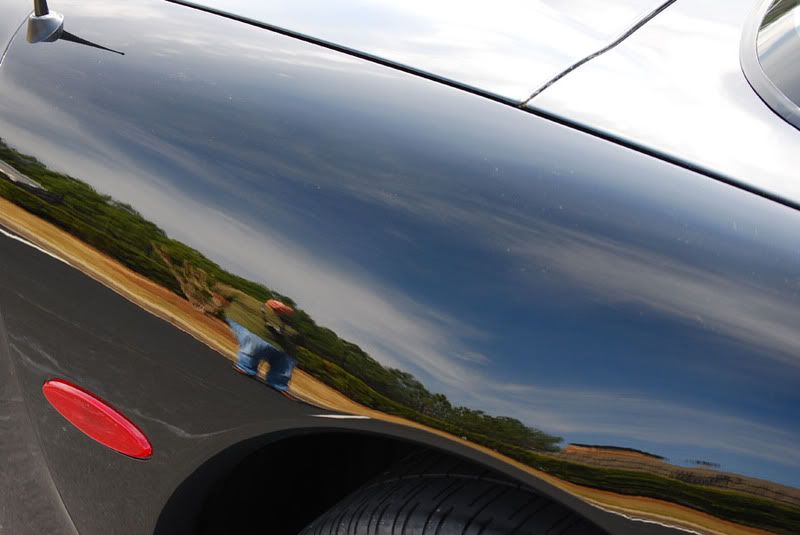

The Afters

The Gameplan
I started with the new cobra cross grove org cutting pad, and Menz SIP. The DeWalt speed set between 1400-1600. (you don't need a wool pad on a corvette like they say on other forums)
After that fun was done, I pulled out the pc with a low profile org pad, with optimum polish. After that was done to the whole car, I went back over it again with a new to me green ccs 5.5 pad with optimum polish.
