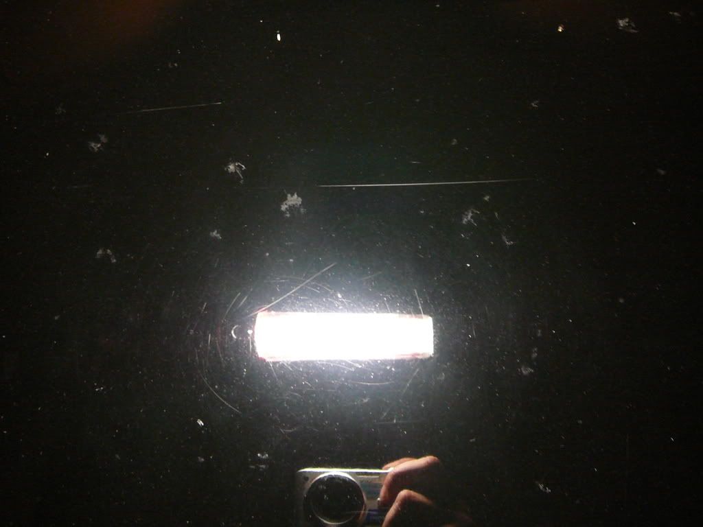

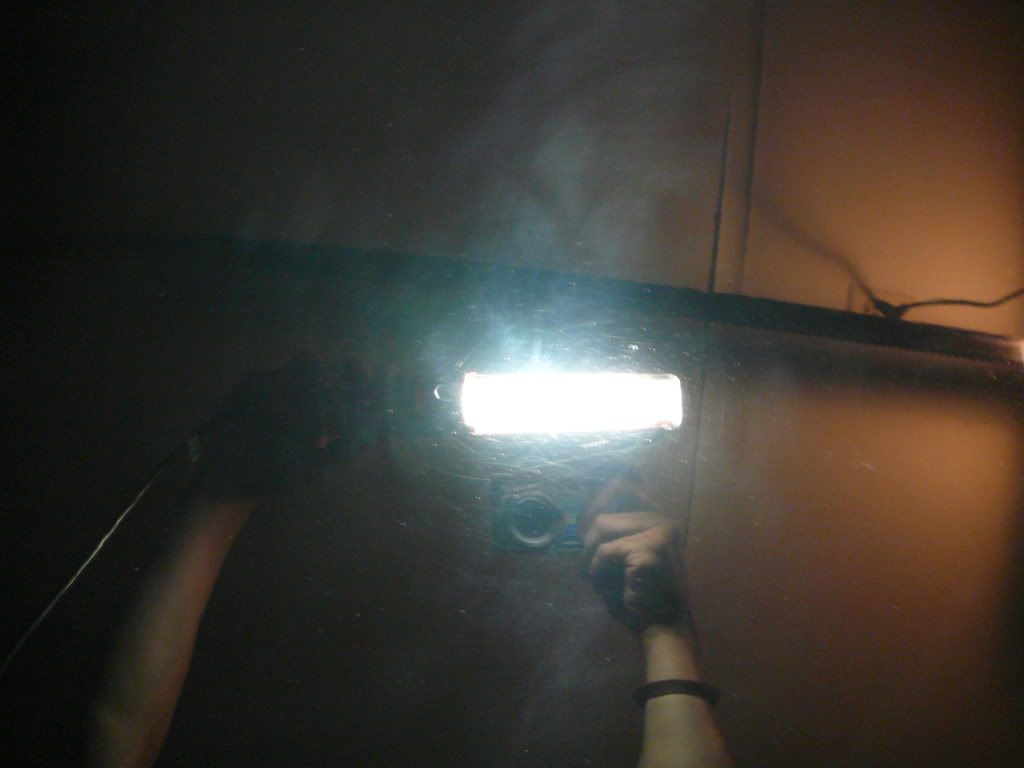

Here are some pics...
Banged up hood...This is the worst area. Bad horizontal scratch, swirling and those mystery marks that are smooth but look like sap/gunk. They seemed to multiply after the clay and AIO. I clayed them pretty good, but was afraid to use a lot of pressure.
Roof pic
Looks like there's some good progress there. Maybe just a bit of polishing haze left behind to clear up with a final polish. Good work so far.
