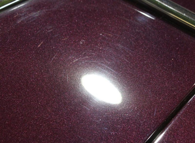

Just to comment....
After looking at the pictures of the scratches in the paint job - whoever has been in charge of this car or the owner of this car is to blame for it's current condition.
The level of scratching is simply ridiculous.
Don't feel bad if you can't remove all the scratches Tom, don't put yourself at risk for going through the lacquer clear.
Looking forward to the after shots..

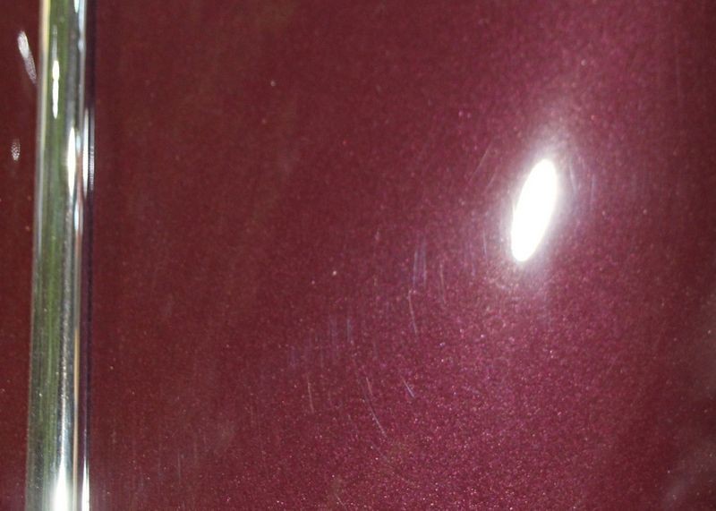

Up-dating...
And more to come---stand by...
Rupes blue/blue
Rupes yellow/yellow
BLACKFIRE sealant all over car
BLACKFIRE's Midnight Sun carnauba wax on trunk and hood.
Took me about 14 hours to do...
Tom
Nice work, Tom!
From the looks of your car pics and the pads, you achieved a good level of correction without going thru the clear, not an easy task on the old lacquers. Don't ask me how I know.
Bill
