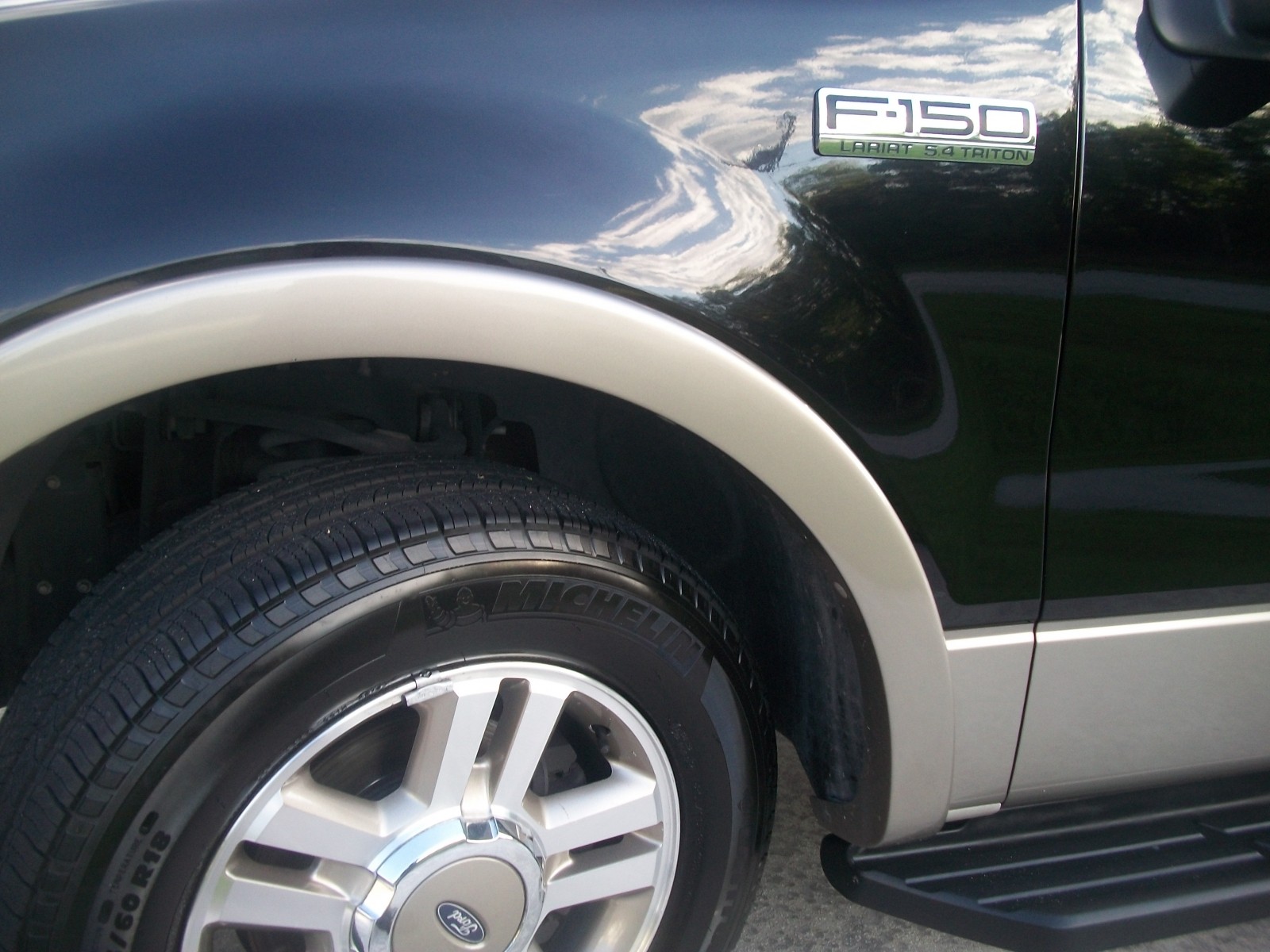

From reading Nicks thread when he was introducing the Uber AIO I got the impression that it was maybe a very light to light cleaner not a medium. I can't say I don't have any swirls but either I do not have or I can not see the swirls in my truck. It's only been hand washed (never saw the dealer wash it). I just wanted something with long term protection because of time. Would I be able to use it by hand to stay closer to a light cleaner so I can still get the protection/longevity I wanted with out inducing any marring or I guess what I think I may do to the paint is over clean it? Does that make sense?
Or should I just go back to my first choice the Klasse twins?
