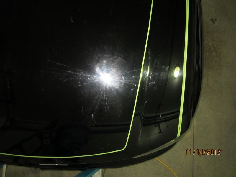

There's a simple test you can do to determine if the wheels have a coating or if they are straight aluminum, just be careful where you do your test because if they are coated and you use too aggressive of a polish you could scratch the coating when you do the test.
From this thread,
The Secret to Removing Oxidation and Restoring a Show Car Finish to Antique Single Stage Paints

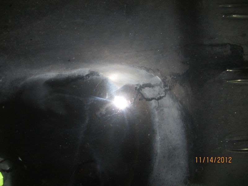

Oxidized Aluminum Turns Black
With metallic single stage paints, oxidation can show up as a darkening effect on medium to light colored paints because the aluminum metal flakes embodied inside the paint will stain or discolor the paint with a grayish black color.
If you’ve ever polished uncoated aluminum then you’ve seen this grayish black color coming off the aluminum and onto your polishing cloth as you work a metal polish over it. This same type of oxidation is taking place to the aluminum flake inside the paint.
Polishing Uncoated Aluminum
Oxidized Aluminum Comes Off Black
