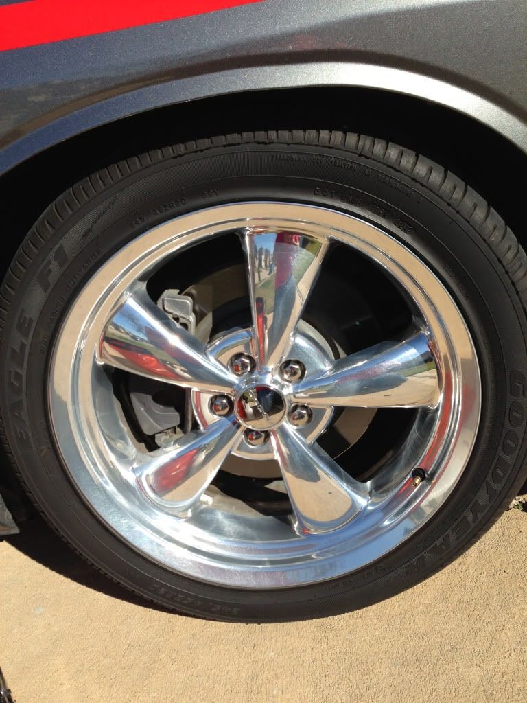

I had some trouble with some wheels this weekend and wanted to see if anyone could chime in on what I could have done to improve the wheels even more. The problem i was having was not cleaning but polishing them.
The client told me they were heritage classic wheels and they were non coated aluminum so first thing i did after the initial cleaning was take a microfiber cloth and some Mothers aluminum polish and did a test spot. I got no black residue even when sufficient elbow grease was used so that told me right there that these wheels must be coated.
I then decided to use some Optimum Compound II to remove the fine scratches that were present in the wheel and no improvement. So next step was to cut up some white LC pads I had and use them with Optimum Hyper Polish by hand and then again no improvement. What in the heck did i do wrong that those fine scratches wouldnt come out?
Here is a before of the wheel, a little dull and dirty
And here is the wheel after hand polishing by hand with Optimum Hyper Polish and a cut up white LC pad. I also sealed the wheels with two coats of Blackfire Crystal Seal. Tires were dressed with UTTGP
Any thoughts?
