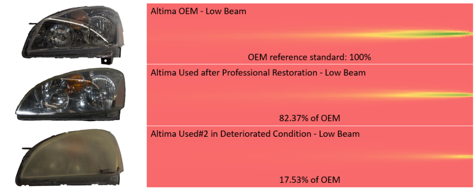

A study done in 2018 by AAA regarding the performance of lens restoration and aftermarket replacement headlamps revealed some rather interesting data. For the restored sample headlamps, the beam performance achieved was only 50-80% of OEM performance. This means that while they *looked* like newer clear lenses they did not perform like brand new dealer OEM lamps.
Here is one of the samples, an Altima headlamp, and the measured beam performance in a birds eye view of the scan. Though the restoration improved the beam, it still was not as strong as a new OEM lamp.
New OE lamps are not always cheap but they do guarantee the best performance between a restoration kit and an aftermarket replacement.
