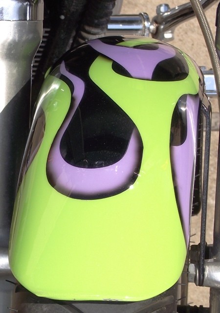

How long after the application of the EXO did you wait to wipe it off? I know in those temps which were quite similar to what I have done a few lately. The only one I did that was EXO right after CSL was a bike for my step son a few weeks ago and it was around 90 sec wait for the level and buff. It was probably 30 mins between the finish of CSL and the start of the EXO all the others were probably 12~18 hours later, but either way the results were very good.
Other than going too soon the only thing I can think of is a little too aggressive in the leveling/buffing process. The EXO just doesn't wipe off as nice as the CSL and they do say that wipe gently to not disturb the coating in the early stages of curing.
Here are a couple shots of the Bike.
