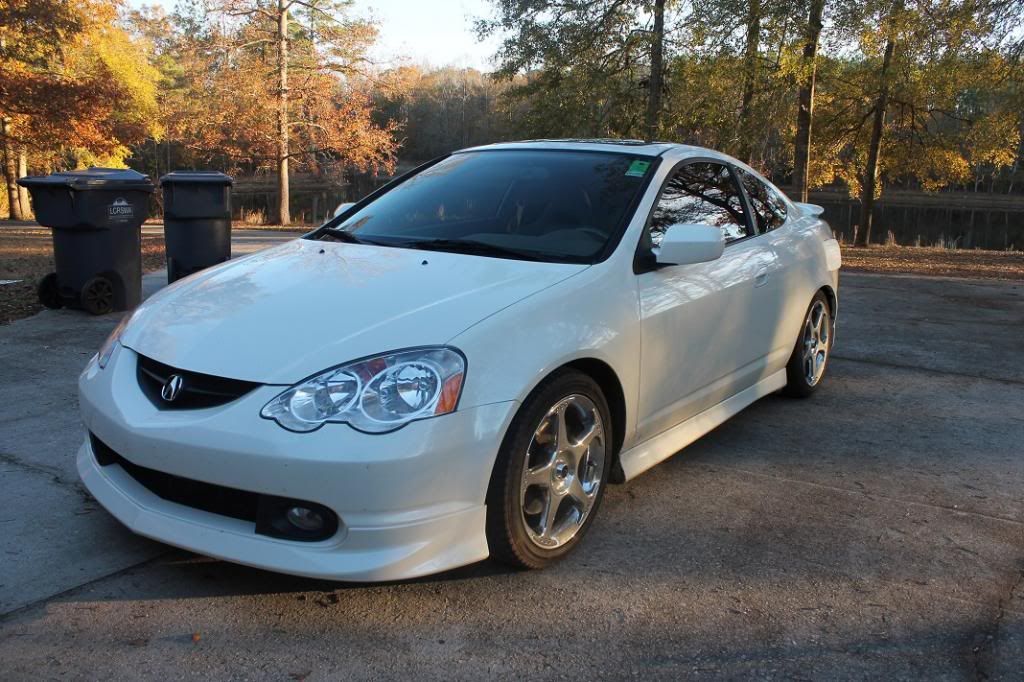

Worked on this RSX over the course of three days, owner was very pleased with the results. As you can tell, the paint was in pretty rough condition, especially considering the fact that this vehicle has just over 20 thousand miles.

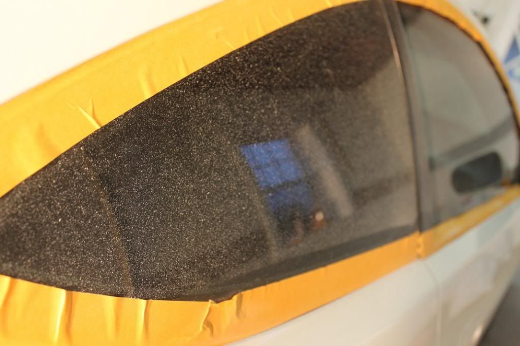

- Aquartz Iron Cut to decontaminate
- Clayed entire exterior including windows

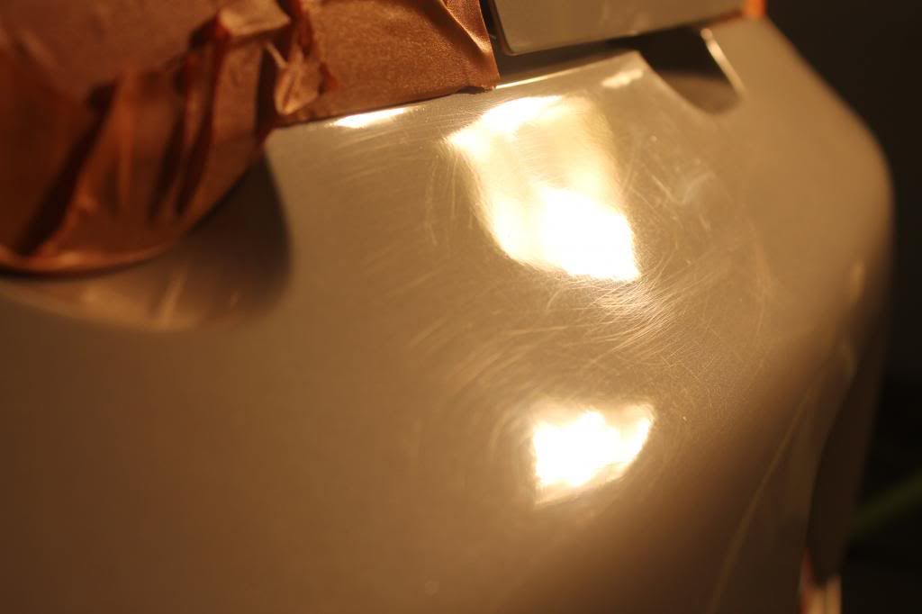

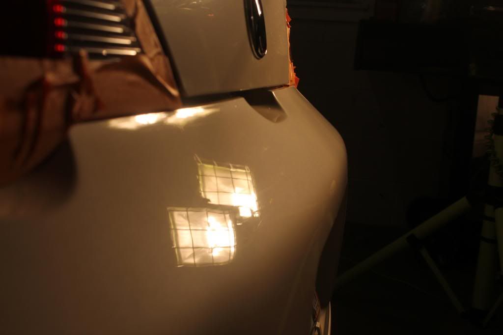

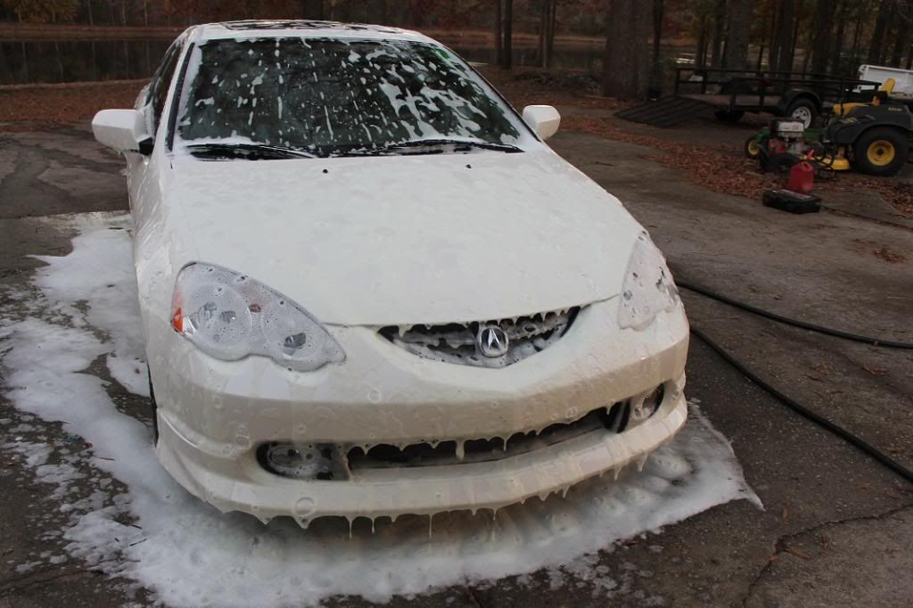

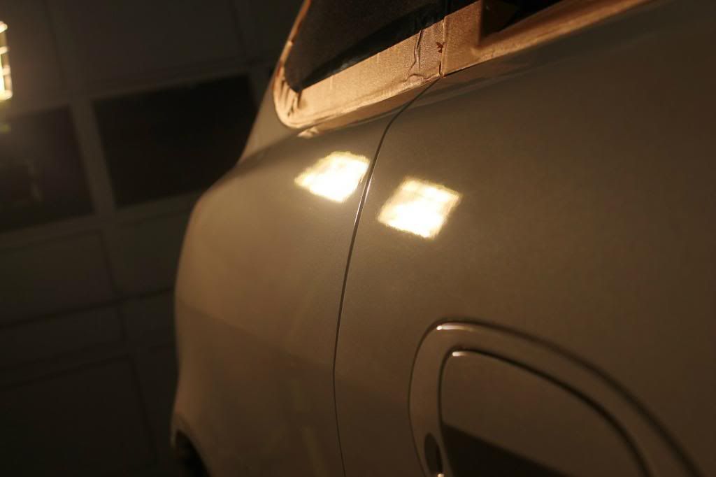

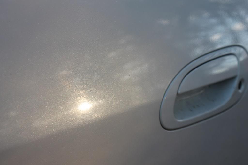

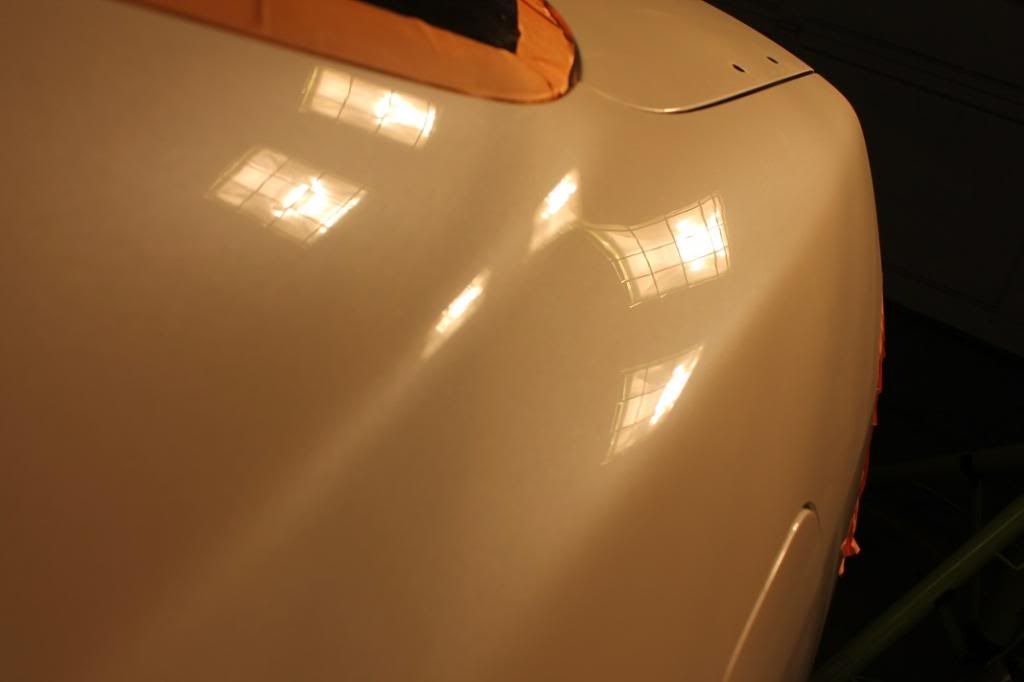

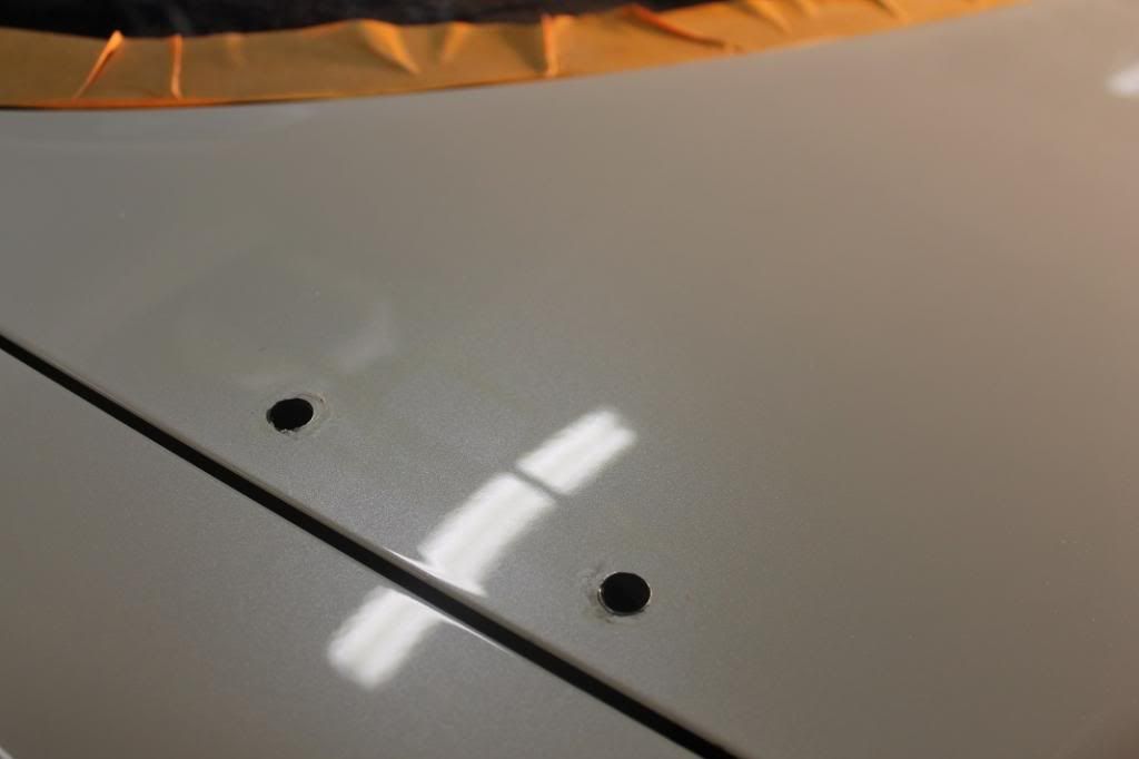

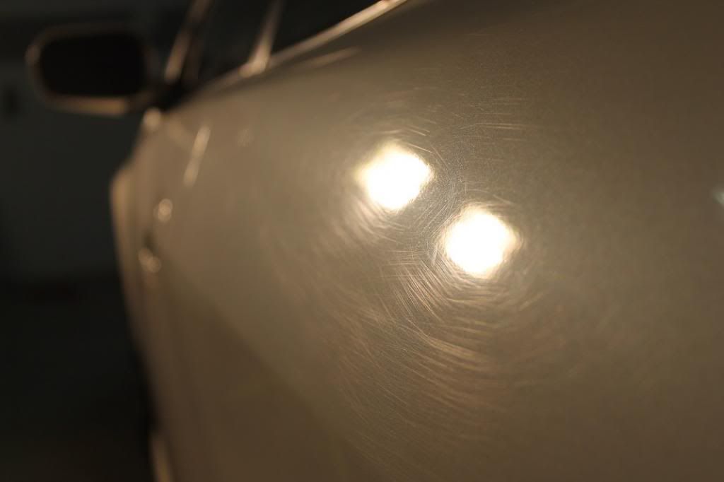

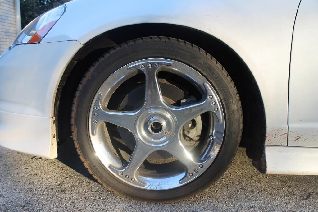

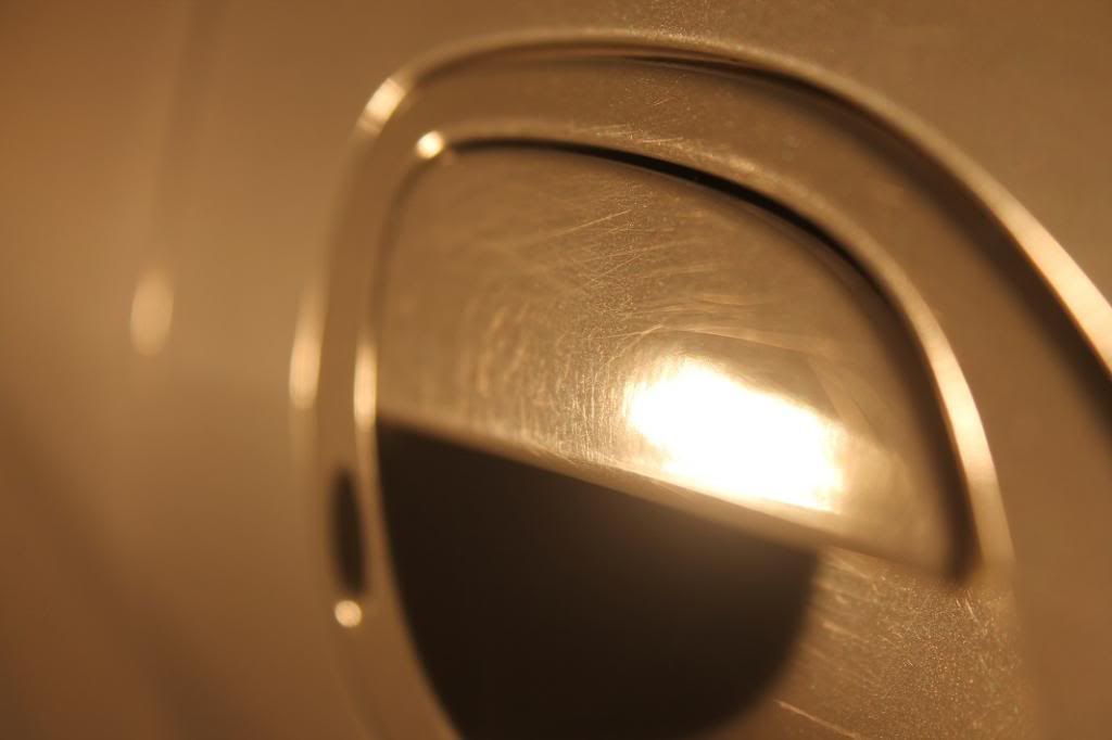

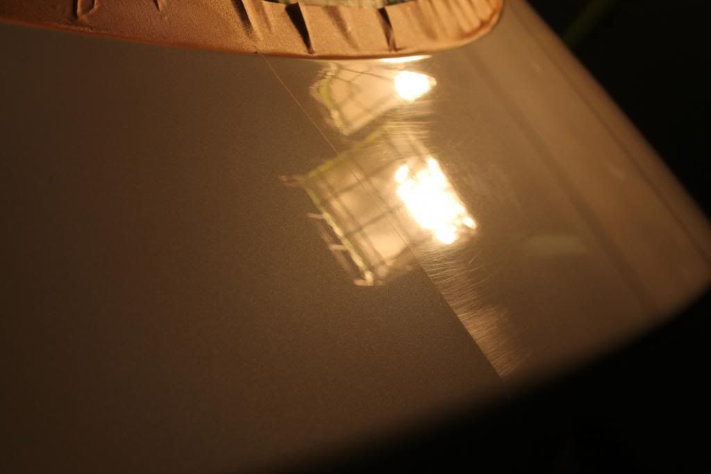

Upon arrival

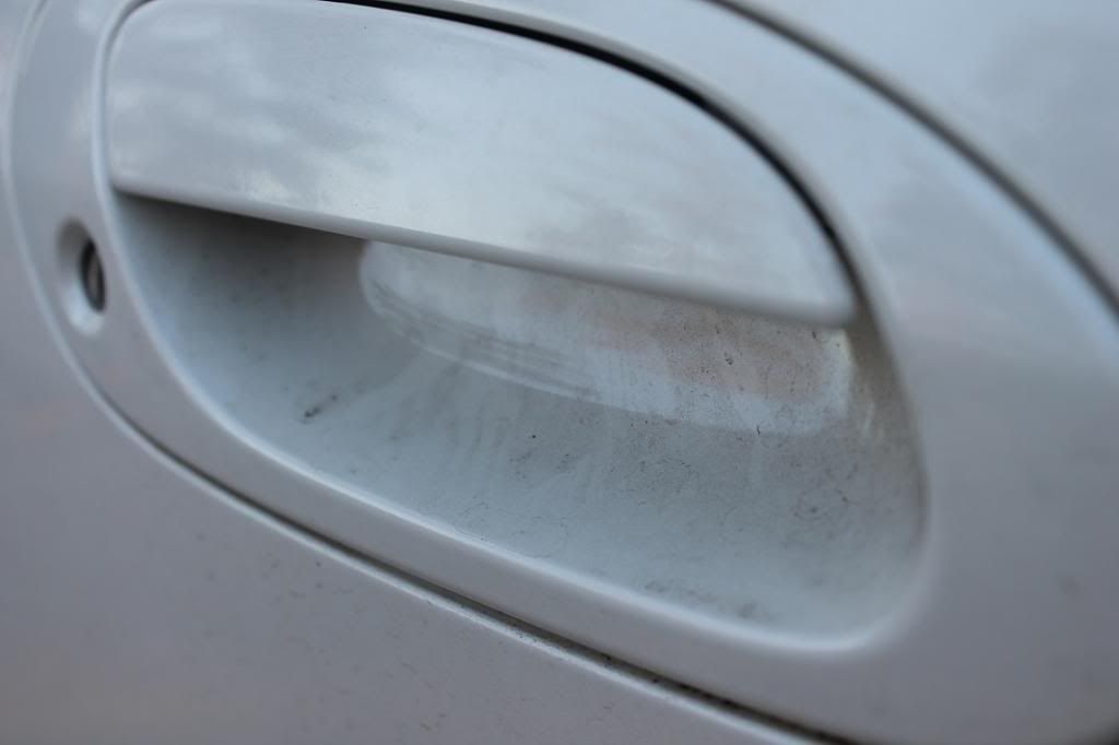

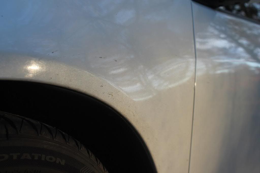

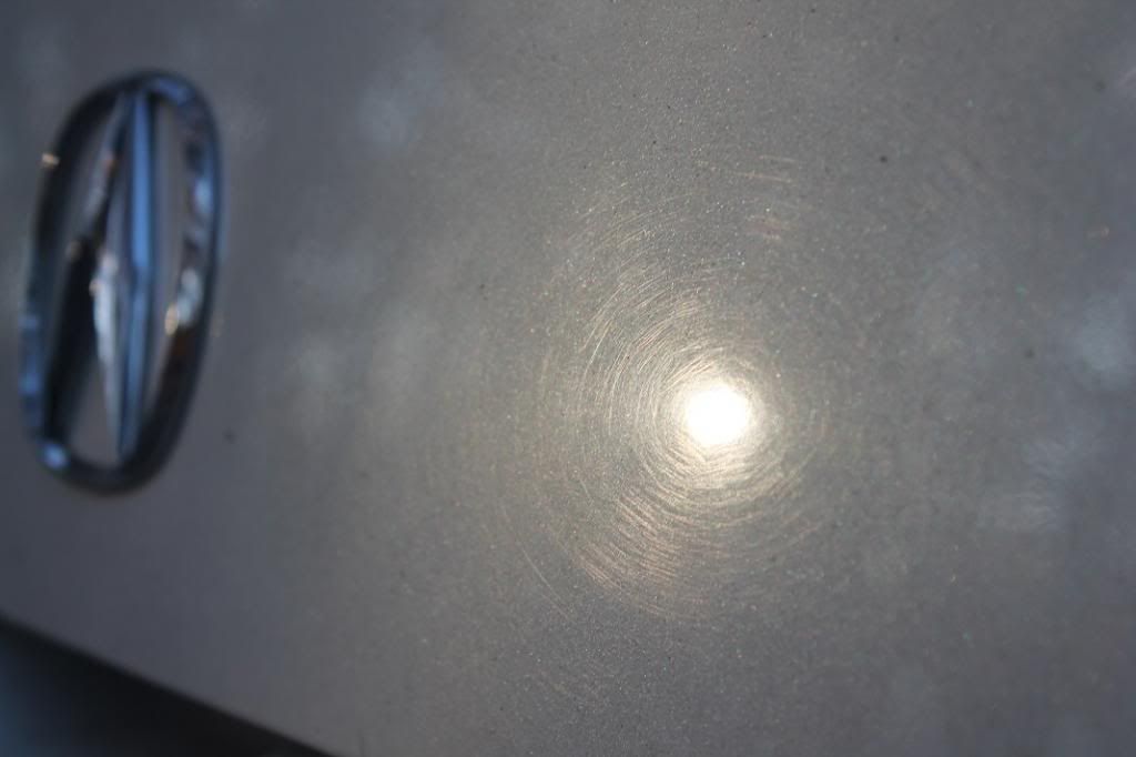

From the initial wash

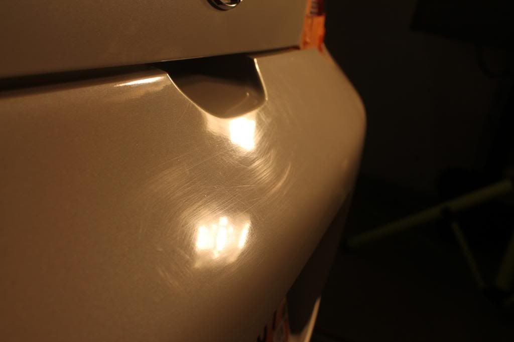

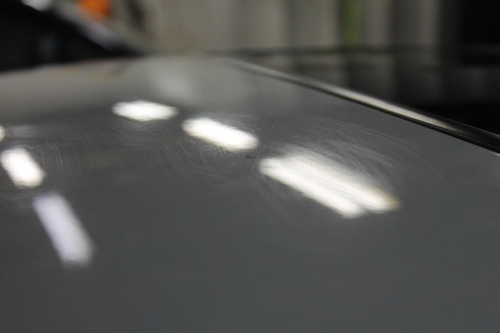

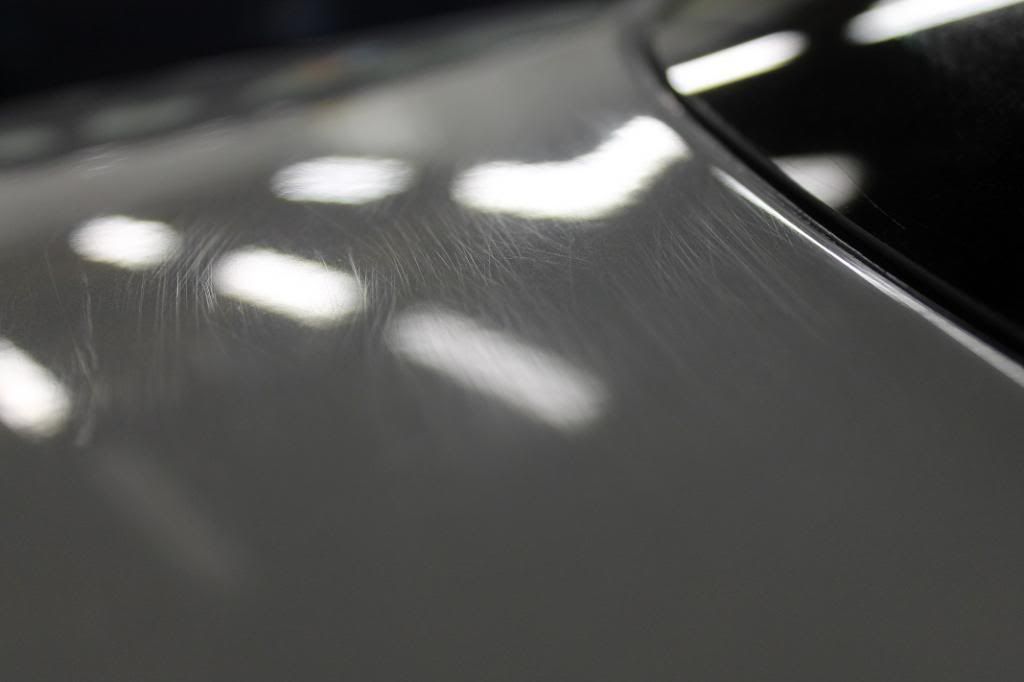

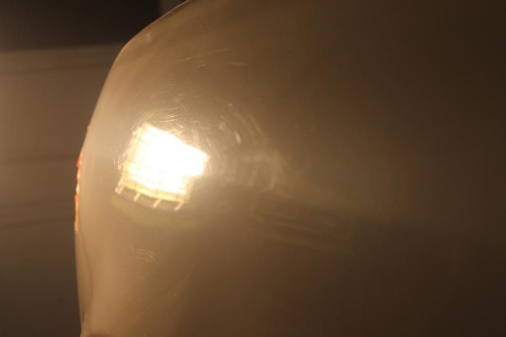

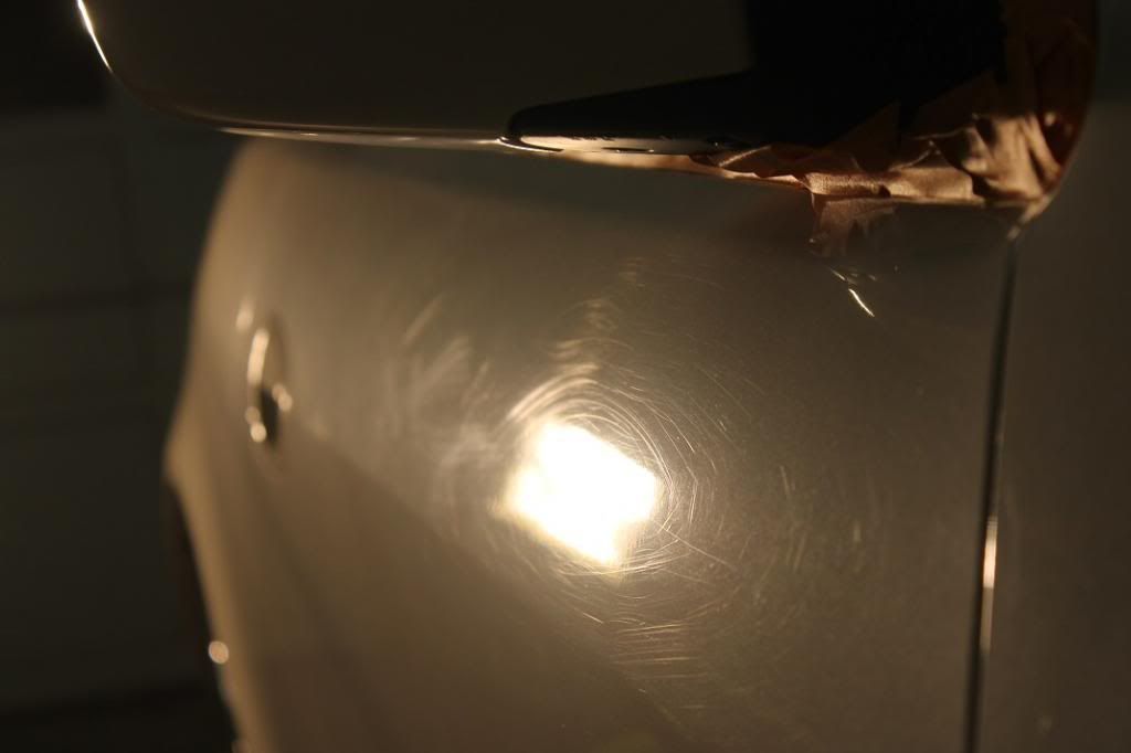

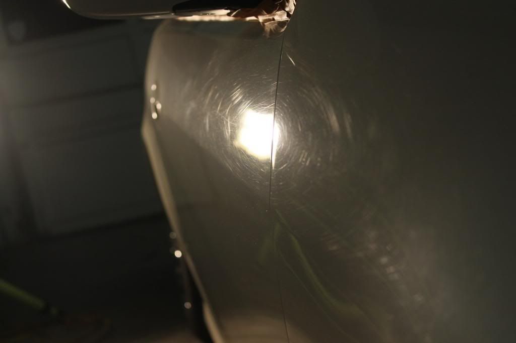

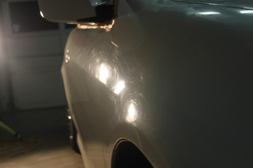

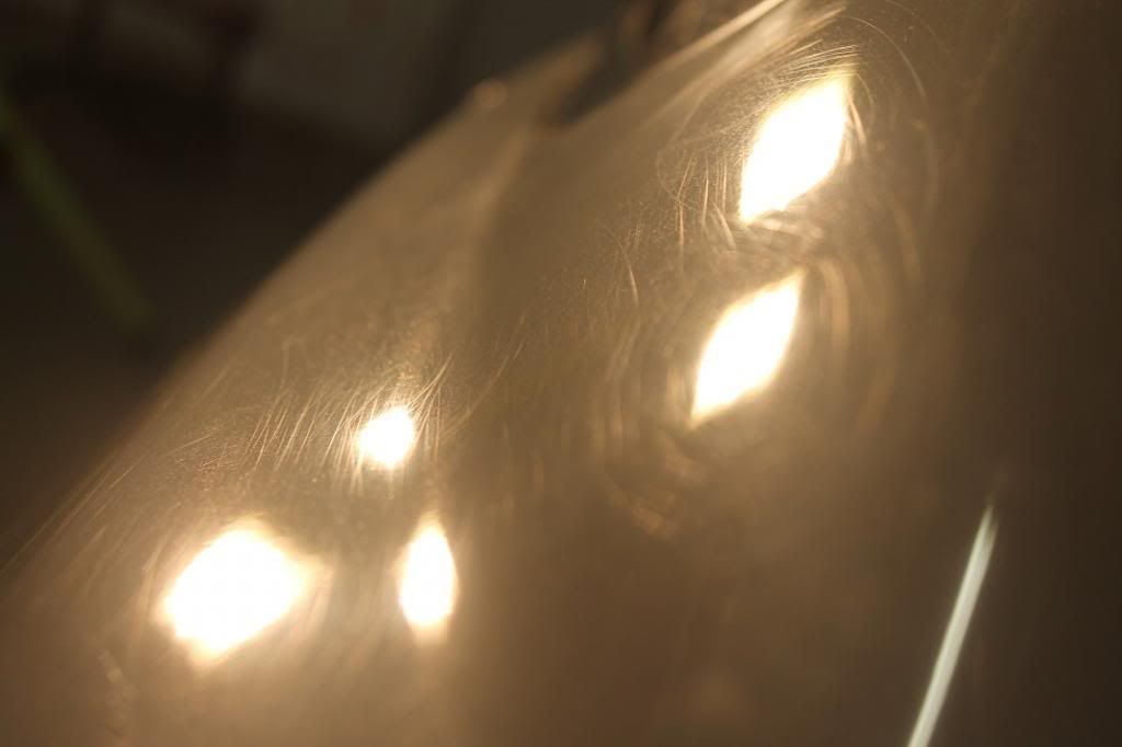

Now you can see the true condition of the paint

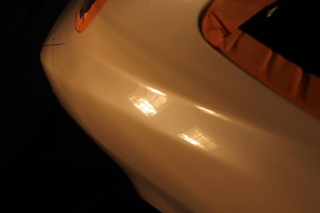

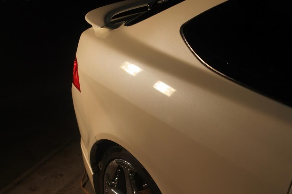

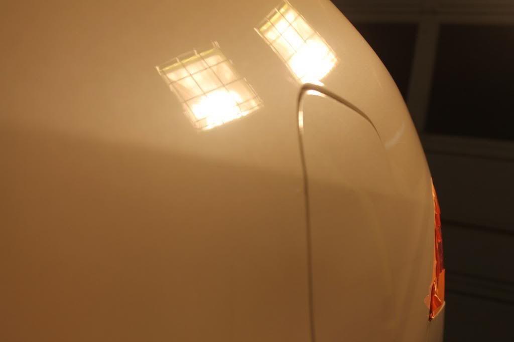

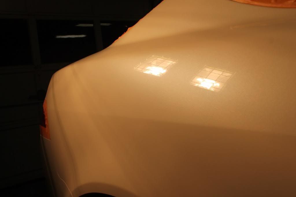

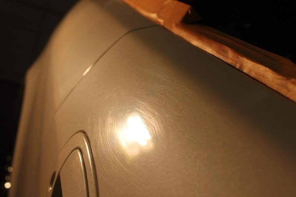

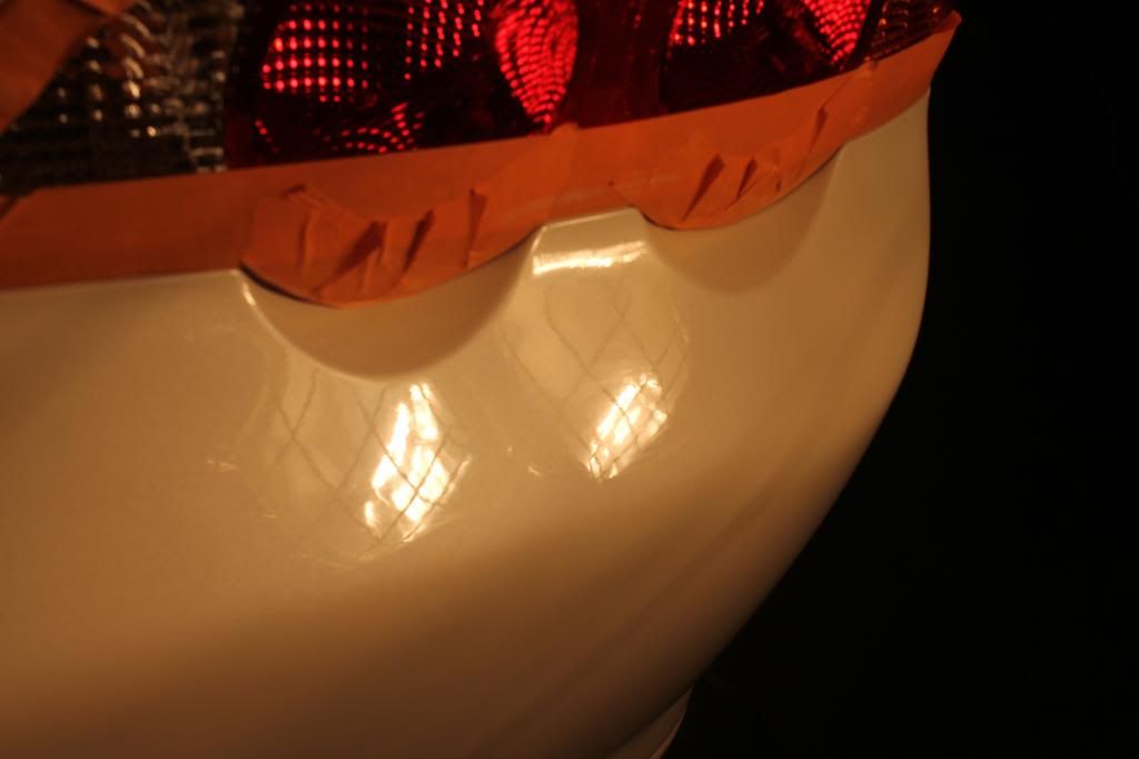

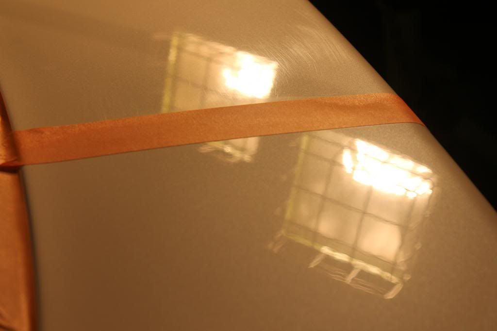

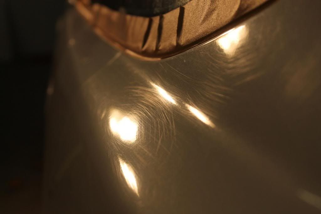

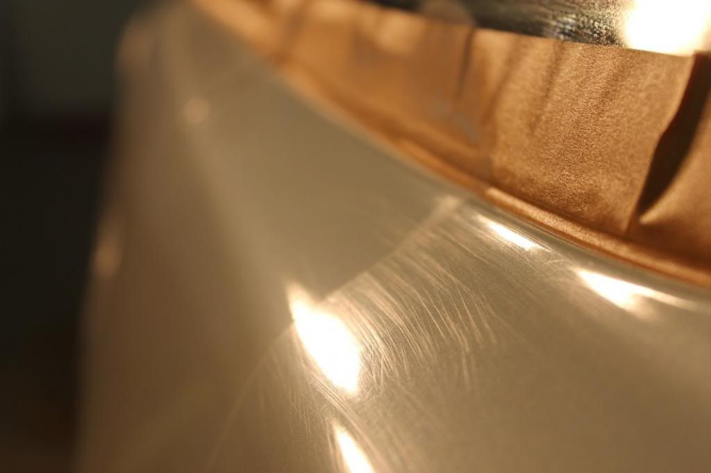

Throughout the process :

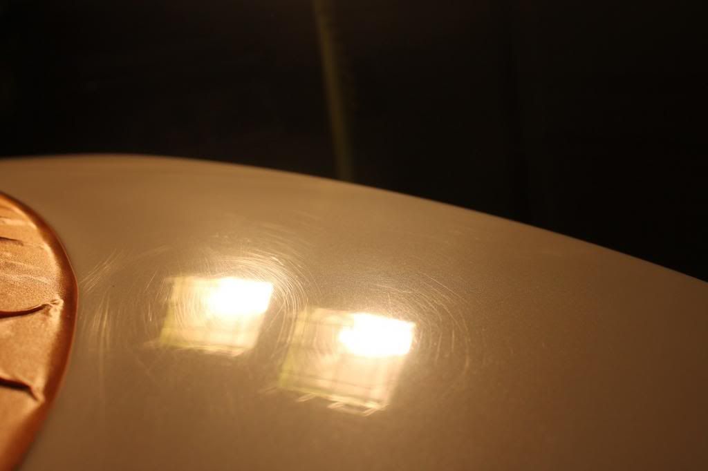

It looked like Charlie Sheen sneezed on the car.

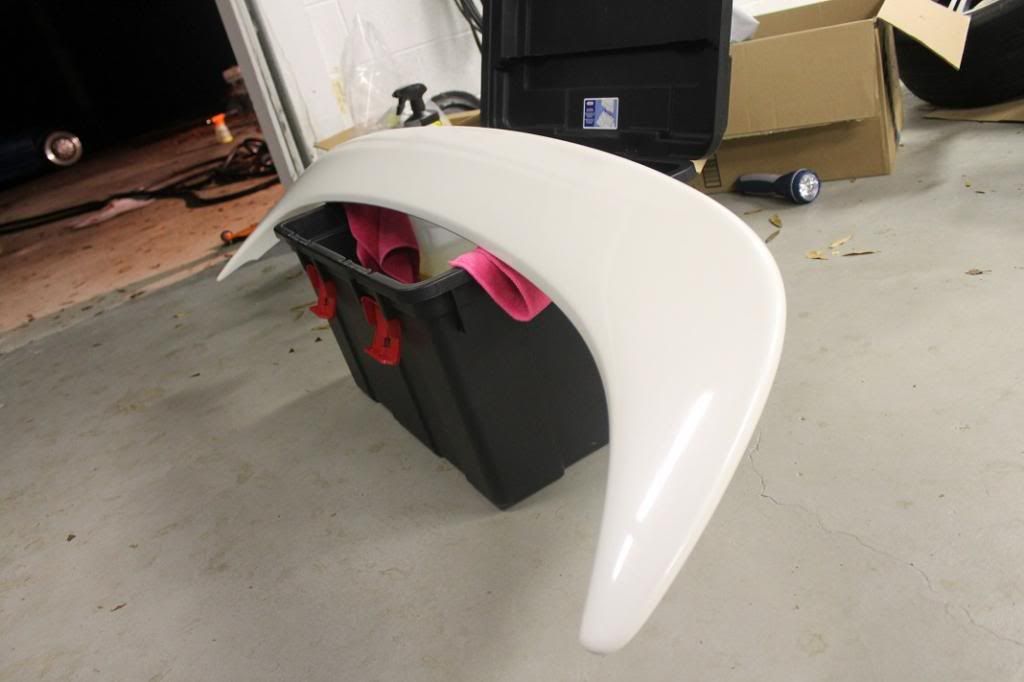

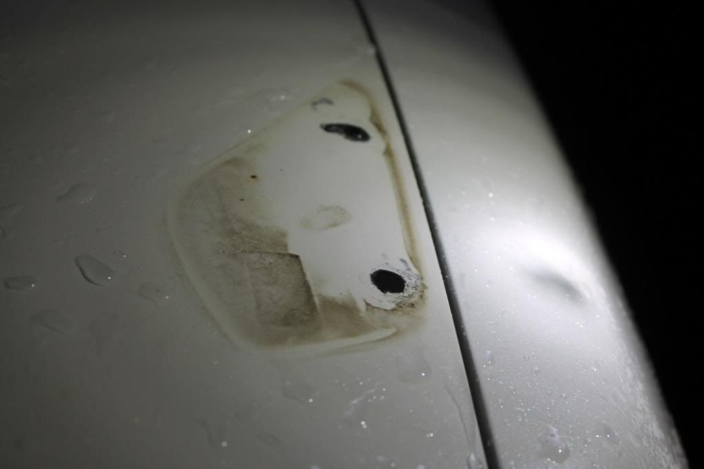

Wing removed to be worked on seperately

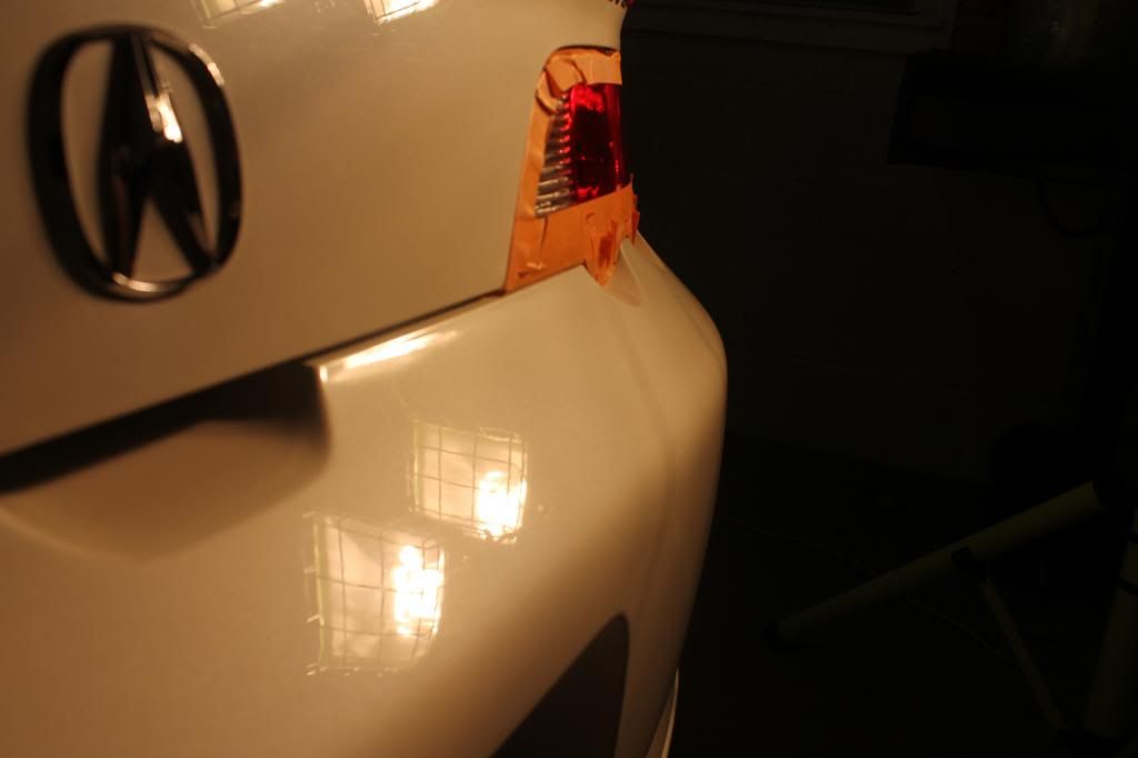

One final picture with the wing reattached.
Amazing resurrection! Even with only 20k it still probably has probably not looked this good in 10 years!

Also, glad to see the removal of the rear spoiler. I'll be buying some pads to do a complete correction soon, and had been debating how I wanted to tackle that area - nice to see that removal is so easy and will make polishing that paint a LOT easier.
