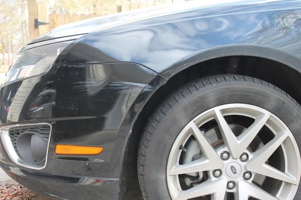

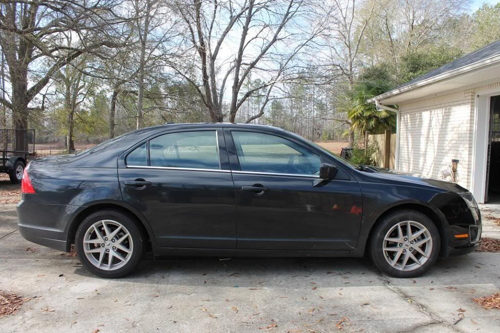

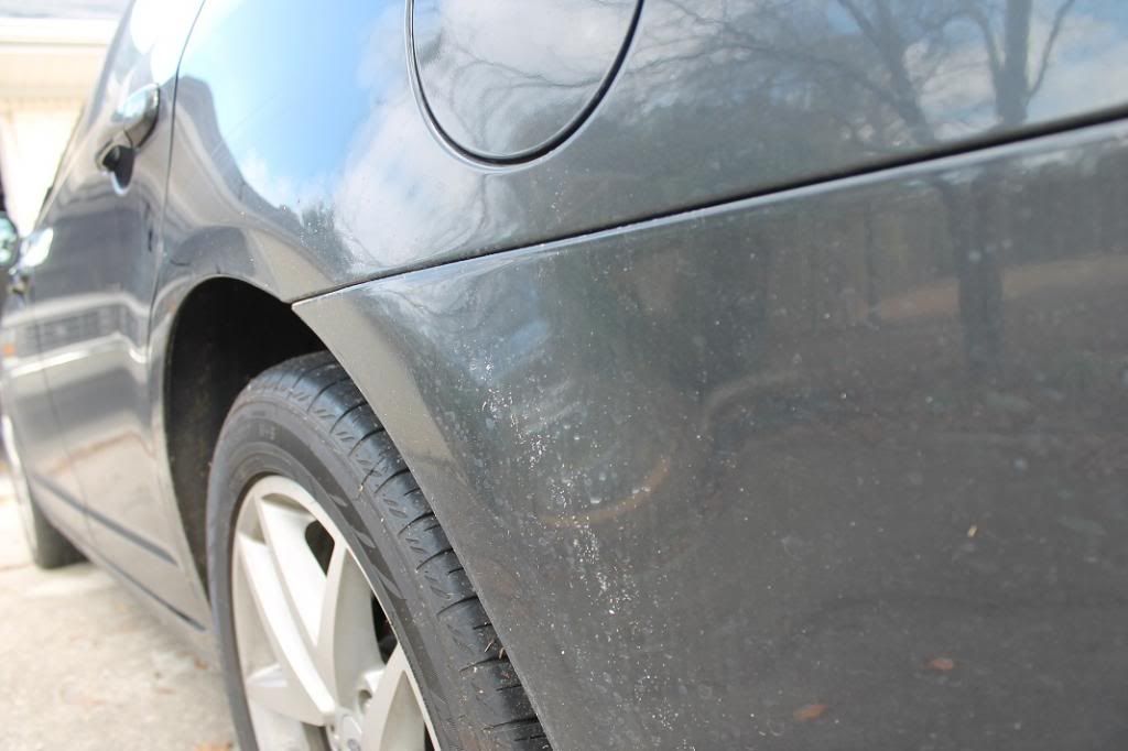

This vehicle was in a fender bender and quoted $900 for damages. After receiving the insurance money, the client brought the vehicle straight to me and after wet sanding + correcting the area, it looked brand new.

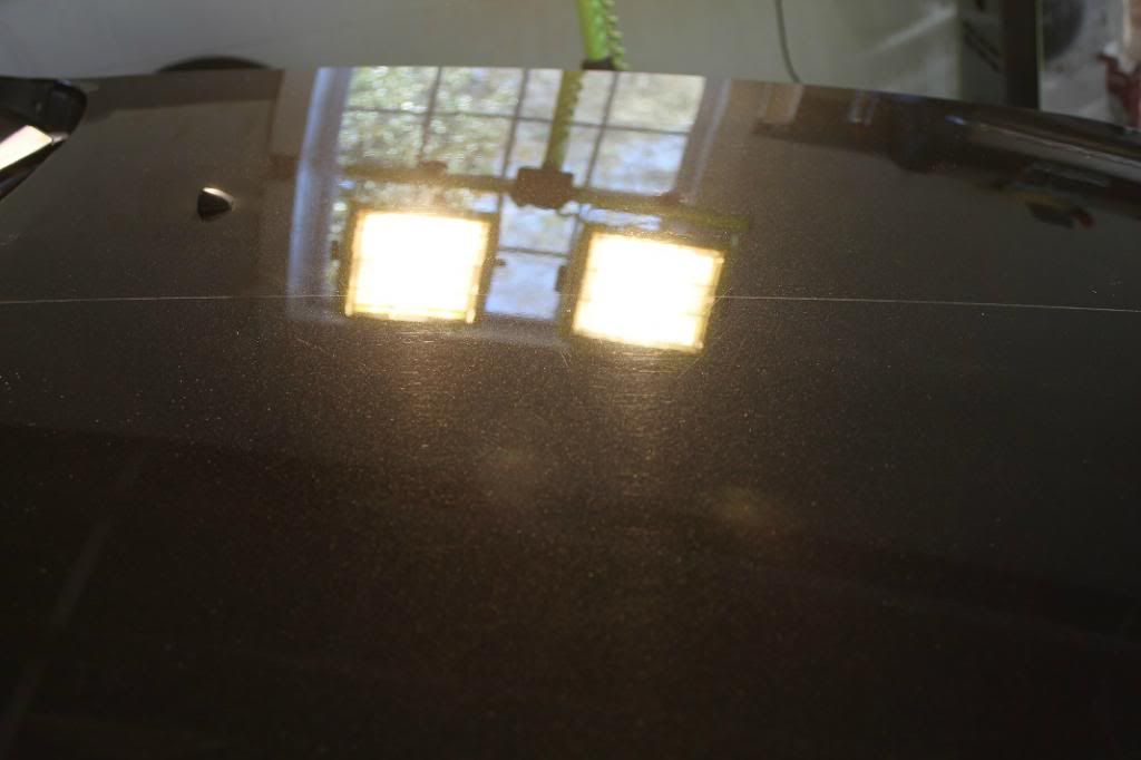

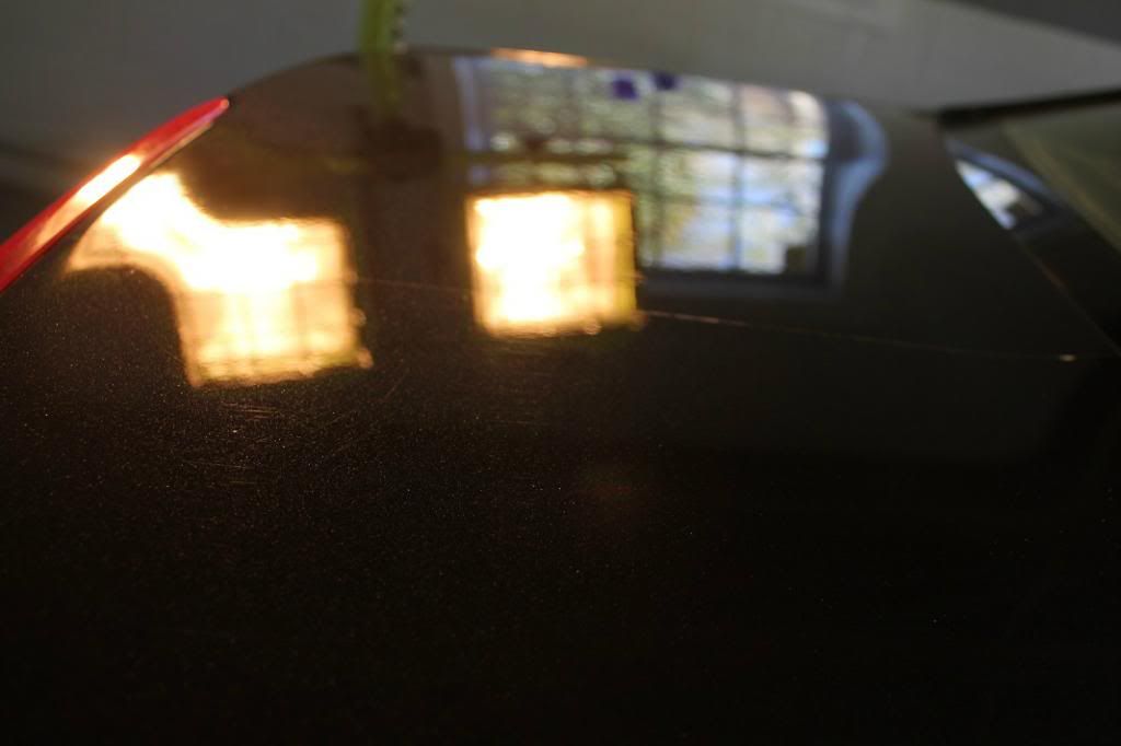

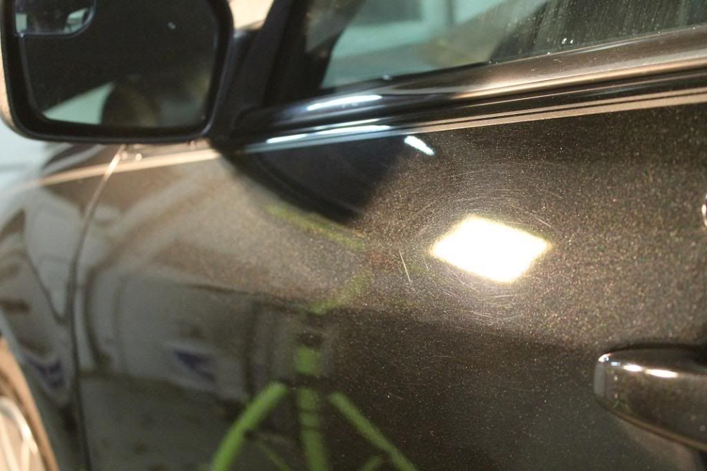

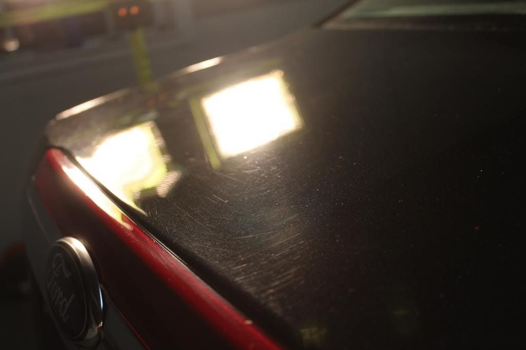

- Damaged area wet sanded & repaired w/ various supplies

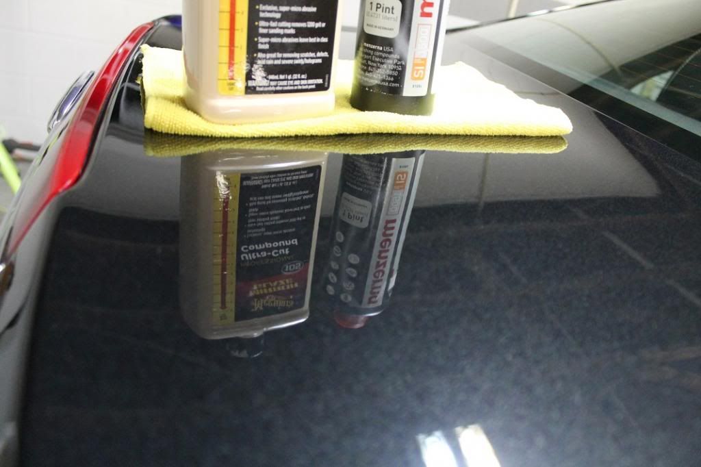

- 2-step - m105 -> menz sip

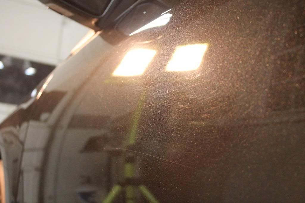

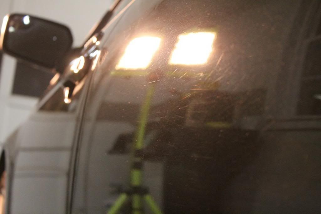

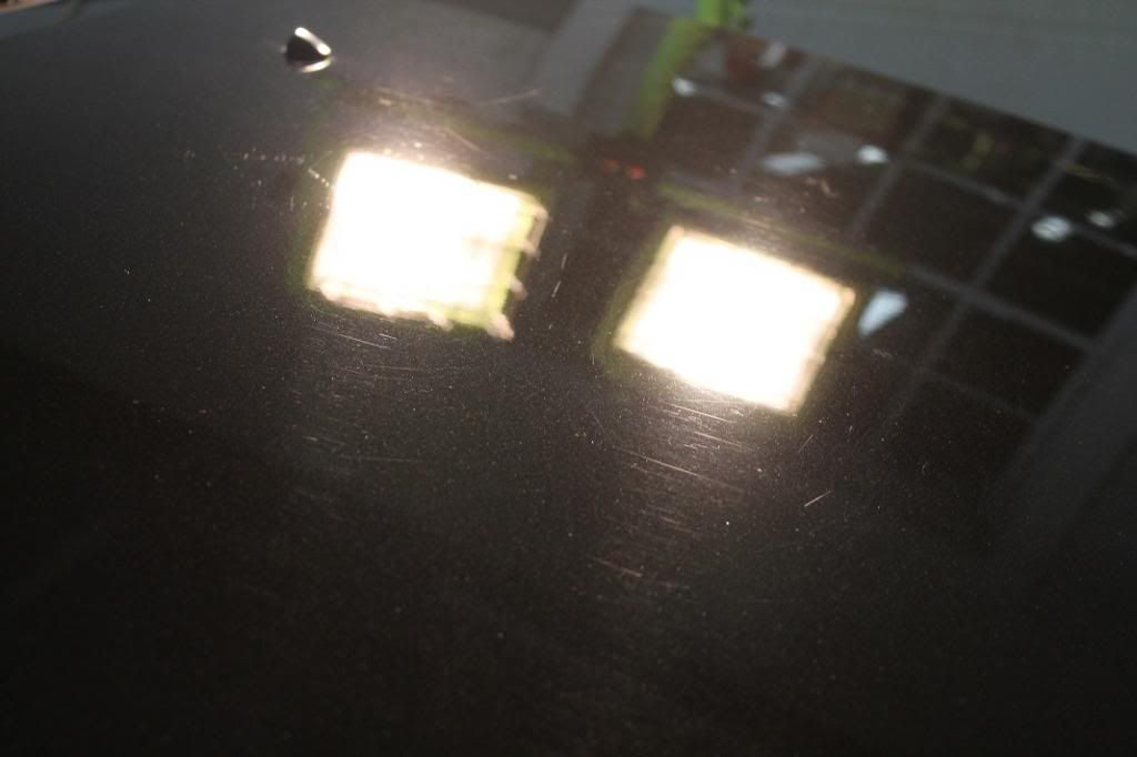

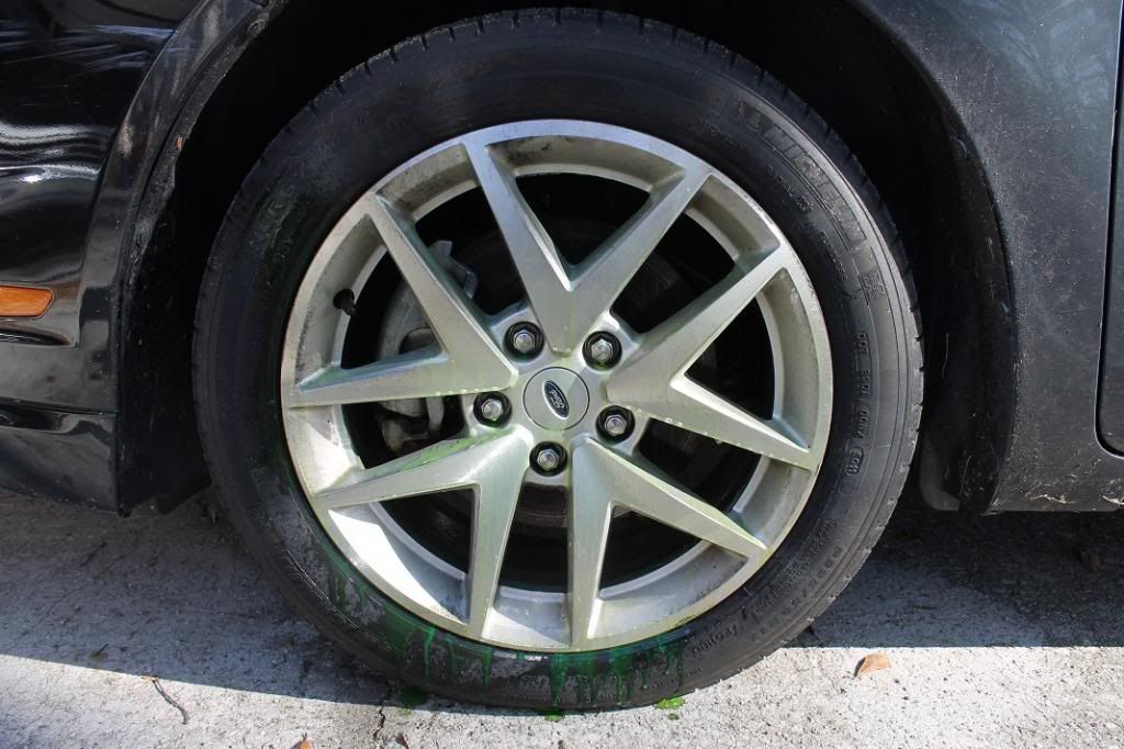

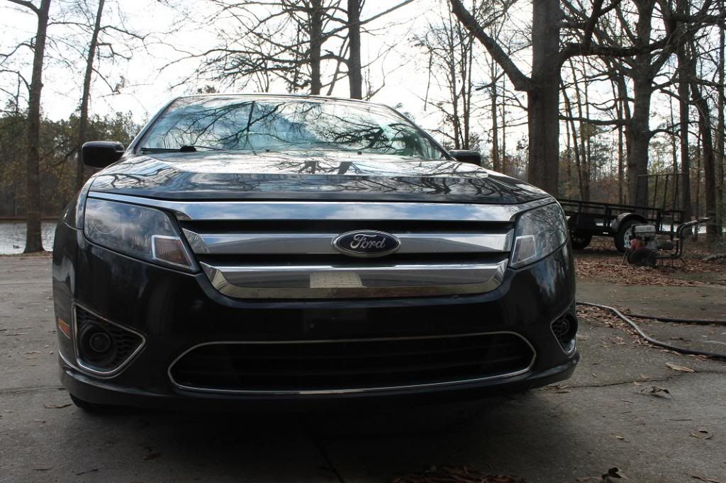

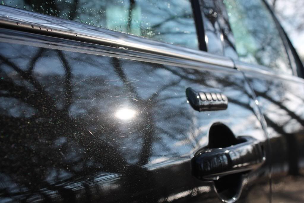

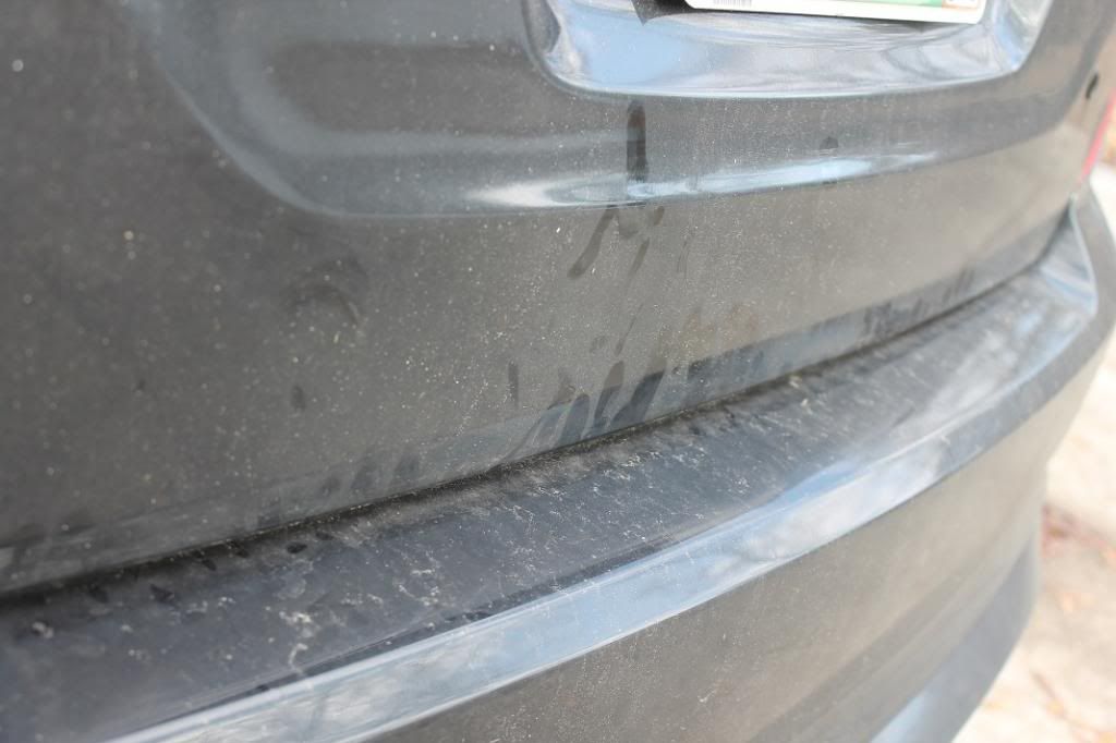

Upon arrival

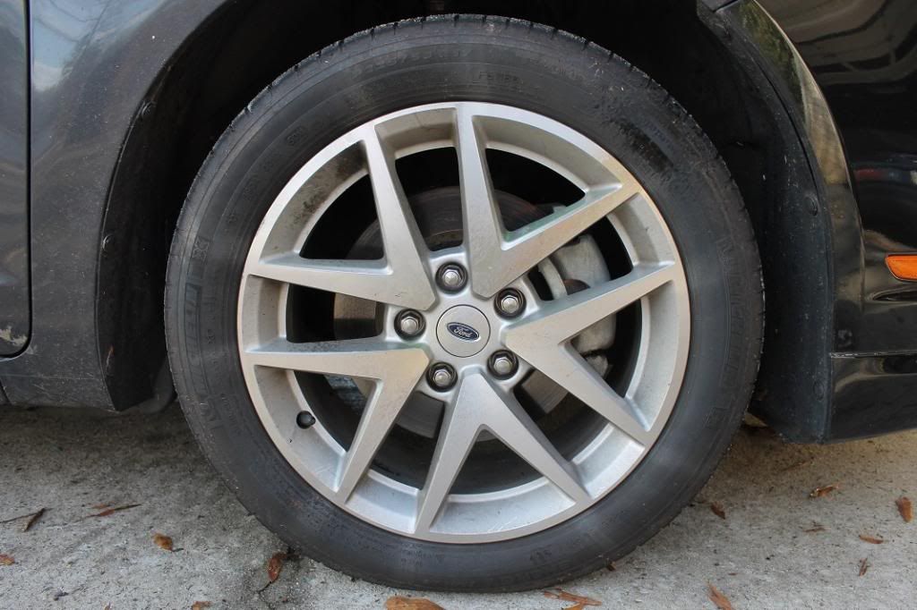

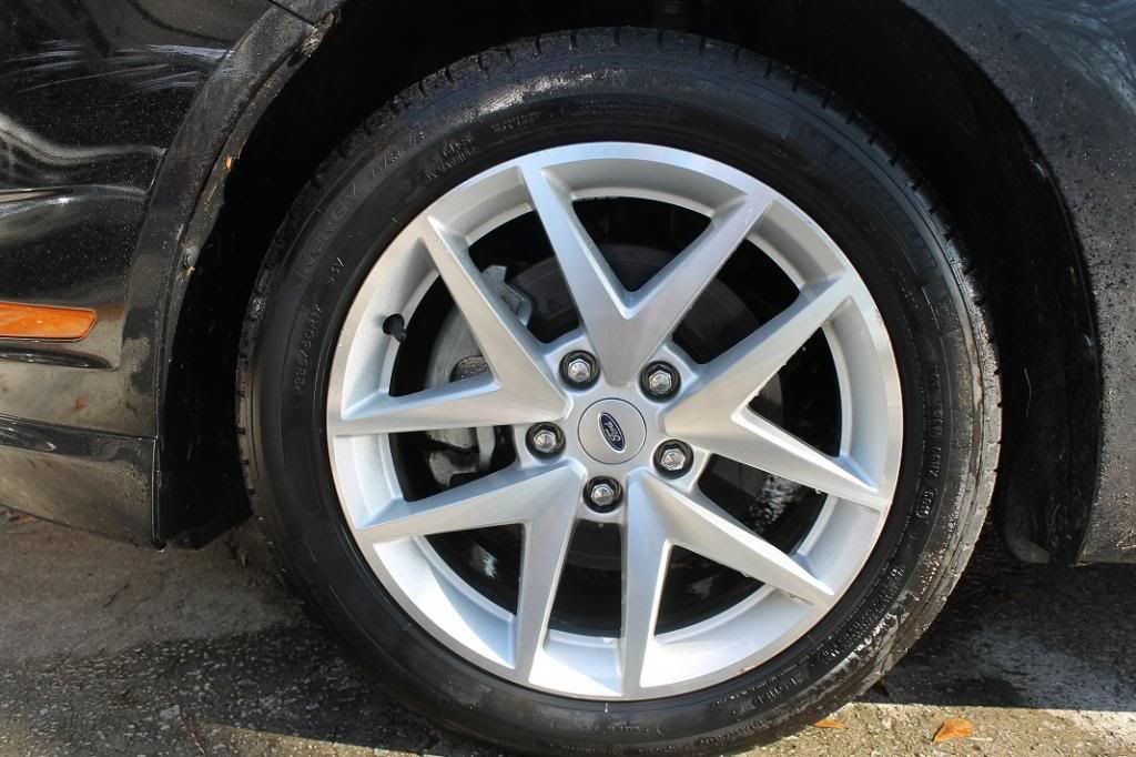

Sonax is my favorite wheel cleaner hands down.

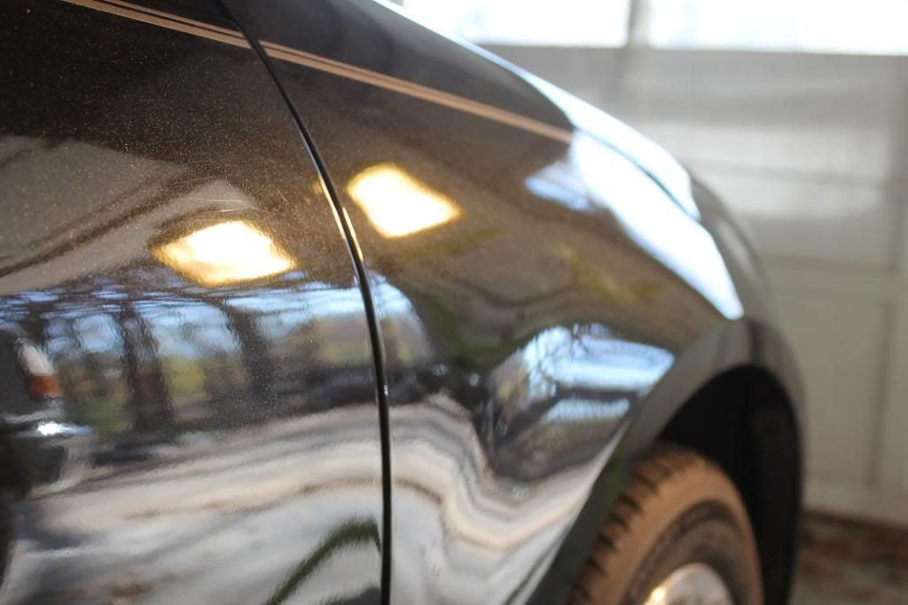

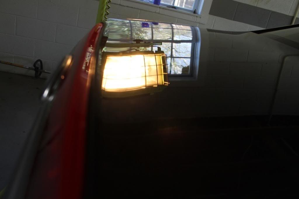

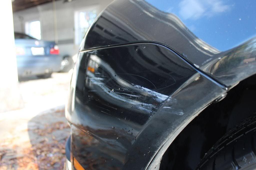

Damage taken care of first

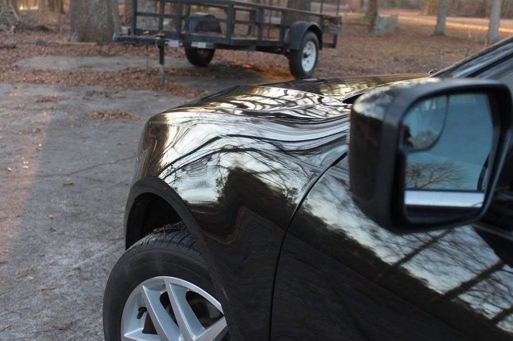

Front fender done, door not.
I swear this car sparkles more than Twilight vampires.

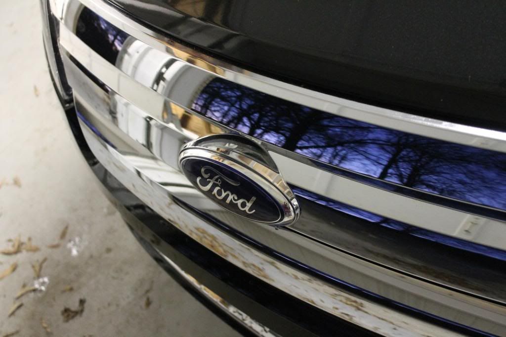

This little guy scared the bajesus out of me while I was polishing the bumper, crawled right out on the grill.

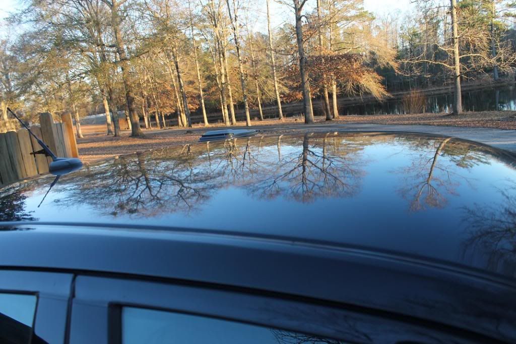

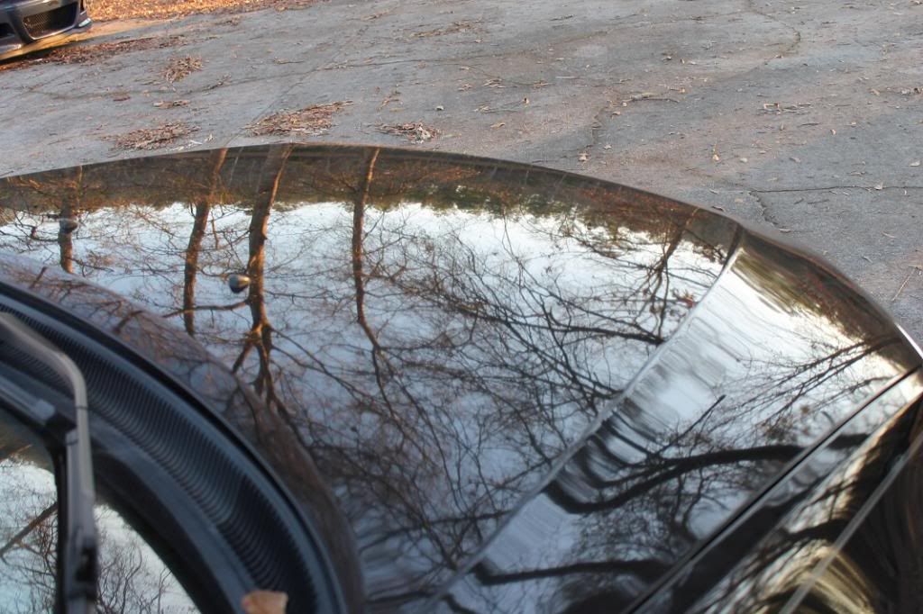

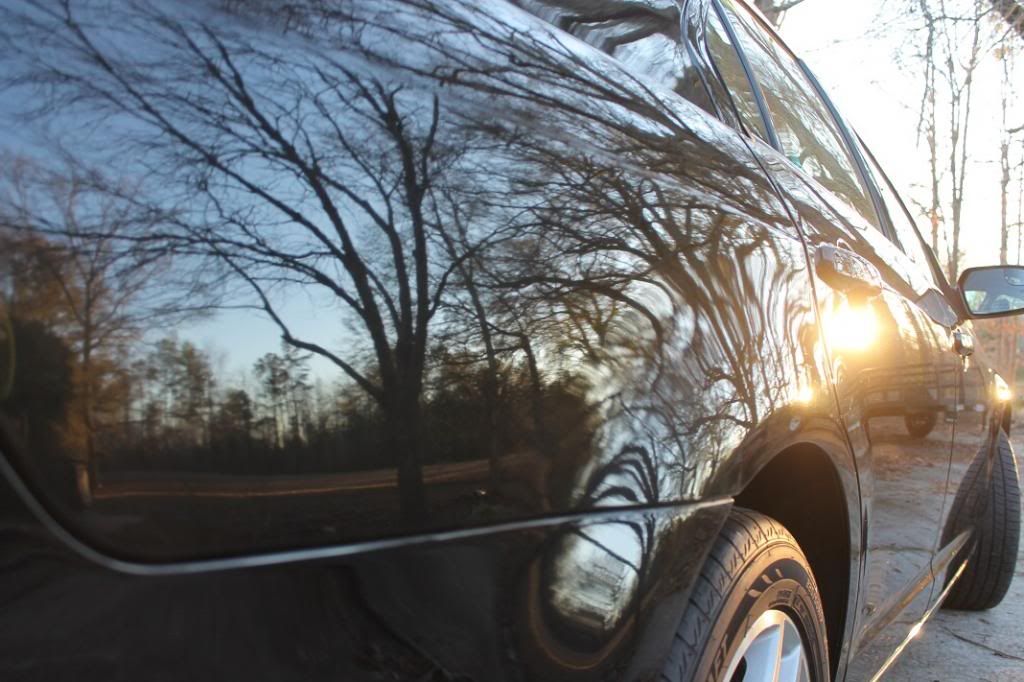

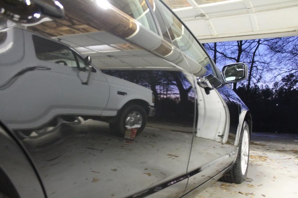

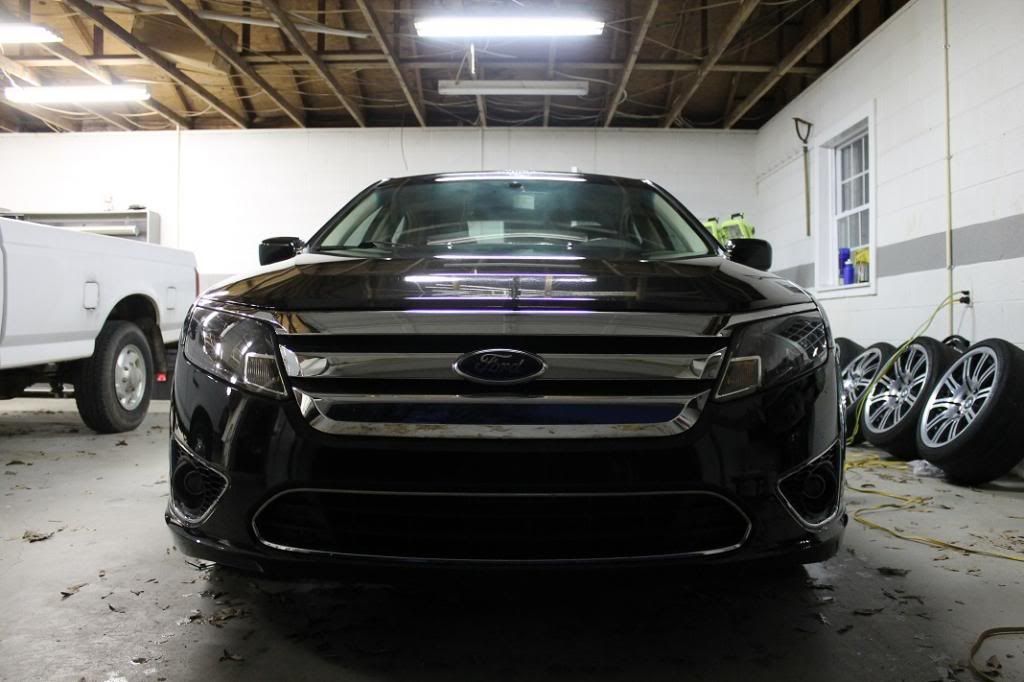

Results
Looks great. Nice job on getting the damage taken care of. Ultimate wax is good stuff.
