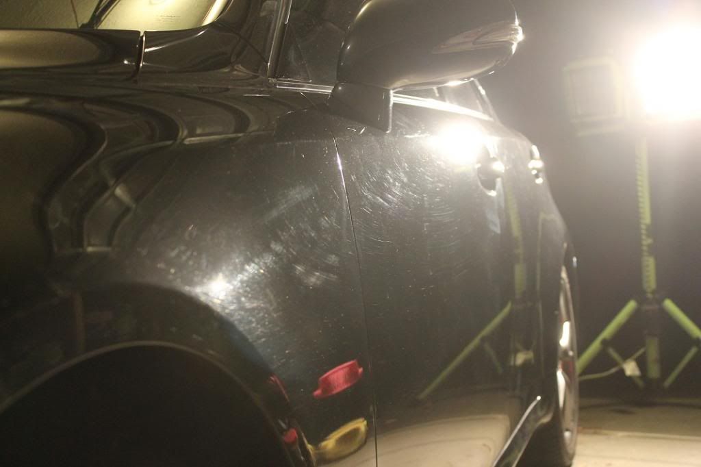

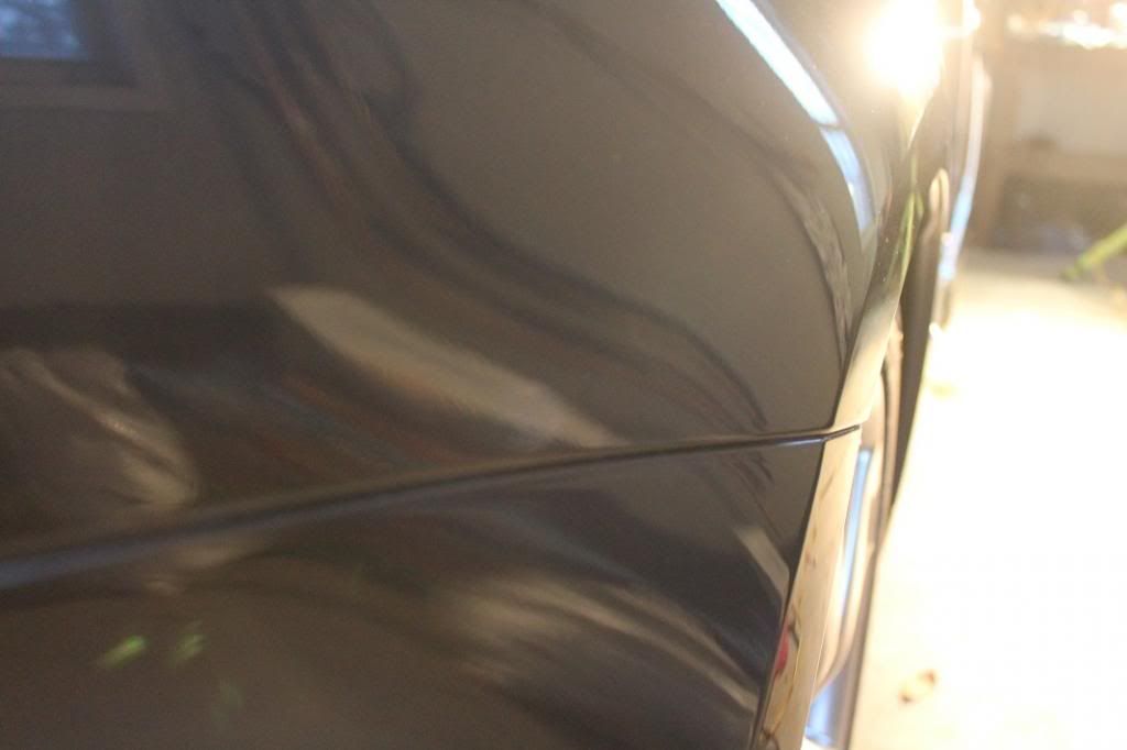

This job required a two hour drive + an entire day of work, but overall I'm pleased with the results, the owner of the vehicle was as well. On to the good stuff :

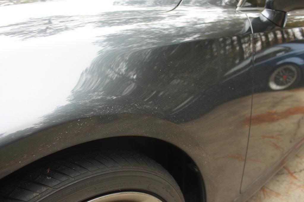

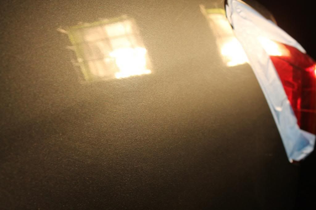

Upon arrival

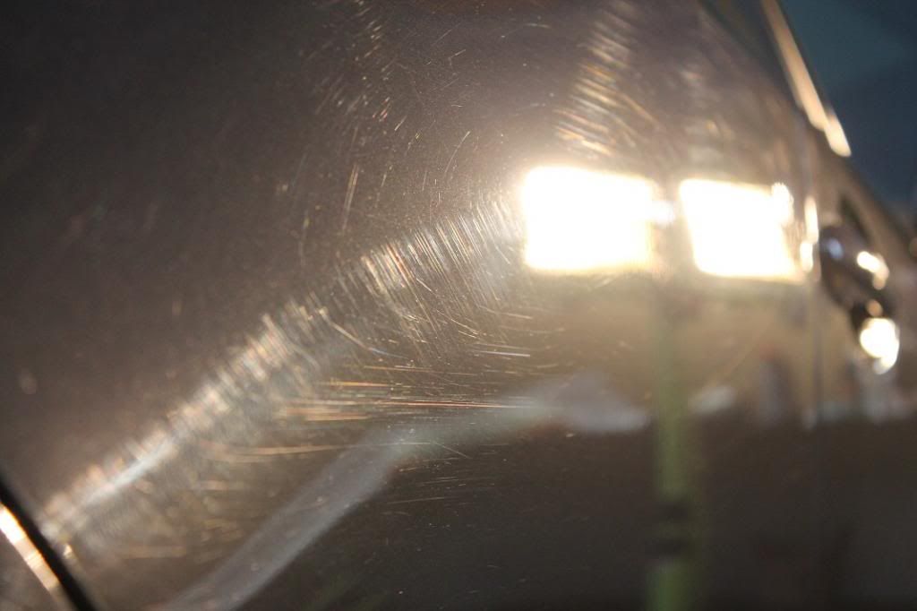

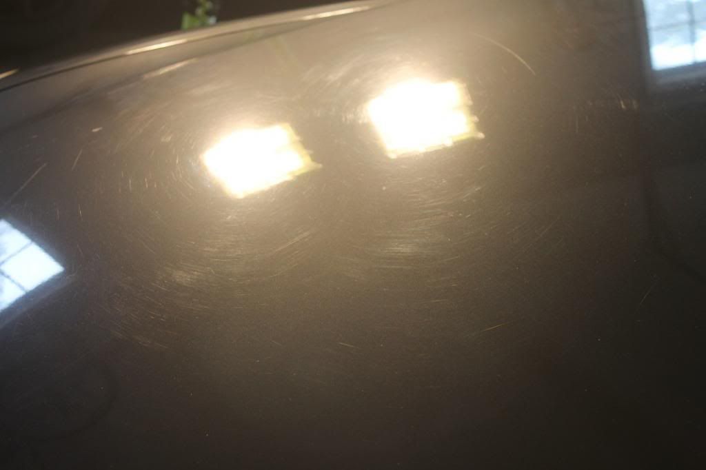

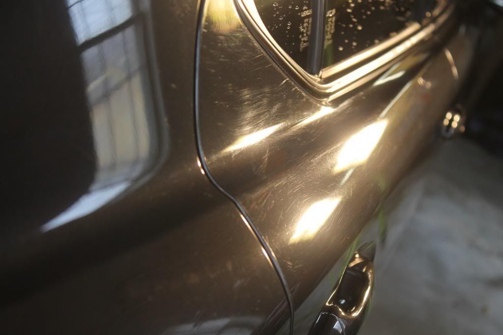

Initial pictures. Paint wasn't too bad but definitely took some work and elbow grease.

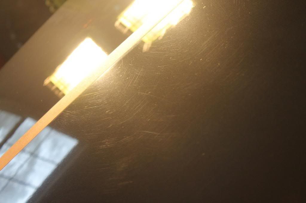

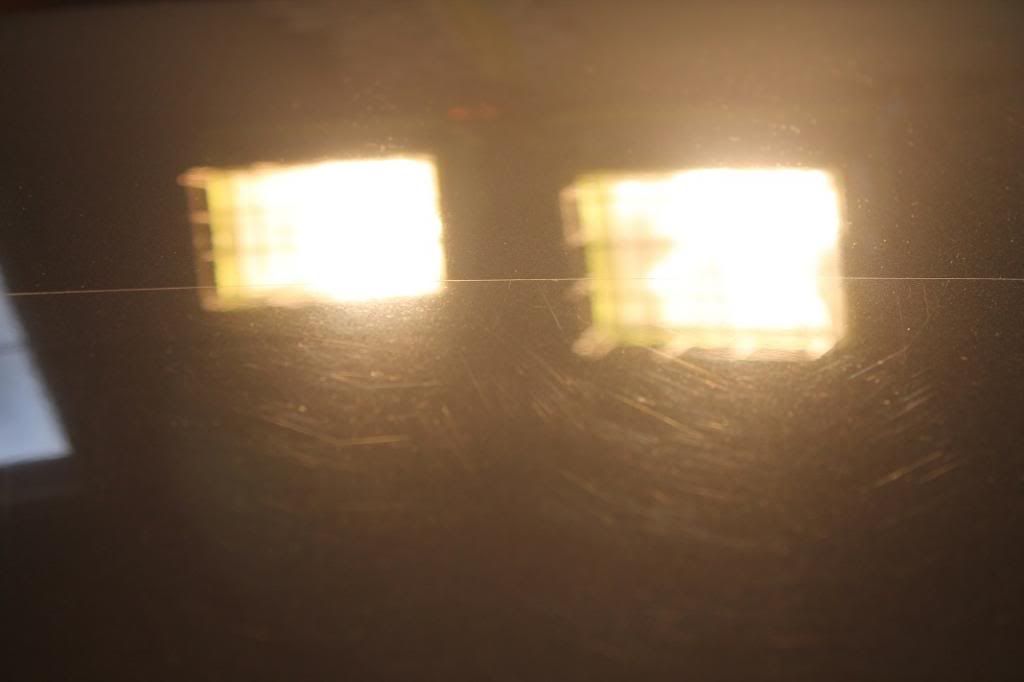

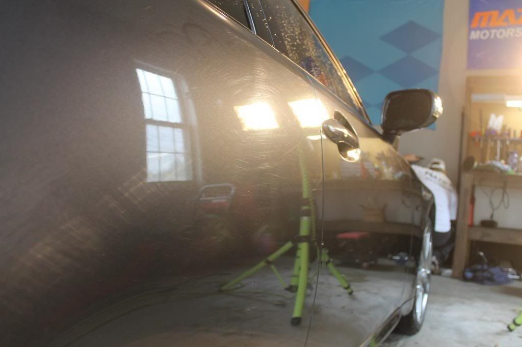

Onto the correction :

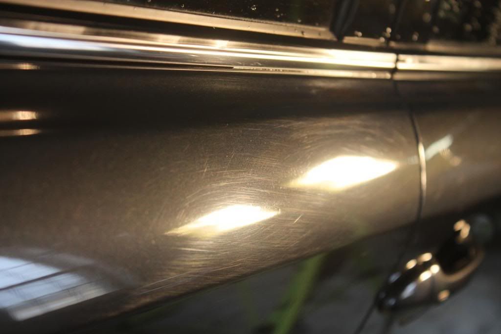

Pretty scratched up right here, gave this area some extra attention.

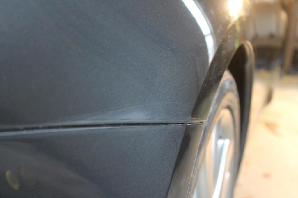

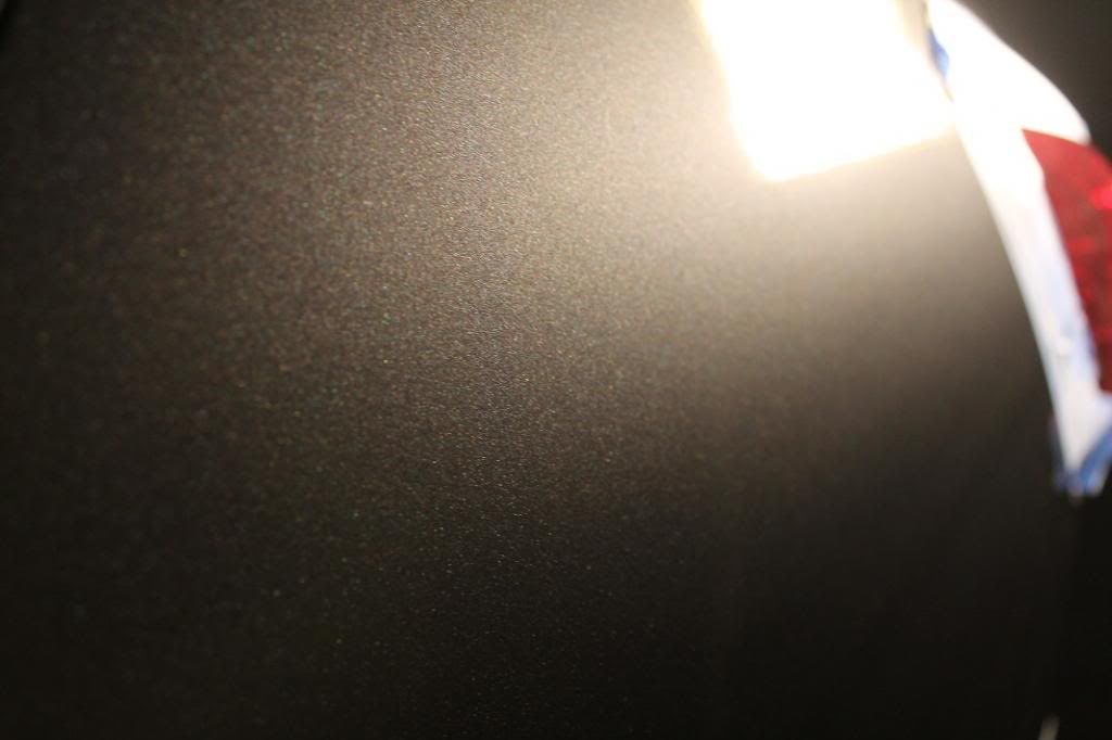

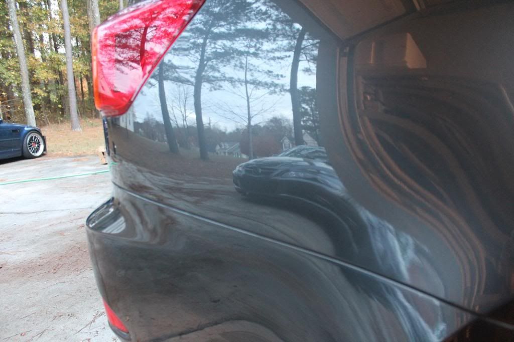

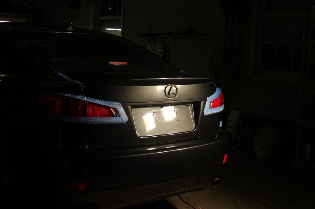

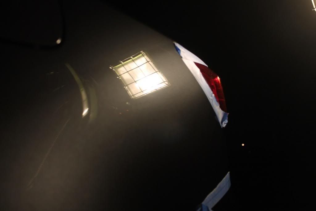

One final picture to display how aggressive this vehicle is.
Very nice turn around. We have some great detailers here on AG!
Came out real nice. Pads/Products?
Whoops, forgot to include that in the initial post.
M105 w/ Orange pad
Menz SIP w/ Green Pad
Menz SF w/ Red pad
Megs Ultimate Liquid Wax w/ Black pad after being re-washed to remove polishing oils.
