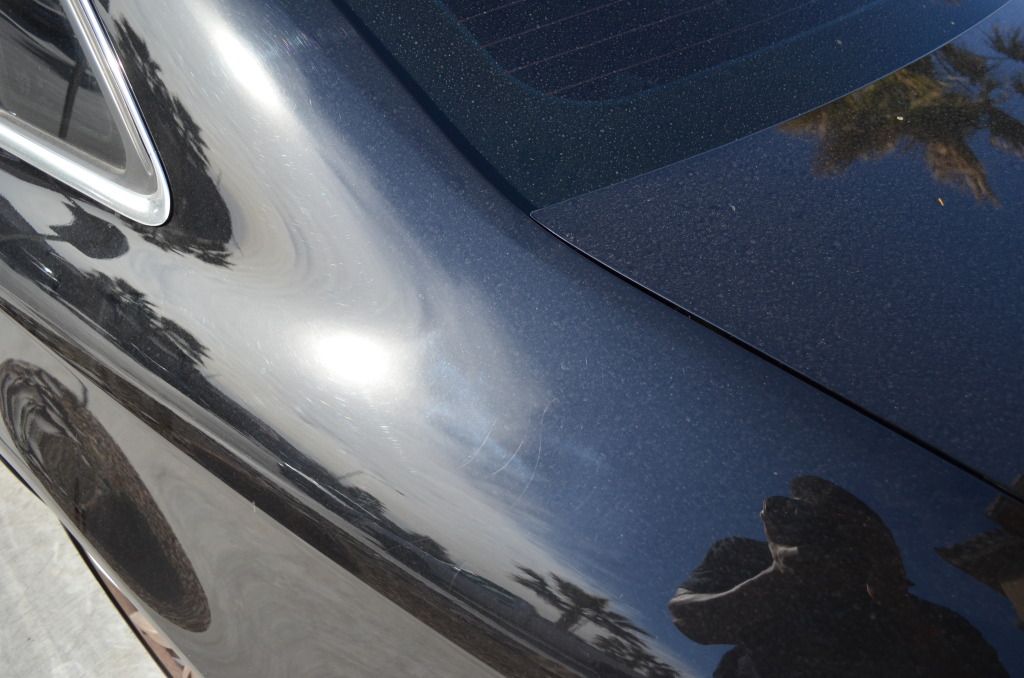

After Wash and IPA wipedown. Showing HARD water spots

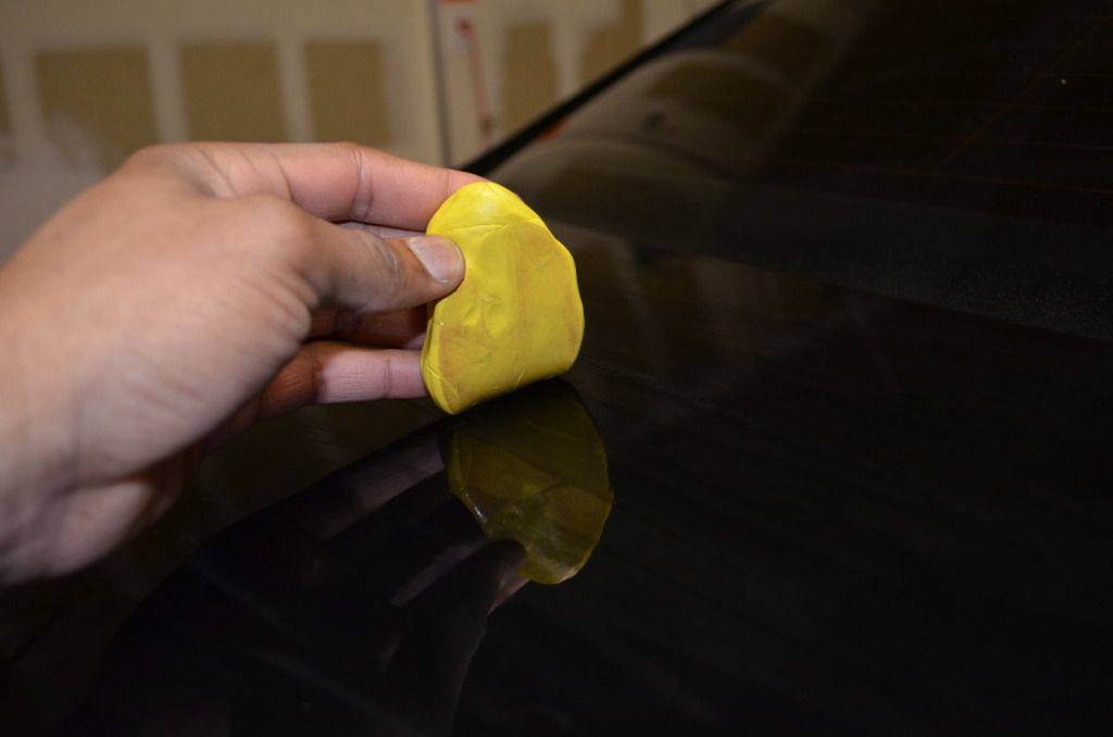

Clay

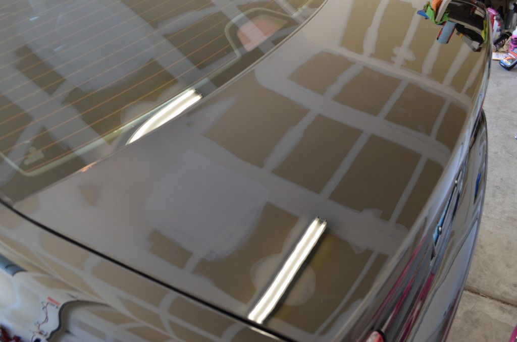

Now the fun part

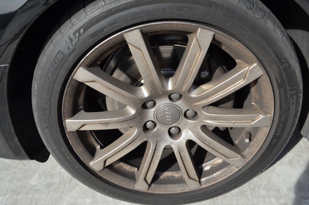

It even has silver rims now.
Thanks you. I was very happy to see silver again lol.

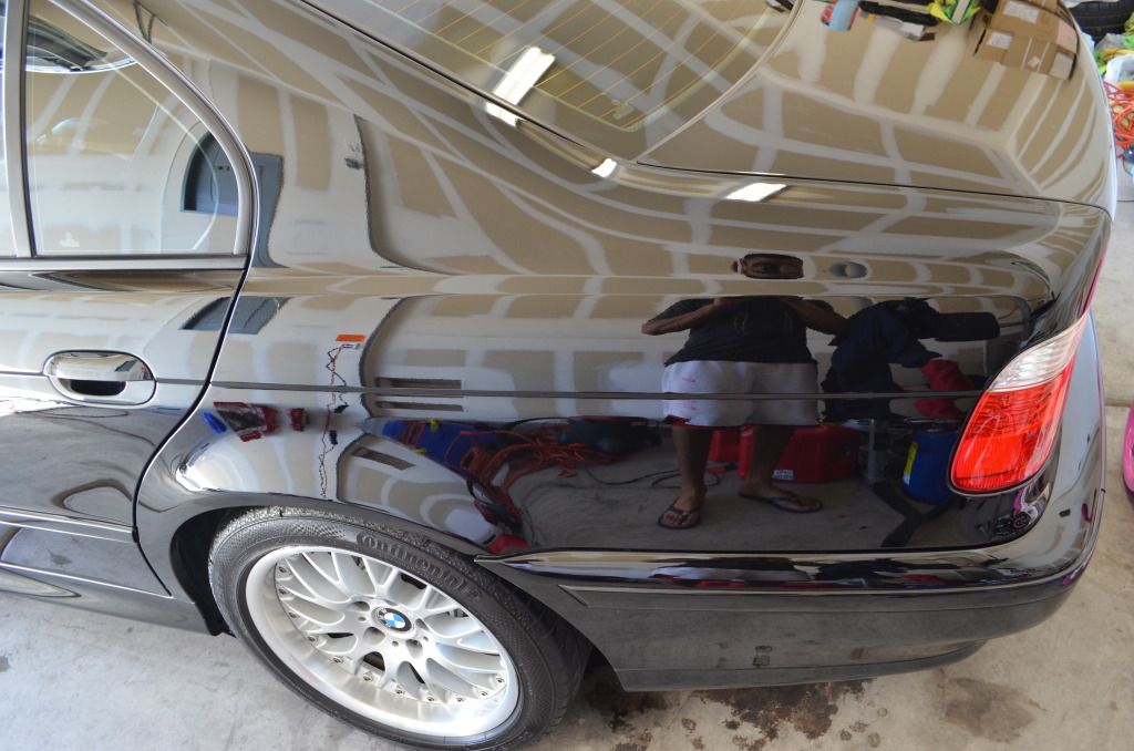

The reflection pics of your BMW are amazing, butter wet wax is great.:dblthumb2:
I'm going to say the only people who drive black audi's are the ones who can afford to, if I don't feel like like driving the black one then ill drive my silver A8, weather plays a big part in making that choice. Black is a part time job that's for sure.
Thank you sir. I love the butter wet wax. I tried the Blacklight under the butter wet on the Audi to see if it gave it an extra pop, but there is really no need for it. It also takes damn near zero effort to remove.
