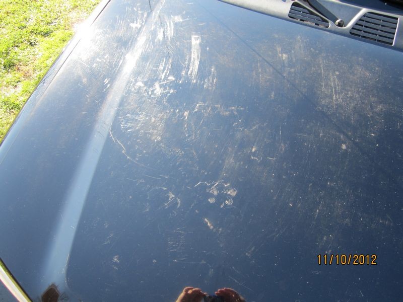

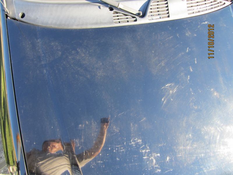

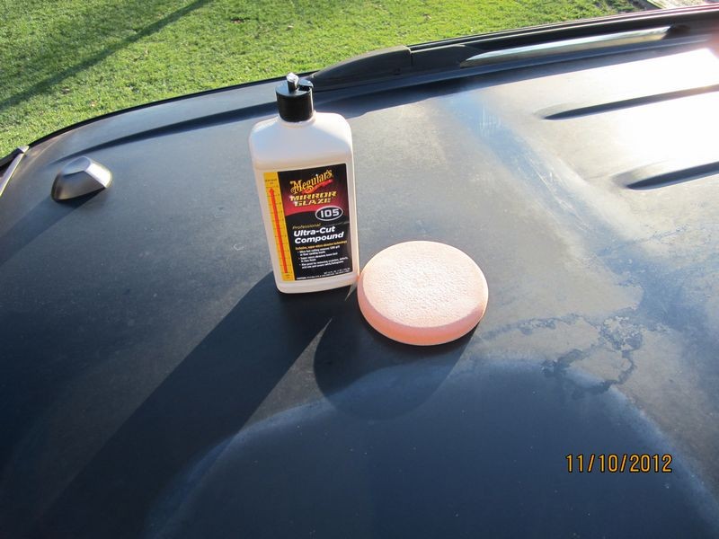

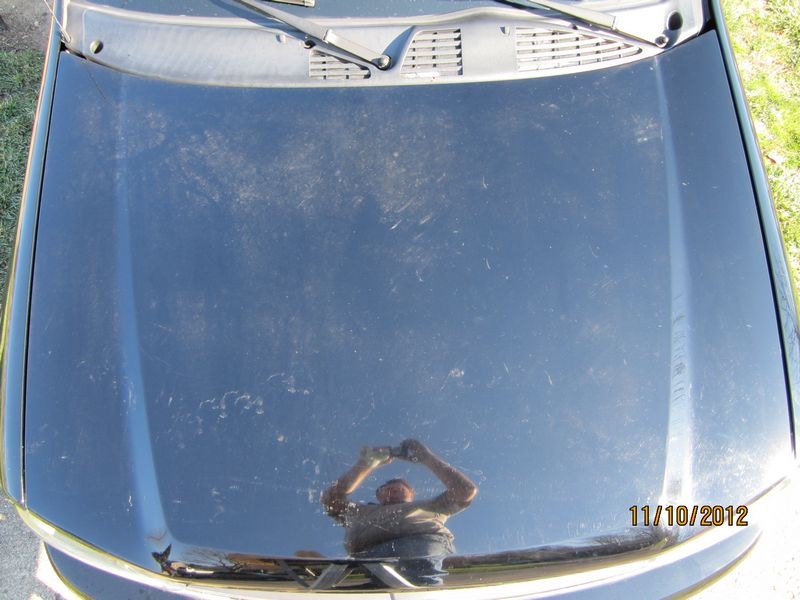

Car turned out really nice. Owner is beyond happy. I’m working my way up on performance. Several people on here have been really helpful.... thank you. First pic is with the passenger door and back not done and the front fender and hood done. Process is below... maybe it will help someone or your feedback will help me.
Before pics
wash/clean wheels & barrels
Foam car
brush/clean top
wash car/rinse
Clay mitt/rinse
blow dry...lol (electric Worx blower)
GG6 + 1 other DA
M101 compound - Yellow LC flat pad 5-6 passes
M205 polish - White LC flat pads 4 passes (2 medium pressure, last 2 light )
Wolfgang DGPS vertical and horizontal pass/wipe off
Touch up around decals with Wolfgang Uber Compound by hand
VRP dressing on tires... it's all about the applicator
Interior clean/then coat with 303 wipes, BUFF DRY
Luggage rack, windshield trim, door handles dressed with Solution Finish
Clean Windows
Final inspection/wipe down
After pics
I would substitute the 205 for HD polish. 205 left marring on paint, I have a red 93 Vette.
