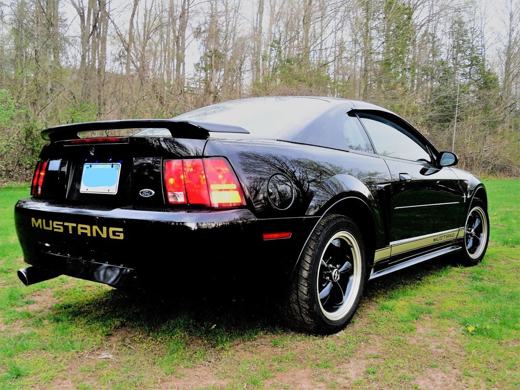

I bought a 2002 black Mustang that needed to remove built up crap on it and make it shine. You cannot get a good shine without removing contaminants. I bought a PC, Lake Country orange and light blue pads. Bought Wolfgang samples from here. The Swirl remover and Ultimate compound. I watched a guy on Youtube named Junk Yard dog and educated myself here with tips. The Wolfgang and Duragloss together look great. Duragloss is cheap and lasts long.
