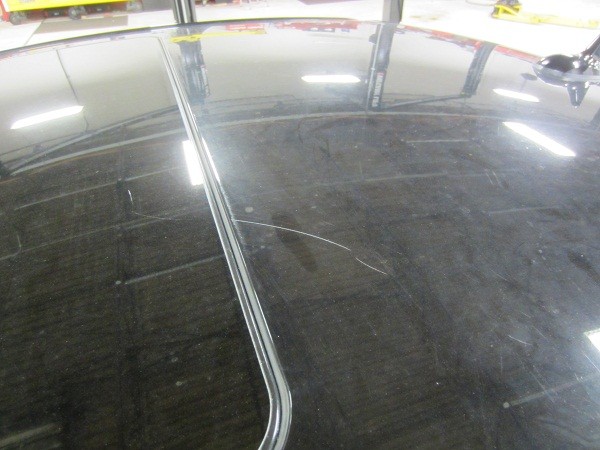

Yes I have PTG, the paintbis really thick 200-235 microns(7-9.5 mils). Everytime I did 4-6 passes, I wipe off and use PTG to check atleast 20 points. I noticed that I removed not much than usually, 1-2 micron at a time.
At first I use orange pad with menzerna 2400, sonax cut and finish 5-5. I did not remove any paint or just very little like 1 micron. So I went for little bit aggressive, so after 2 days, I only finished half of the Bentley.
I also checked the temp, never let it passed 60 degree celcius (140 F).
I found some deep scratches on the trunk, after 2 days I believed the paint really hard. So I tried to remove that scratch. I used PTG check it before, 232. I use sonax Cutmax, Orange hybrid cutting, tilted the pad a little to have more cutting power, 600rpm, moderate pressure, back and forward for 10 seconds. Check PTG again, only 1-2 micron off, wow!
In my country, no detailer have insurance because no insurance company sell it! We are on our own! Everytime something happens we pay. Thats why I extremely careful.

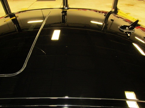

Based on the products and tools you are using Nd the amount of paint you are removing...I suspect the Culprit is that your arm speed is too fast to allow the products to work effectively.
I could be wrong
I was once before
Nice vid..seems like you know what you are doing and have the right tools. AGOatemywallet suggested slower arm speed, looked ok to me..maybe more passes. PE 14 with a wool pad and M400 is a defect killer and should remove any scratches you cannot feel with your finger nail. Because of the light color you could probably finish down with m400.
You have a lot of paint to work with, so maybe more passes will work. Good luck.

Seems that your either working on a car that has been resprayed (judging by the deep scratches on the attached pic - they look like sanding marks) or this car is a tri-coat paint job (base color, pearl and Ceramic clear coat) judging by the thickness. I worked on a Continental GT. Paint was not hard not soft. FG400 on a foam cutting pad worked out for most scratches. Paint readings were a bit weird, ranging from 85 to 145 microns - If I'm not wrong theses cars are painted by hand.
Not sure if Bentley uses Ceramic Clearcoat but it might seems to be this case.

You struggling as its a repaint, sometimes you cant push for close on perfection but rather an improvement and be done. Your work based on your video looks sound.
