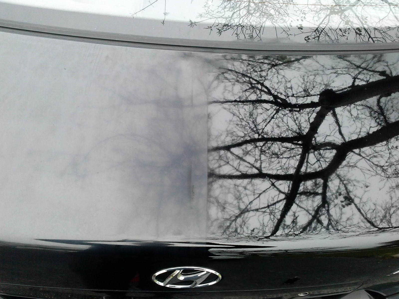

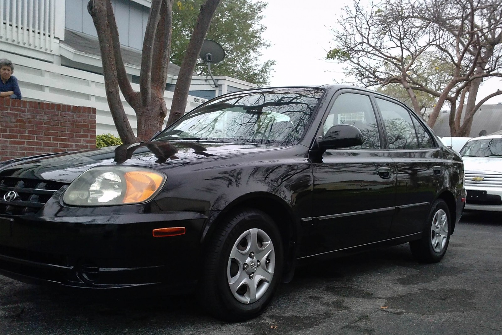

I give you an example of my relative's car I worked on recently. For me it was a nightmare to correct the paint due the number of scratches and chips all over the car. Owner wanted it to look better so that is all I can do. Here is the worst part which I did a 2500-grit wet sand to take off any edges prior to filling.
I was going to do a 2-step process so was not worried on buffing out the sanding marks. I only had time to do 2-layers over a two day period as it was either cold or the they needed to run errands.
After I was done it was 30% better and the owner was pleased with having a shiny car (thanks to Pinnacle liquid wax).
It looks fine and yes the dog scratches can still be seen, but at least they are not screaming!
