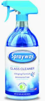

I’m currently using Sprayway and it does ok, but I’m wondering if there are any real game changers available these days. What’s your experience?

Sprayway and a waffle weave towel works well for me.....I like spray way foam because it clings to the glass and doesn't run...
That’s actually my current combo. I like the Chemical Guys Gray Matter Waffle Weaves. Best ones I’ve found for glass. 2 towel method. And I agree, it’s pretty nice how the foam clings to the glass and also it doesn’t over wet the glass.

Echoing what others have been saying. I use a 70/30 waffle weave and the reach tool, but I recently switched out Stoners with this non-aerosol version of Sprayway I found at Ace, it's a foaming spray and also works really well.

I also have the Sprayway foam glass cleaner and I can’t hardly use it. I always over saturate the glass.
