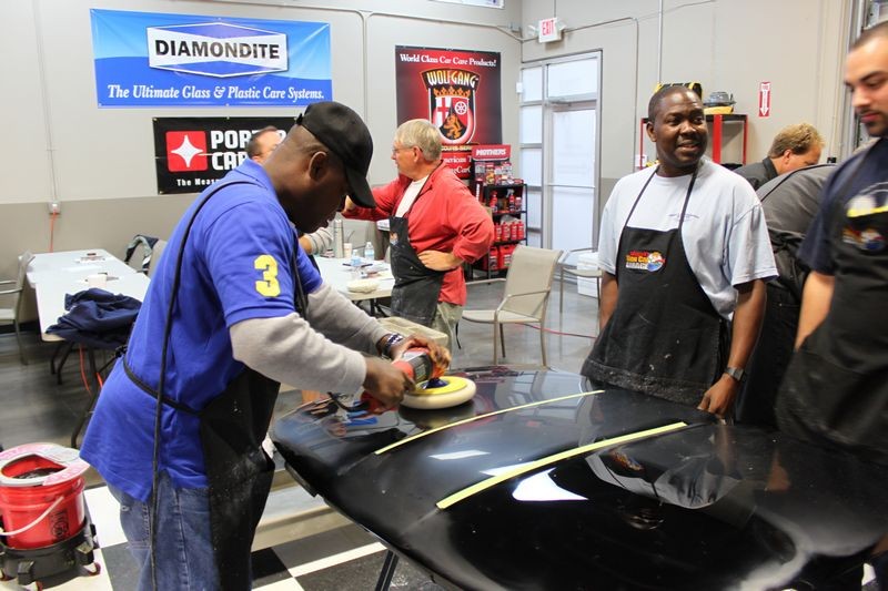

The best test panels
A painted car hood or trunk lid usually works well as a control but generally speaking, it's important that the painted panel be factory sprayed paint as this is what the majority of your readers will be working on.
Old School Solvent Evaporation Lacquer
Sometimes I will test on straight, solvent-evaporation single stage black lacquer because it's the best test for things like a dulling-effect, scratching and sub-surface staining.
I have a test panel that's actually a table with a sheet of plywood mounted to it and hinged, and on top of the plywood is glued a sheet of sheetmetal. The sheetmetal surface is divided equally into two parts, on half is a basecoat/clearcoat paint system and the other half is single stage, lacquer paint.
One time there was a product about to be introduced and I was told the product had the "Green Light" to go into production. I looked at the product and the first thing I thought of was to test it on the lacquer paint. I knew everyone else was testing the product on modern, clear coats and the results were good. I tested the product on both sides of my test table and sure enough, it scratched the heck out of the lacquer paint. I took on picture, filed a report and the new product was dead in the water never to be resurrected again.
The point being that while generally speaking modern clear coats are harder than old fashioned solvent-evaporation single stage paints, there are some modern clear coat formulas where the paint is actually very soft and you can scratch it just by looking at it the wrong way and when you bring out a new product you have to have assurance that the product will work on the widest spectrum of known paints.
KISS = Keep it Simple Simon
A basic test is to completely clean and strip a painted finish down to a "Fresh Base" this can be done by compounding the finish to absolutely remove any previously applied products and then chemically stripping the freshly compounded finish to remove any residues left by the compounding process. The resulting finish will be a virgin top coat to test on.
The next thing you would do is to use some painter's tape to tape off defined square areas for which to apply the products to be tested. You can test a single product but for comparison testing you would usually want to test at least two or more products side by side.
Flat is Best
The best test panel is a black clear coated surface like a car hood or trunk lid. The reason for this is because you don't want any curves to interfere visually with your inspection, so a flat surface is important.
Paint it black -The Rolling Stones
Black basecoat/clearcoat paint is the hands-down best color and type of paint to test on because black shows everything, in other words, the human eye is able to discern defects and changes in before and after best on black paint because it's the extreme on one end of the color spectrum. White would be the worst and of course, it's the other extreme on the color spectrum.
With all the above in mind, all the testing I have done has been on black basecoat/clearcoat paint systems, using flat panels that you can look down on with controls in place to make documenting visual differences as easy as possible.
