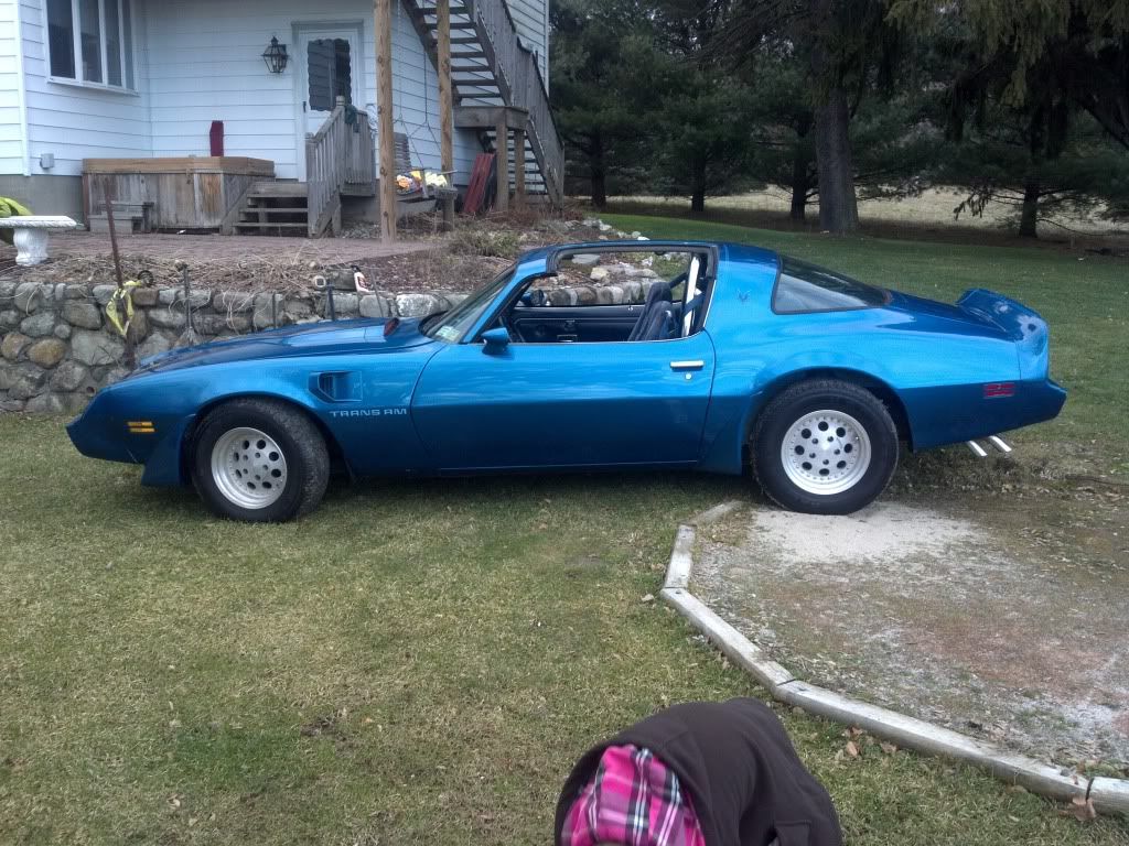

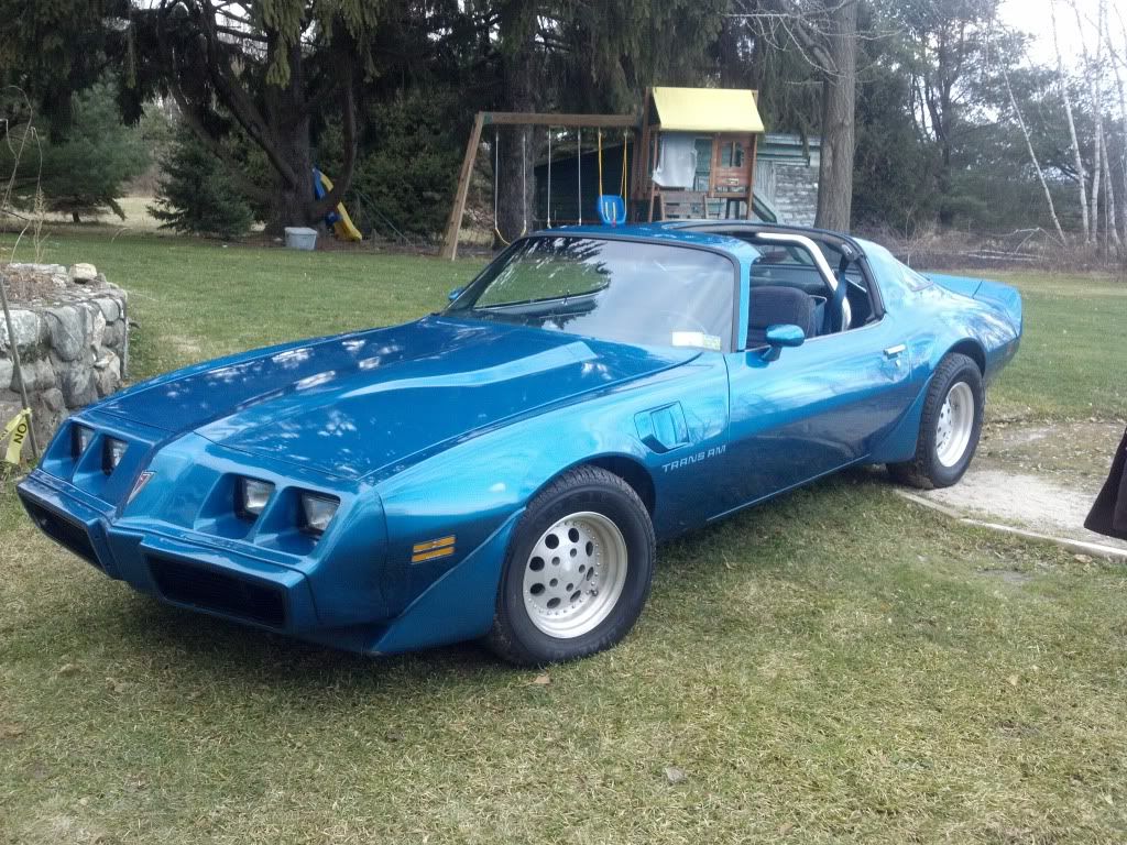

been working on the paint of a 79 trans am that been painted around 1994 using lacquer paint, the color is Kandy Brandywine shot over a Firemist red. Been claying it and did some detailing to it, this coming weekend would like to get more into the buffing and polishing this time. Just looking for what wax or sealant to use to finish off the job?

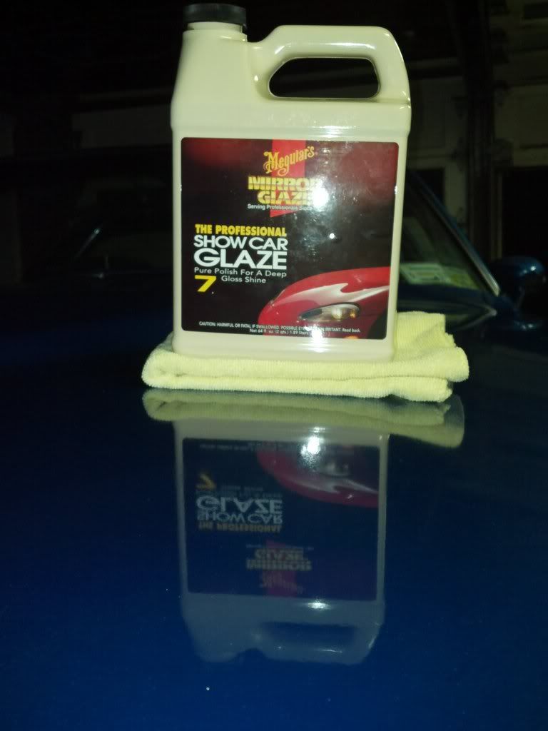

I'd definitely rub the paint down with some #7 after all the machine polishing steps are over and then top with whatever you decide...

thank you for all the help guys, today plan on just washing and claying , the issues i need to address first before i worry bout the wax is the water spots that formed from the air conditioner duct above it while it sat in garage for 13 yrs, it was covered up in a good car cover i guess just seeped through. also there are some fine and some deep scratch that i need to address also. I guess if i get her out today i take photos and post them up and start a detail log on it, the interior is perfect just the paint needs some TlC.
the photos in the link was tooken last yr, the day after it was uncovered from the pile of stuff that accumulated over the yrs.

I took the glaze off with my PC and bonnet then hand wipe down.. Its looking great!!!

Just about all finished, going to polish again (i plugged up all my pads)
