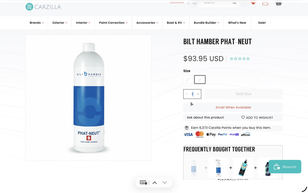

Maybe Carzilla just put the wrong image up as that should be the price for the 5 liter??? Or maybe they are simply price gouging??? Either way this just shows why things shouldn't be purchased from carzilla.
At this price it better clean my entire car without me lifting a finger.
That's the price for the 5L, the 1L is $24.95 which seems to me is right in the ballpark for other "premium" washes, and certainly less than some of the high-end ones.
Maybe I’m just used to wholesale pricing but this is twice as much as any other rinseless I use. I’m not opposed to paying more for a superior product but seeing a RW that cost more than a gallon of Reset is a bit shocking.
