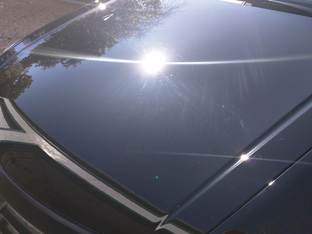

Not to insult you, but the outer ring from the sun looks like swirls in the first picture.
