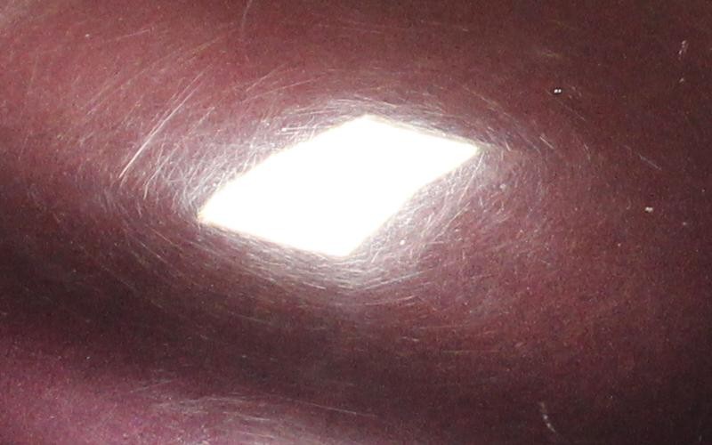

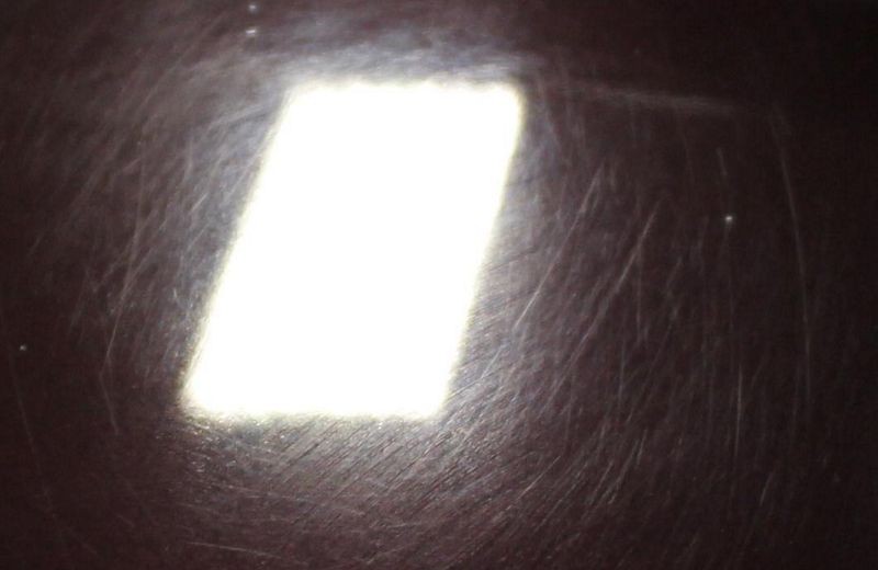

View attachment 74178View attachment 74179
