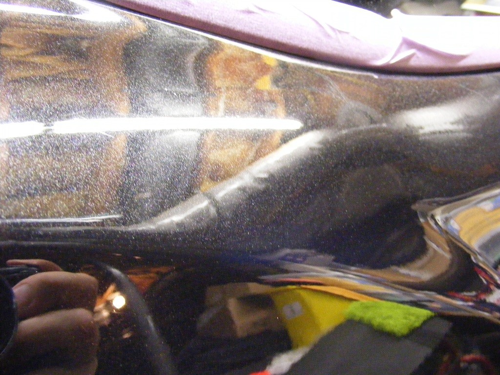

I had a pretty easy time correcting a newer lapis blue WRX last weekend. Played really nicely with my G21 and a yellow pad. I ended up using Essence because I was coating it with CQ afterwards, but I did give Hyper Polish a shot and it worked very well.
Bonus pic:
