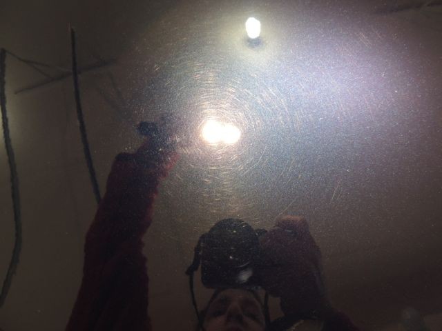

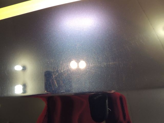

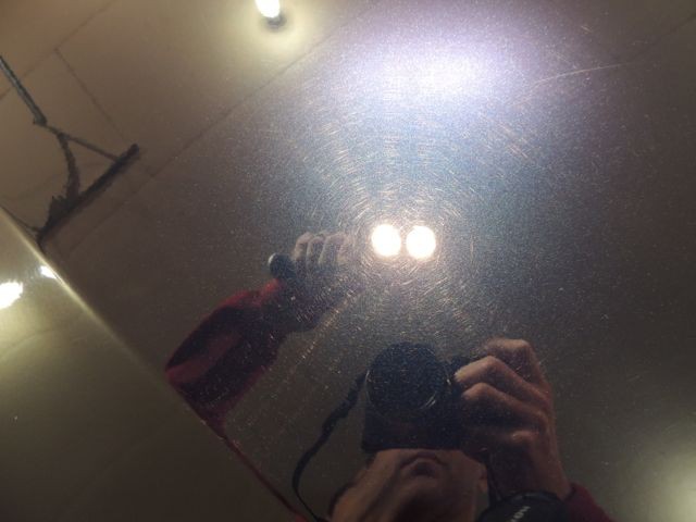

I detailed the client's e92 M3 for him a couple of days ago and just to give you an example of how ANAL he is about his cars, here are 3 pics of the M3
Feed back please
