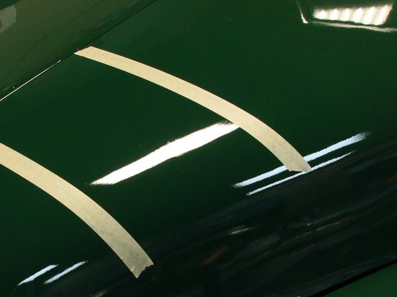

A buddy of mine paid $2,000 for this paint and hack job. Worst paint and buff I've ever seen. The entire car looked like this.
