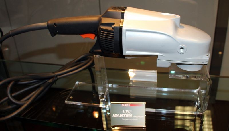

Here’s the polisher I used for everything in this thread and all of my polishing until not that very long ago. It’s a beast that I bought in the 1970s and it still functions perfectly today, after a few brush changes, gear lubes, and a new power cord, although its usage has been relegated to some more crude grinding tasks, not polishing.
This beast has torque to die for. It’s a single speed, 12+ pound monster. Its RPM… I’m not even sure but it is extremely high by today’s standards. I’d guess in the 2500-3000 range. I remember rapidly triggering the switch to control the speed for “delicate” situations. That was my variable speed feature.
Soft starts… no such thing. Although I don’t necessarily see that as a bad thing. I sometimes wish my current polishers didn’t have that soft-start feature. Triggering the switch is a useful characteristic for a polisher that can't be done effectively with soft-start machines.
I don’t remember exactly what it cost back then but it was a major investment. Contrasting to today’s polishers it was way more expensive in 1970 dollars than today’s polishers. I want to say something like $150-$200 in 1970 dollars.

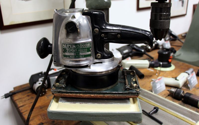

I'd like to have that here at the Geek for a picture together with an old GEM polisher I have access to and a Cyclo.
Why?
Because it was these early tools that made-up our tool choices for most of our car world history.
