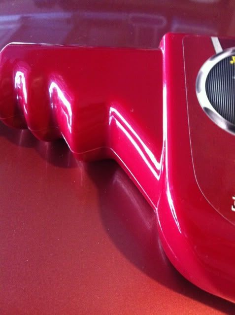

These are the products I have. I may not use ALL of them, but thats what ive got.
Originally the paint was very close to the same color as this bottle. This is a picture of an untouched portion of the car, just washed and clayed, thats it.

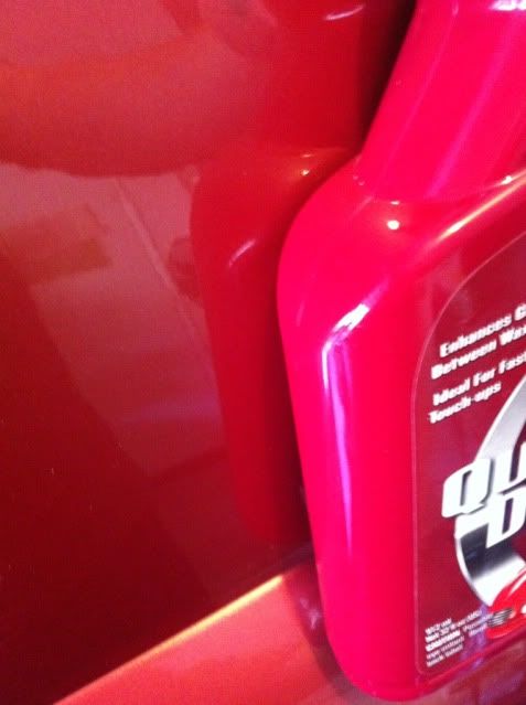

This is a picture of a portion of the car thats been hit with M#105 twice. It looks A LOT better, but there's still a long way to go…
Overall, Im happy.
