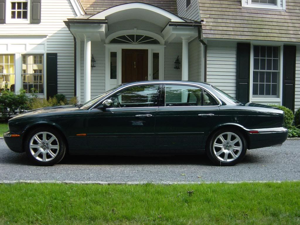

I had the pleasure to work on a 2005 Jaguar XJ Vandenplas today. It was absolutely hammered, having some of the worst contamination and swirling I have ever seen. It gets driven to the train station everyday where it sits for 10 hours a day or more.
So I brought it down to my house to get working. It was only supposed to be a wash and wax with an interior detail however I thought I would do something extra since they had me do 3 of their other cars. I urged the owner that it really needs some legitimate paint correction but that will be another time I think.

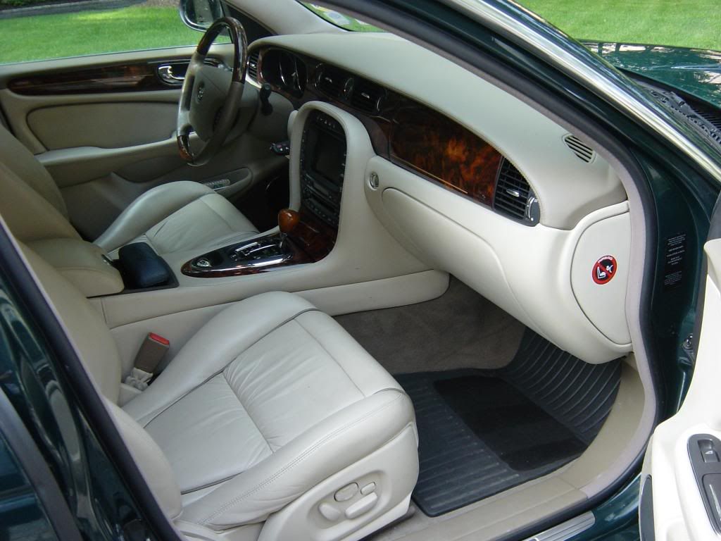

-Woolite+water on the interior
-Gl0ss it gloss enhancer on the windows, dash, and wood

Paint Correction: I can never seem to fully capture the extent of the swirls, but trust me it was abit worse than the pictures show.

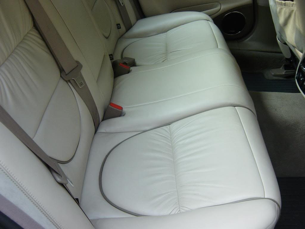

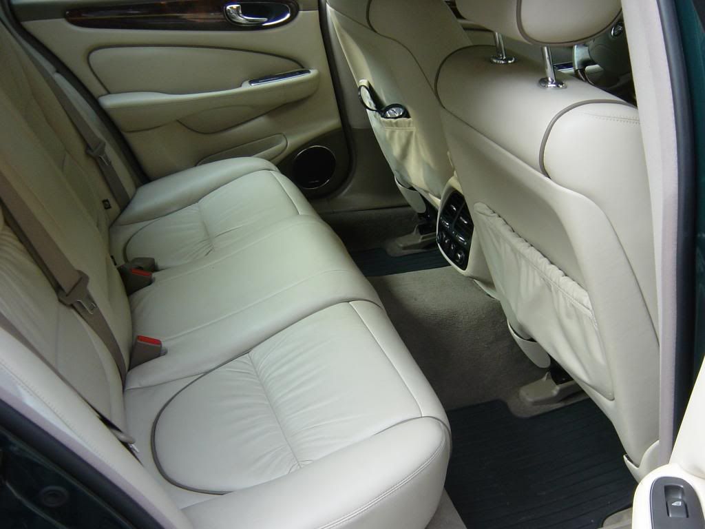

Wow very nice. That interior really was a turn around.
I was SHOCKED when I saw the interior after pics, I was like, "wow, it looks better than new"
Great work! Interior looks fantastic!

The interior was nasty as well. I really didnt like the brown carpets in the car, as it looked dirty even though it was clean and made me feel like it let the car down a bit. But who cars, if there was space I would have no problem living in it. :)
