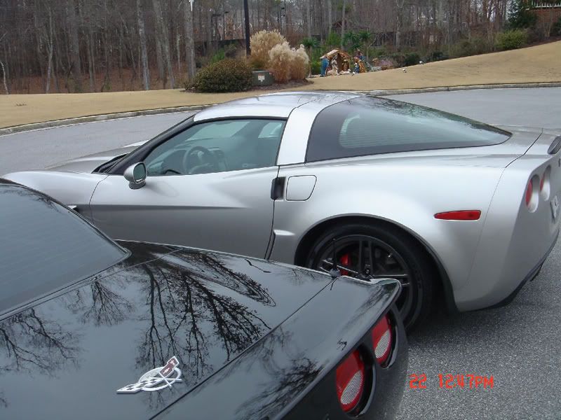

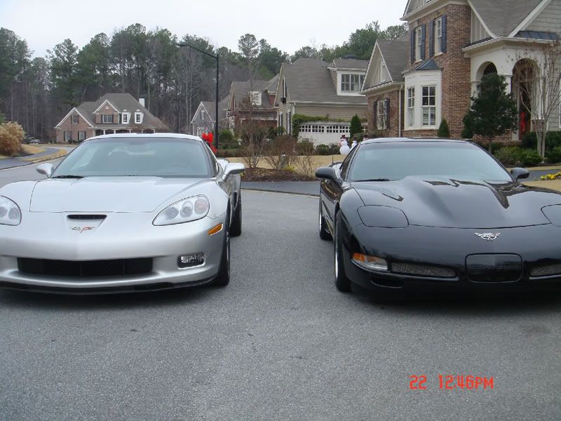

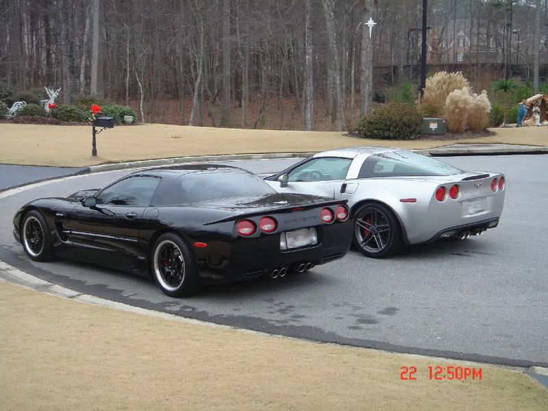

The first two are my pics I took the night in the garage. The owner took a few that weekend when it was not raining out.
These are the owners pics he took for me.
