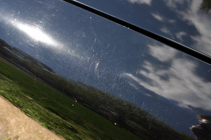

Here are a couple of before shots. This car has never been detailed or corrected, just the occasional clay and wax. It's 11 years old and the victim of many performance modification projects that require me to lean over and hang various objects on the fender. That has taken its toll pretty clearly:
The hood wasn't too bad, mostly just small rock chips, swirls, and water spot etching. Some of the etching was too deep to bother fixing on a daily so I hit it a few times and moved on.

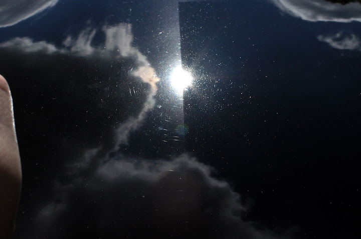

First round test spot:
You can see there's still a lot of dullness. The above was done with Optimum Compound II, an orange LC Flat Pad, and a GG on speed 5. I went over it a second time and followed with Polish II / White pad and had satisfactory results.

Anyway, some impressions from my first-ever attempt at paint correction with a real set of tools:
1. I'm using either too much product, too much pressure, in too much sun, or too high a speed with the GG + LC Flat Orange + Compound II.
Doing the hood twice with occasional cleanings by terry towel I ended up melting through the pad. In retrospect I should have:

2. If your (my) test spot doesn't show progress with the products I choose, step up to a more aggressive product (I just didn't have one)
3. Optimum Poli-Seal on a white pad follows Compound II VERY nicely.
I realized that Polish II isn't much more aggressive and I decided to skip it and was pleased with the results. I liked the way the Poli-Seal applied with a white pad and think this will be my go-to on easy projects like my MINI that has pretty flawless new paint.
