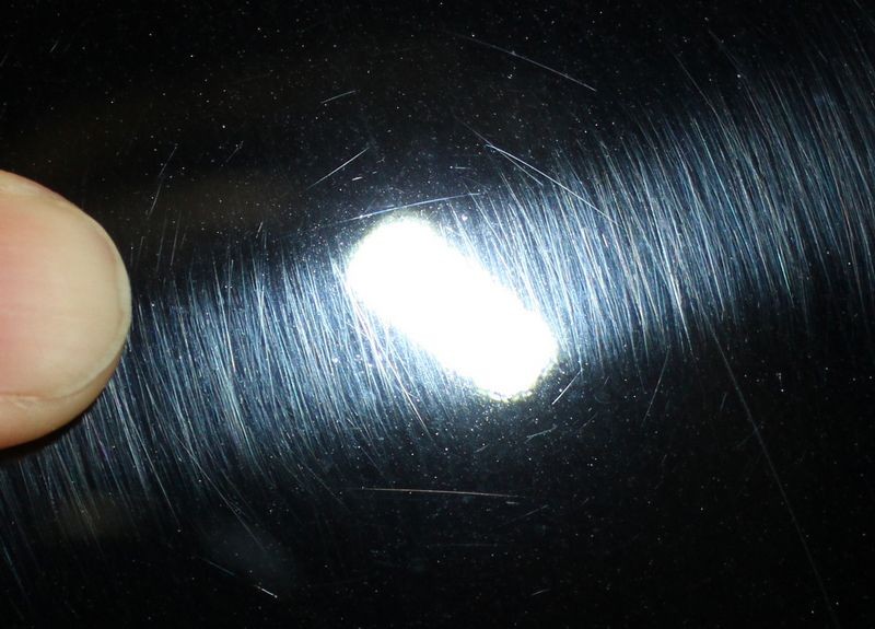

Here's what I would call a Medium+ to bad on Korean Paint:
BEFORE Meg's UC
AFTER Meg's UC (but not polished)

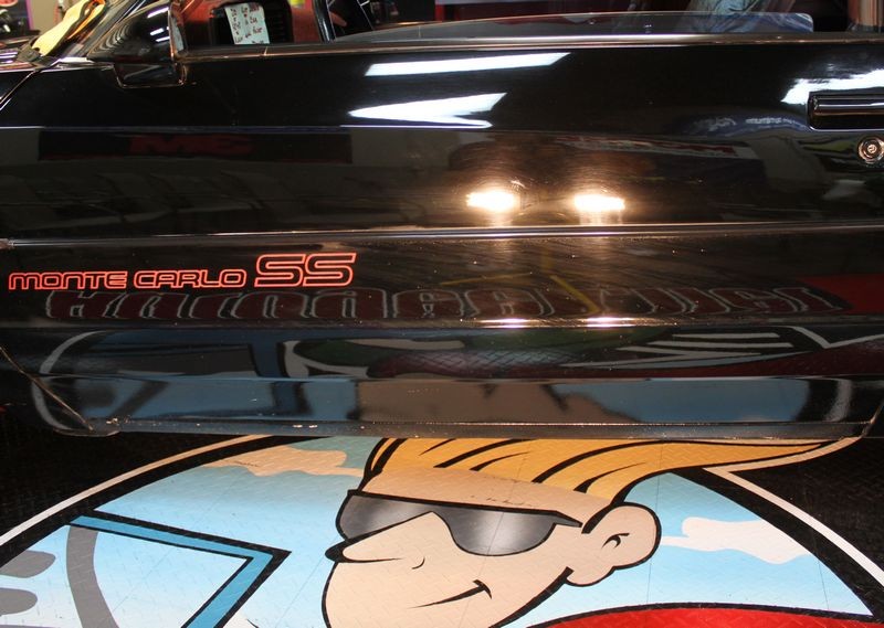

BEFORE HD Adapt on Japanese Paint: Same if not WORSE than the above:
AFTER HD Adapt and where I just went right to a sealant: Not the best before/after but you get the point.
