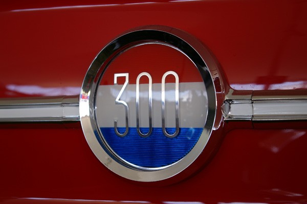

This is just an old 2-door Oldsmobile....
It's different than a normal wash in that ti removes iron contamination and in the case of the SONAX product, it removes a wide spectrum of pollution and contamination. It's not just focused on iron.
