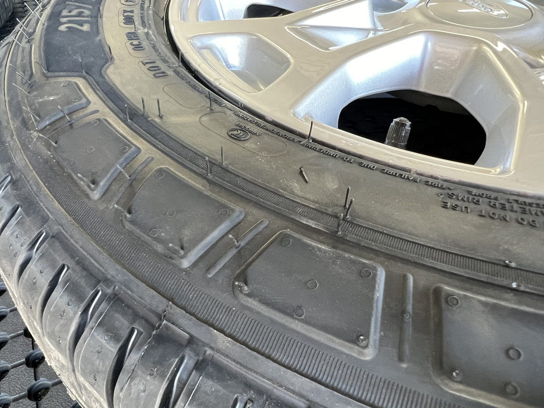

Denibbing looks like a blade scraper job, would I do that first before cleaning/stripping?
So if I wait a few weeks before first dressing, can I still go ahead and clean them now? Or wait until mold agents release before first cleaning.
If I can clean them now, I'll bring them home after mounting, and coat the barrels, and lay them down to clean/strip.
I wouldn't bother waiting, as mentioned tires are usually a couple of months old by the time you get them, and even then, I've had an extremely fresh set of tires that I did the above process straight away with no issues. I guess if they had come off the production line and you had them the next day, you'd probably wait a bit.
You can do it before or after deep cleaning, but definitely before applying a dressing as they become far too slippery.
I pull a little tension on the nib and then touch it with a razor blade. Fingernail clippers or a set of pliers works too, but I find the razor blade does the job better.
Of course, we are talking about a completely pointless endeavor here, but trust me, once you see it done, you'll never go back.
So as mentioned in my other thread about wheel weights, I'm having the rubber mounted on the rims and balanced, bring them home, then finish coating the barrels, clean/strip the rubber, have the tires then installed on the car, then first dressing.
Denibbing is more than I want to do, however, I'll maybe give it a try with needle nose and exacto knife.
