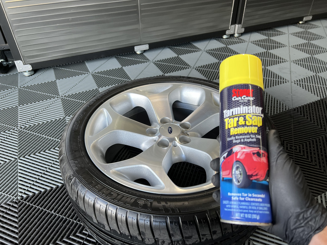

Correct, spray Tarminator onto a towel then start wiping, this is more than sufficient. It's actually really interesting to see it in action. Because this product is a solvent, it cuts through build up almost instantly, but the citrus oil in it seems to prevent drying the rubber out and create a sound base for a dressing. Personally, I have not witnessed Tarminator causing blooming after treatment.
I always point out that using Tarminator on tires is an occasional thing, not to be used for weekly cleaning. That doesn't mean its unsafe, rather you shouldn't need that sort of cleaning on a regular basis. I use it to prep brand new tires or deal with tires that are being resistant to traditional cleaning methods. For tires cleaned regularly, you may never need to use Tarminator. On the other hand, I have a set of Michelin PS3's that WILL NOT let go of tire dressing, no matter what tire cleaner I use (Brake Buster, Wise Guy, Adam's Rubber Cleaner, Turtle Wax Hyper Foam, Adam's Wheel & Tire Cleaner, Carpro ReTyre, Gyeon Tire Cleaner, none are effective) or how many passes I undertake. And that's from using water-based dressings exclusively.
In fact, I needed to use Tarminator on those PS3's today. After cleaning with ReTyre (no blooming or browning at all) and then dried, you can see the dressing remains..............
After a pass with Tarminator and back to matte/bare rubber -
A video of it in action -

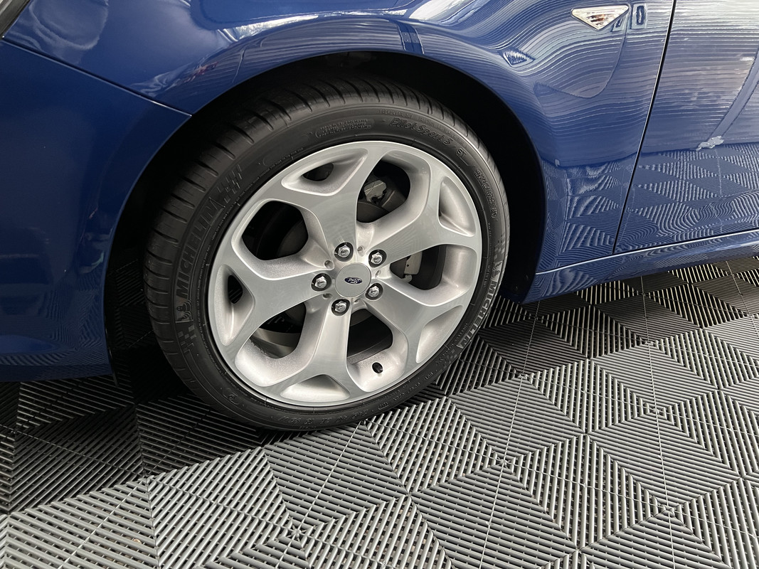

Dealing with the Same exact problem at the moment. I believe I caused it by being lazy 1 day and instead of cleaning the tires like I usually do, I just sprayed more Hyper Dressing on top of the layer it already had, I don’t even think I rinsed the tires. 1 thing I know for sure is I sprayed it on and didn’t use my brush to apply because I didn’t want to get my brush dirty. So about a week later I noticed the tires turned info a sticky mess, not necessarily visually because they still look ok, but when spraying tire cleaner on them and trying to brush them clean it’s like trying to clean off molasses. It just goops up my tire brush and turns it black.
So last night I decided to try a few things including Tarminator to finally get to the bottom of this mess and get these tires clean once again.
This is what they looked like. As you can see, visually they look ok. Looks can be deceiving.
Here’s the front tire which I used Megs D143 @1.2 to clean.
Here’s the rear tire.
I quickly became exhausted trying to clean the front tire with D143. It simply wasn’t cutting it. I did 3 maybe 4 attempts at it going 2x each time using 2 different brushes and spraying twice each time before rinsing and it was still turning the brush black. It almost got them fully clean at the end of the 4th time, but I ran out of patience and moved onto the next tire.
On the rear tire I used LA’s Totally Awesome straight undiluted and wow what a difference it made. This is way better at cleaning tires. It actually got all the gunk off fully clean after 2 or 3 cleanings [it’s hard to remember since I was hitting it twice with 2 different brushes each time]
But it got it clean.
Now here’s where it gets a bit interesting.
This is the same tire I cleaned with LA’s Awesome. But on the right half I had just finished spraying/wiping clean with Tarminator. Visually no difference. [with the exception of the innermost part of the tire being bone dry/clean]
But it did pull off all this grime onto the towel. I find it interesting to see all this gunk yet hard to tell any difference to how the tire looks and feels.
So I decided to try a different method on the next tire. I figured to see if I could cut to the chase and save time & energy + save from ruining a towel and simply spray Tarminator onto a fully dirty sticky tire and rinse it off with the jet nozzle.
I was working in the dark and trying to not spray on the wheel, but it worked for the most part.
After taking those pics, I sprayed the entire tire with Tarminator and rinsed, followed by a quick scrubbing with LA’s Totally Awesome and the tire was completely clean. Great stuff.
