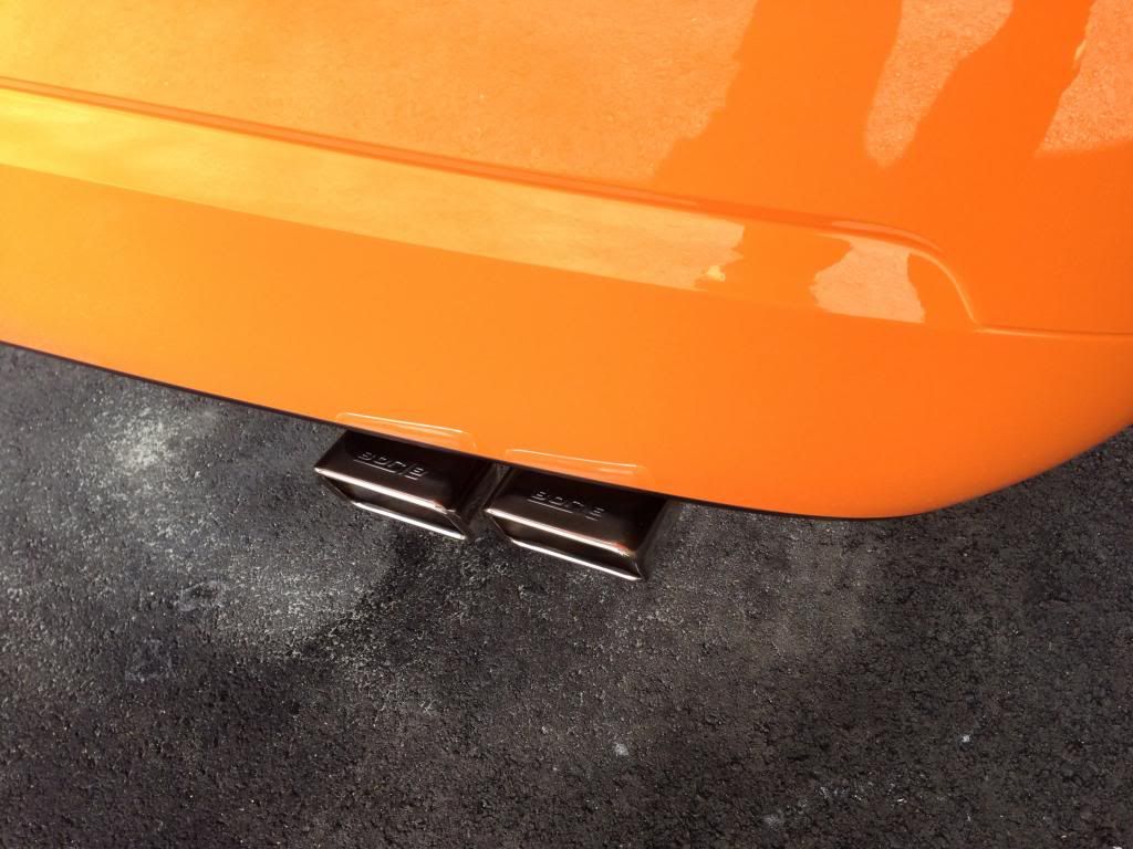

Not the best picture but these were done with mothers mag & aluminum polish. Was able to remove the built up soot inside with little effort.
I also used mothers mag and aluminum polish with 0000 steel wool and got the tips on my FX clean and bright. Removed the carbon on the rolled edge quite easily.
