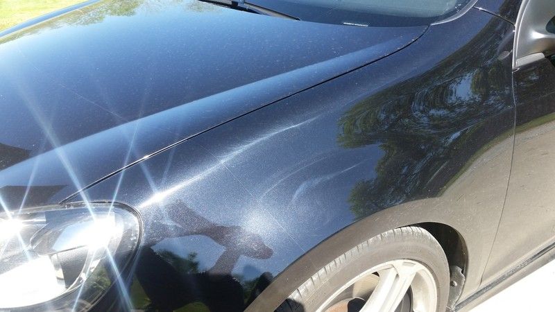

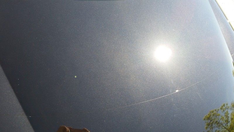

As Bob said you can polish it, I didn't know the manufacture on this job so I went super super easy with Menz 4000 and a white hybrid. Is it perfect, NO, is it 210000x better? Yes!
