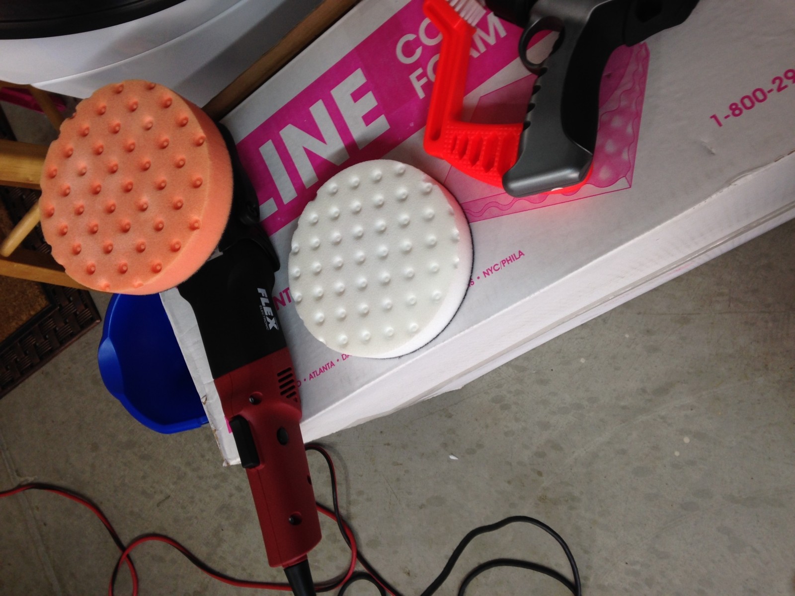

Mine looked like this too, I too suspected that the factory coating had begun to fail. I used this 3M kit to restore the lenses and they came out great.
I just followed the instructions in the box, and the video on their website. I just chose to use the CarPro DLux coating I had around instead of the provided 3M sealant in hopes of some more durability. It's been about 9 months and they're still holding up great.
