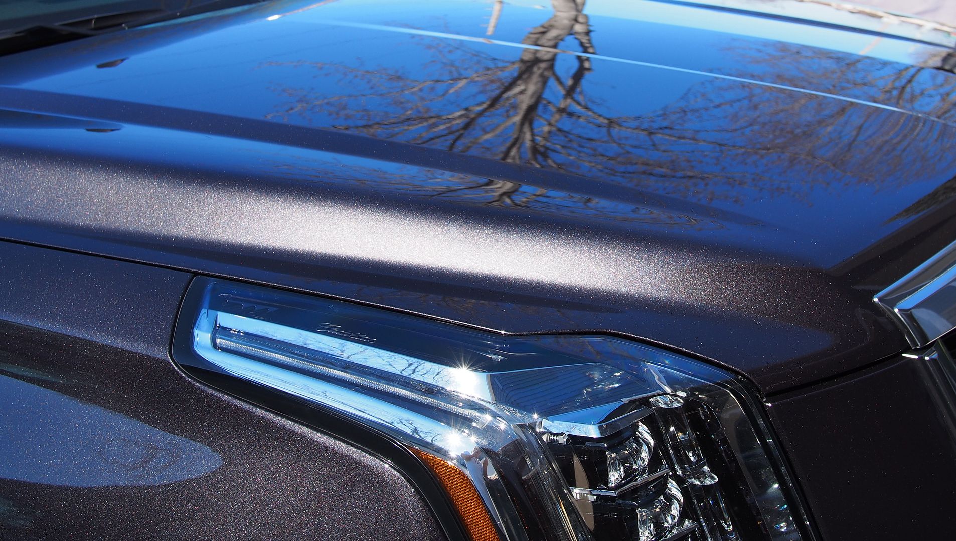

About a month ago I did my brothers Escalade which isn't black but a dark grey with CSL&EXO and thought it did a good job on his dark color.
