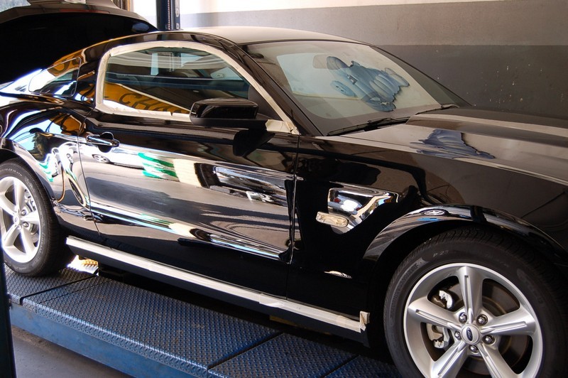

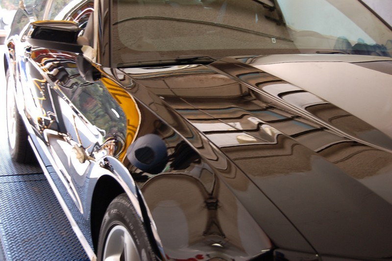

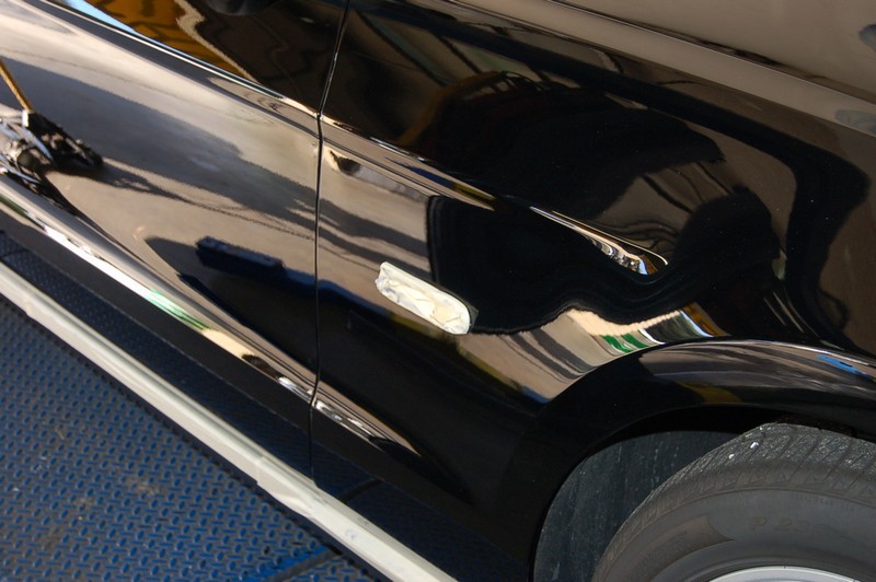

@Stegs, yes I will be sure to take some before/after pics.... The stang is Torch Red convert... which I've already done cut/buff & then a month later HD Speed to get some newer swirls out.
Should look pretty darn awesome when I'm done
Used DA 7424 with 915.... Came out good.
I use xmt to prep the LC blue.... Came off ok, but must do small sections. Speed at 3..
Then I tried by hand. I like applying this by hand much better. It went on easier, moreover came off easy. I think because the heat from the DA made it dry a little quicker than by hand.
Seems like I got deeper gloss by hand.
View attachment 35222View attachment 35223View attachment 35224
