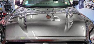

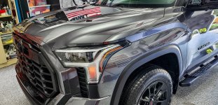

Two of my friends both fellow shooters too, purchased simliar trucks in the same week. Crazy how Grey is so popular too! Note the first few pics are of the Platinum Trim one and the other is a TRD Pro
Both came to me as NEW Vehicles in need of full ceramic protection as they will both be used in hunting and as real trucks pulling boats and actually being used as intended..
Both are now GYEONIZED with Mohs EVO.
The process remains consistent:
  • IK12 Foam Canon loaded with cheap soap
  • Chemical Decon Iron Remover
  • Clay Mitt
  • Polish with Flex 3401 and Green L.C. Flat-Pads and in a couple of cases Rupes Yellow Beveled edge pads
  • GYEON PRIMER Polish
  • Custom Wipe Down with Acetone and Windex Mix
  • GYEON MOHS EVO Coating
  • Megs Hyperdressing on tires
  • SONAX Wheel and Rim Shield
  • NeverWet for Glass on windscreen
  • Rain X on the remainder of windows
