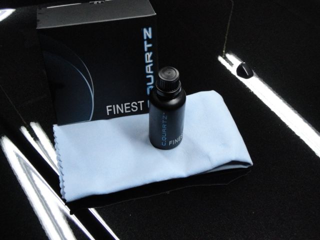

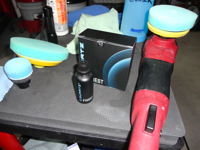

I received my Finest a couple days ago and thought I would get the hang of the application process because I have a Pontiac G8 next weekend for correction and application of the product.
I purchased the Finest from CarPro USA (Thank You Corey).
I was going to apply it to my TransAm but thought I would use my 300C SRT Design because both vehicles are black but the SRT has flake in it.
My paint was in good condition but used a finishing polish and a green pad(s)then polished off half the vehicle of the OG that was applied prior.
I used Eraser to do a final wipe to ensure there was no oil's left on the paint before application.

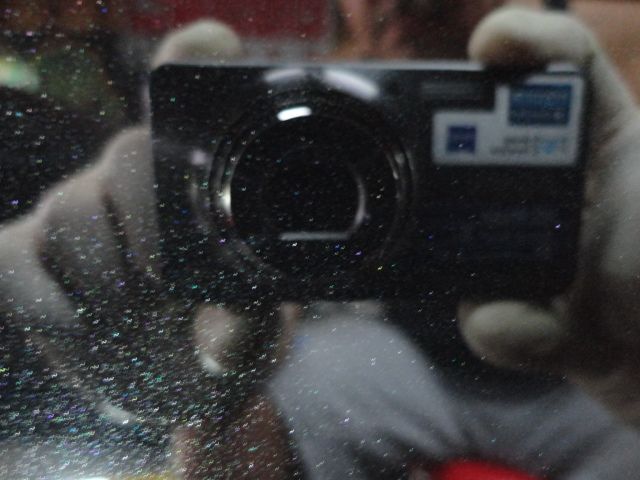

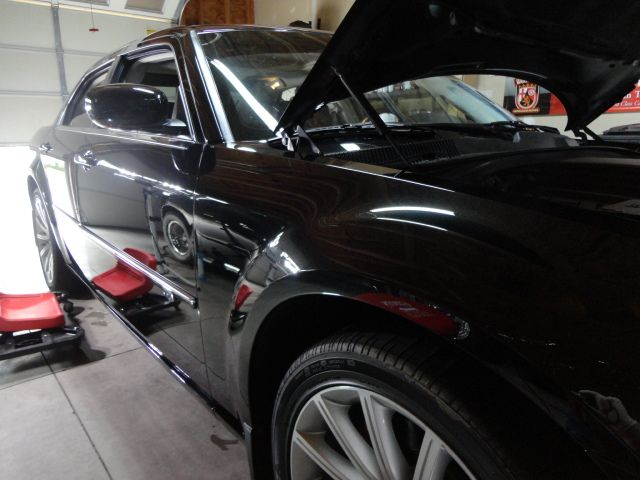

One thing I did notice when applying the Finest is the product leaves very little haze and almost seems to melt into the paint.It was 78deg and 57% humidity in my shop so after applying,I very lightly wiped off what little haze was left after about 5min of cure time.

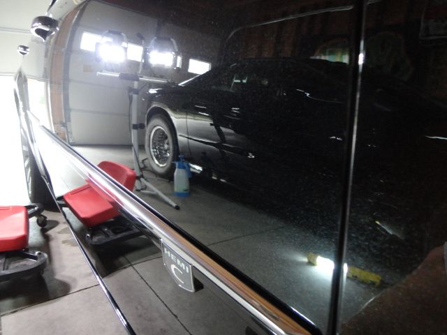

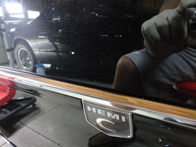

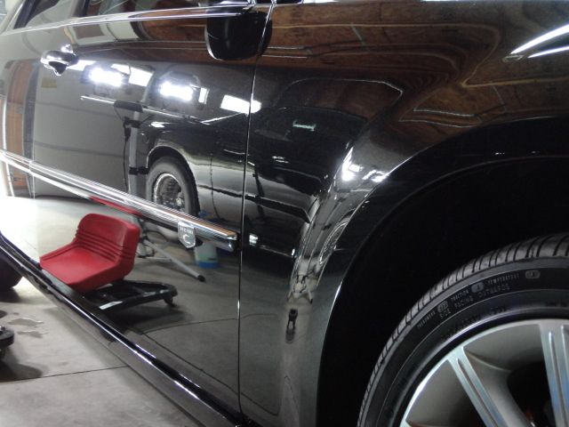

Another thing I noticed is after final buff,the paint felt soooo smooth.I meen SMOOTH.
Oh yeah,did I mention yet the finish after application looked like glass ;)
Excellent reflections:
I will monitor durability,sheeting/cleaning properties,and also scratch/swirl resistance against the other half of the vehicles OG.

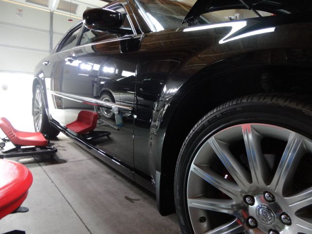

But I must say,I'm VERY impressed with the product (initially)! A quick hood shot to showcase the Finest:

In the first picture do I see a 2 inch pad or something? Looks tiny.

Well I did a quick rinse down today to check the shedding capabilities and I have to honestly say that water scatters from the CQF side better/faster than the OG side.....I was shocked!
The CQF side does seem a bit glossy than the OG side as well,could just be mind games on the gloss but not the water shedding.

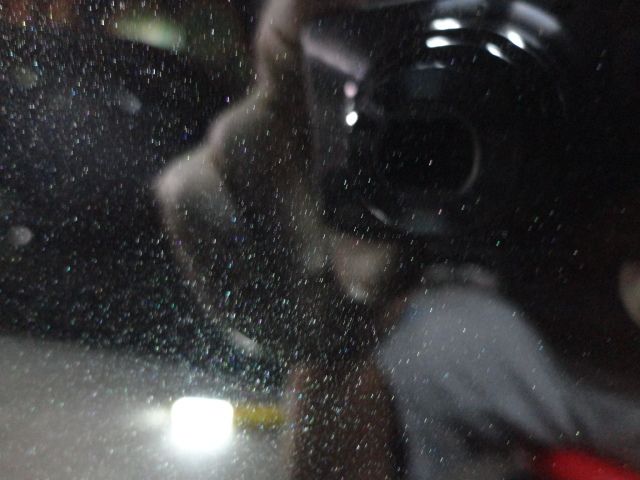

Thank you for your feed back Chris.I would of thought Power Finish and the Green polishing pad would of did something to the OG after several section passes,considering the OG is .00004"/.00008" thick?
When I sprayed the Eraser after polishing,I sprayed the panel with mineral free water (I use from my dehumidifier) it did not run from the paint like the normal OG water shedding characteristic's?
That being said,when I applied the CQF it behaved/hazed/cured as it should have (did my research and also talked&emailed to my CarPro-US rep).
But for all fairness I will do another panel(s)again but also do a strip wash with IronX Snow Foam or Citrus Wash after wiping down with Eraser and if I'm confident there is no more OG left,I'll recoat again with CQF.
